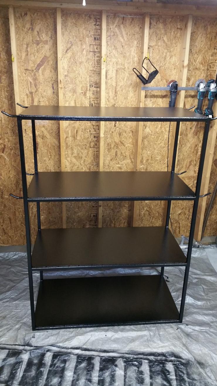

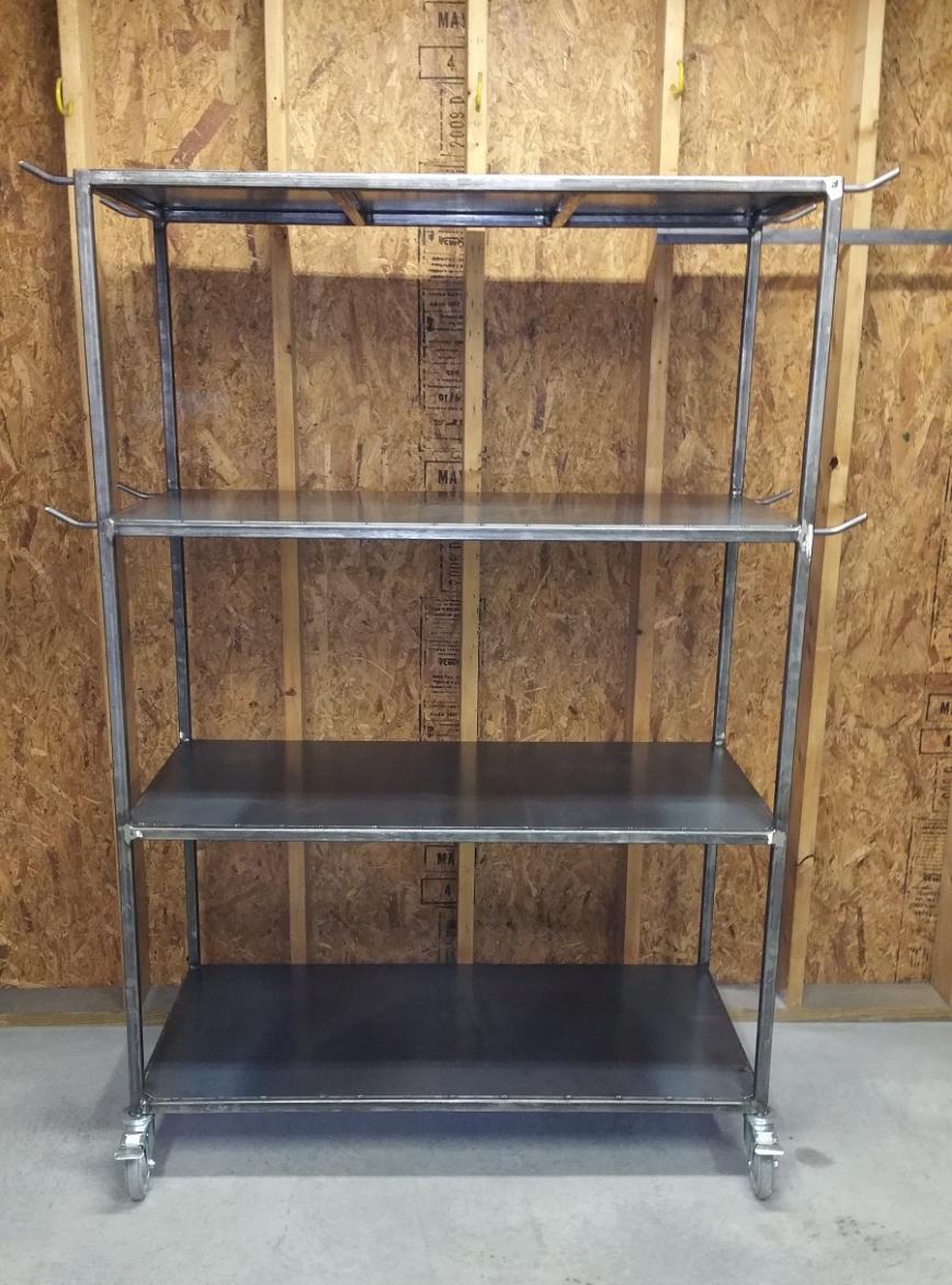

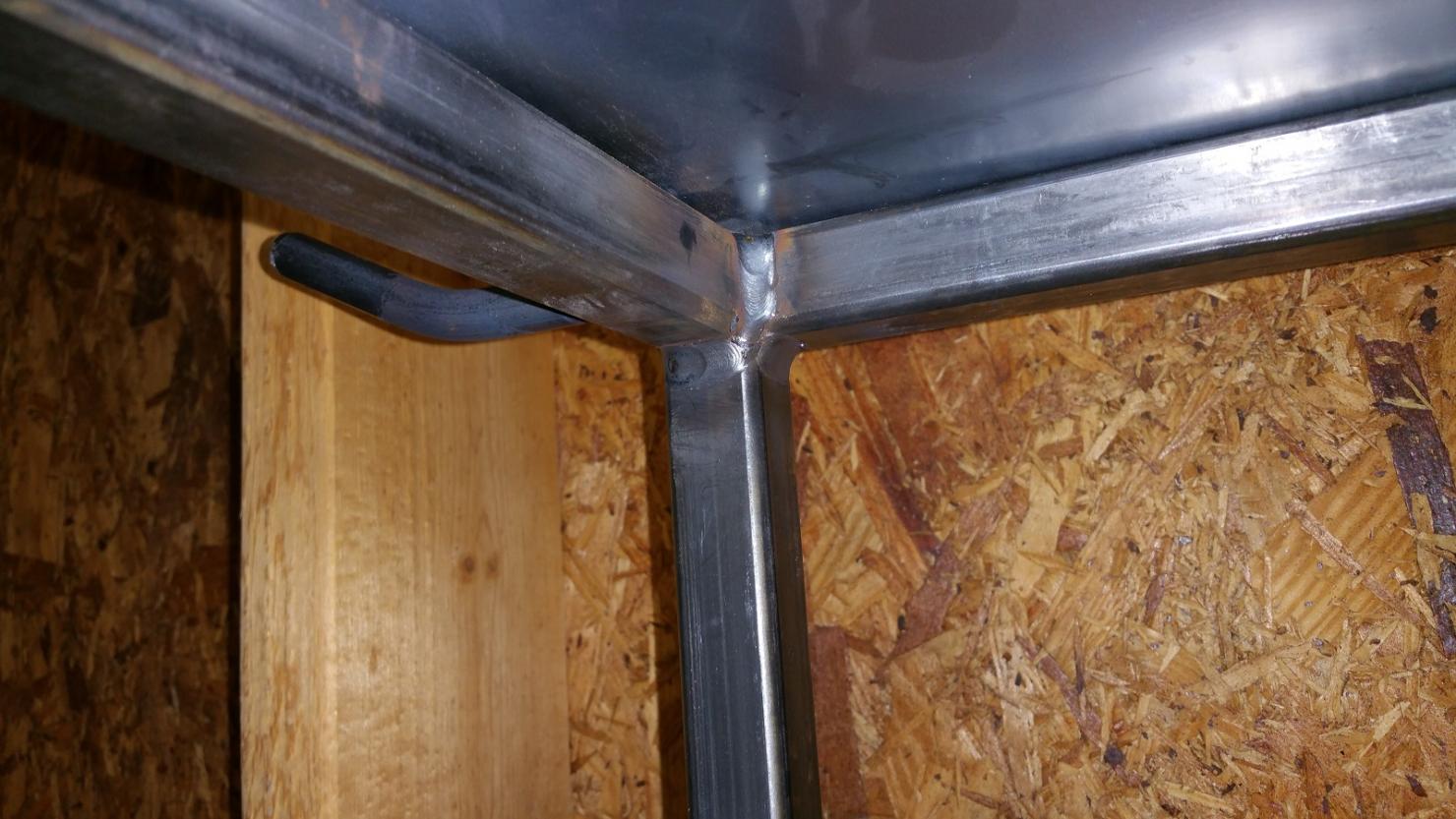

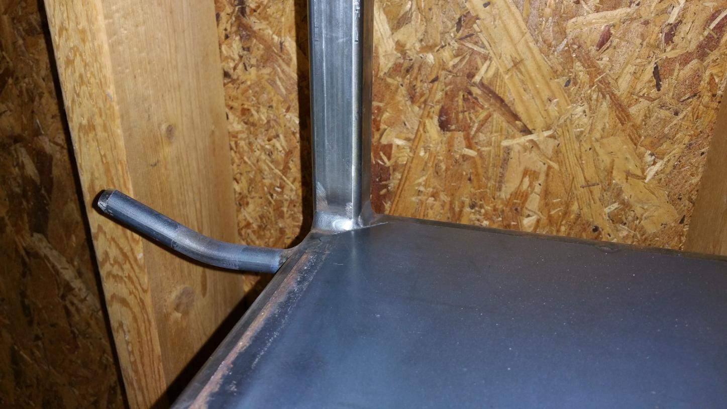

    I needed a set of shelves to keep the clutter off my tables and for extra storage. They are 6' tall 4' wide and 2' deep on 5" total lock stem casters.

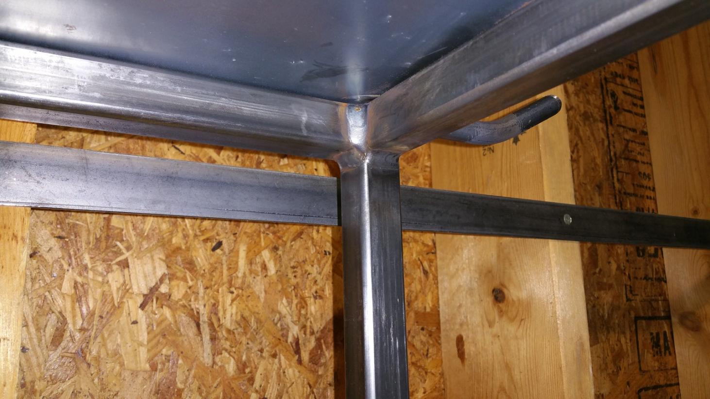

    The square tubing is 1"x1"x1/8" and 16ga sheet metal for the shelves. All 90' of tubing was cut precisely with my Evolution Rage 3 DB cold saw. The sheet metal was plasma cut.

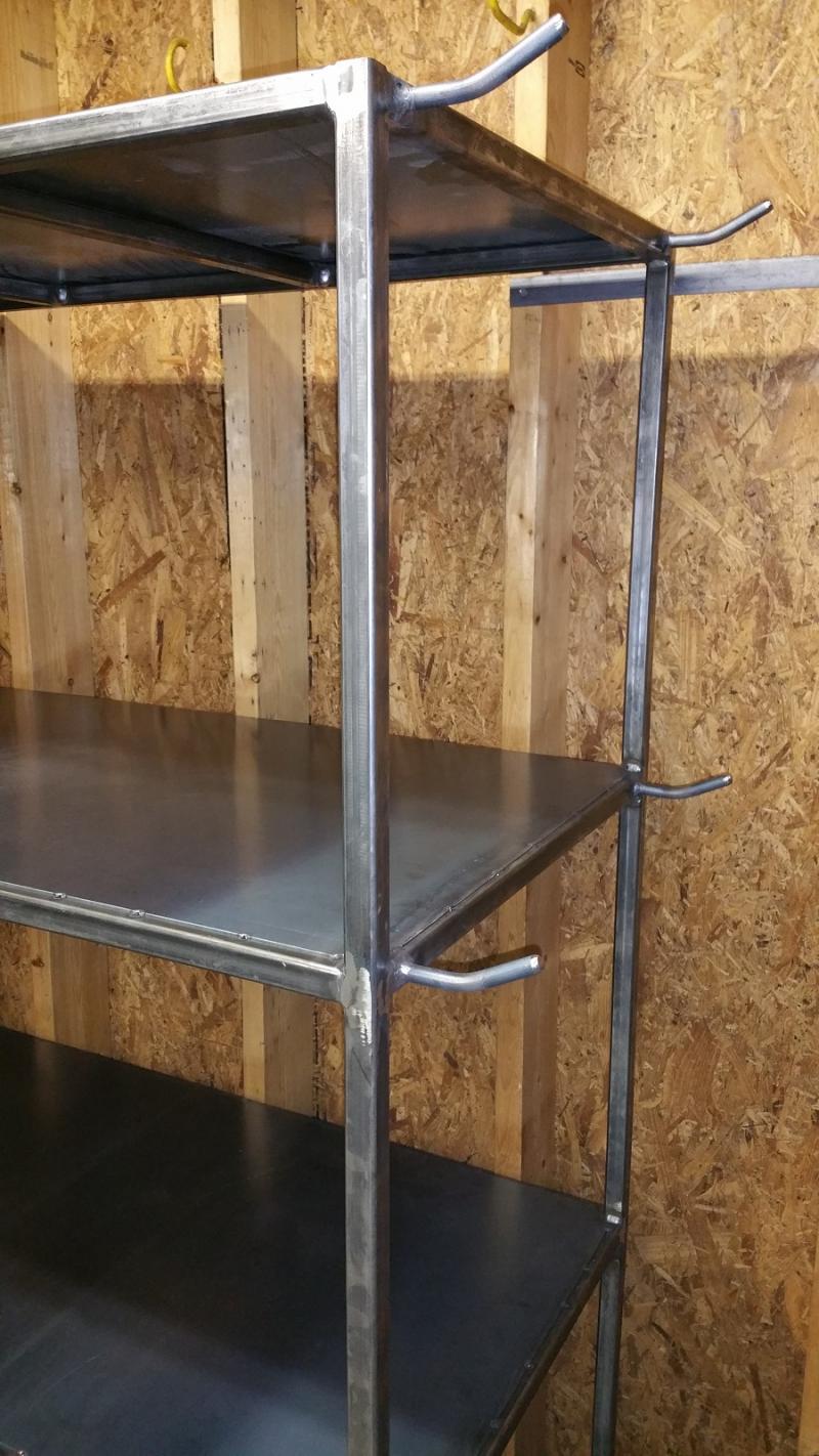

    I weld a 1/2"x13tpi nut inside the bottom of each upright for the caster to thread into. The 8 hangers on the sides are 1/2" round bar, all bent at the same time in my press brake.
    All joints welded spray arc with the 250p because it's almost silent and spatter free. The sheet metal was tacked every few inches with TIG and no filler.
    I'll give it a coat of Rustoleum 9100 black epoxy mastic sometime this week. Maximum weight capacity is 1200lbs.

    Looks nice. What was your gas blend for that?
    I made a quick coupling tee and mix my c25 with straight argon. I ran 4 lpm c25 and 8 lpm argon, .035 wire and a 1/2" nozzle, 24v but I don't know the wire speed. I lit up on a piece of scrap and turned it down until it sprayed right. I thought about making it a cabinet but decided to just keep it shelves.

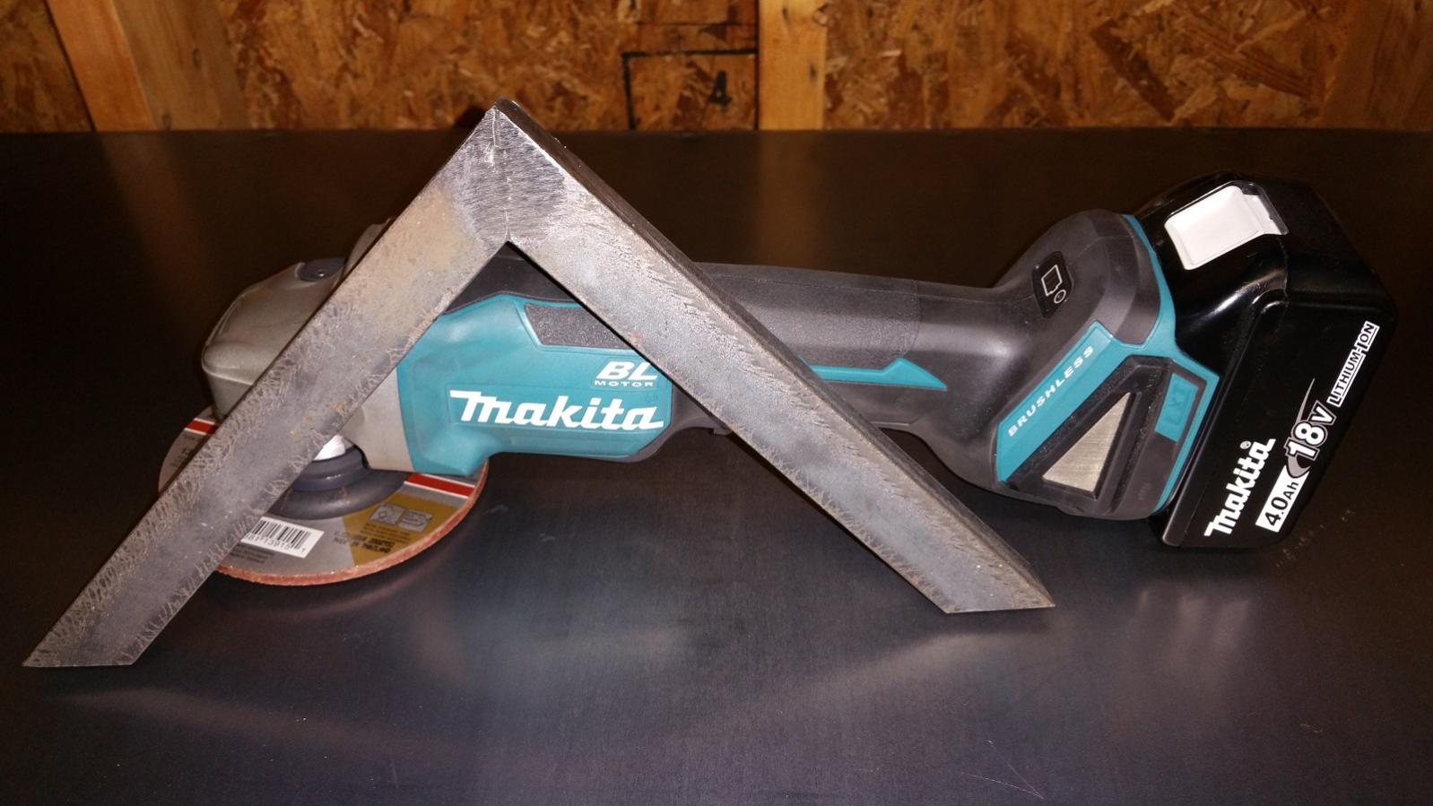

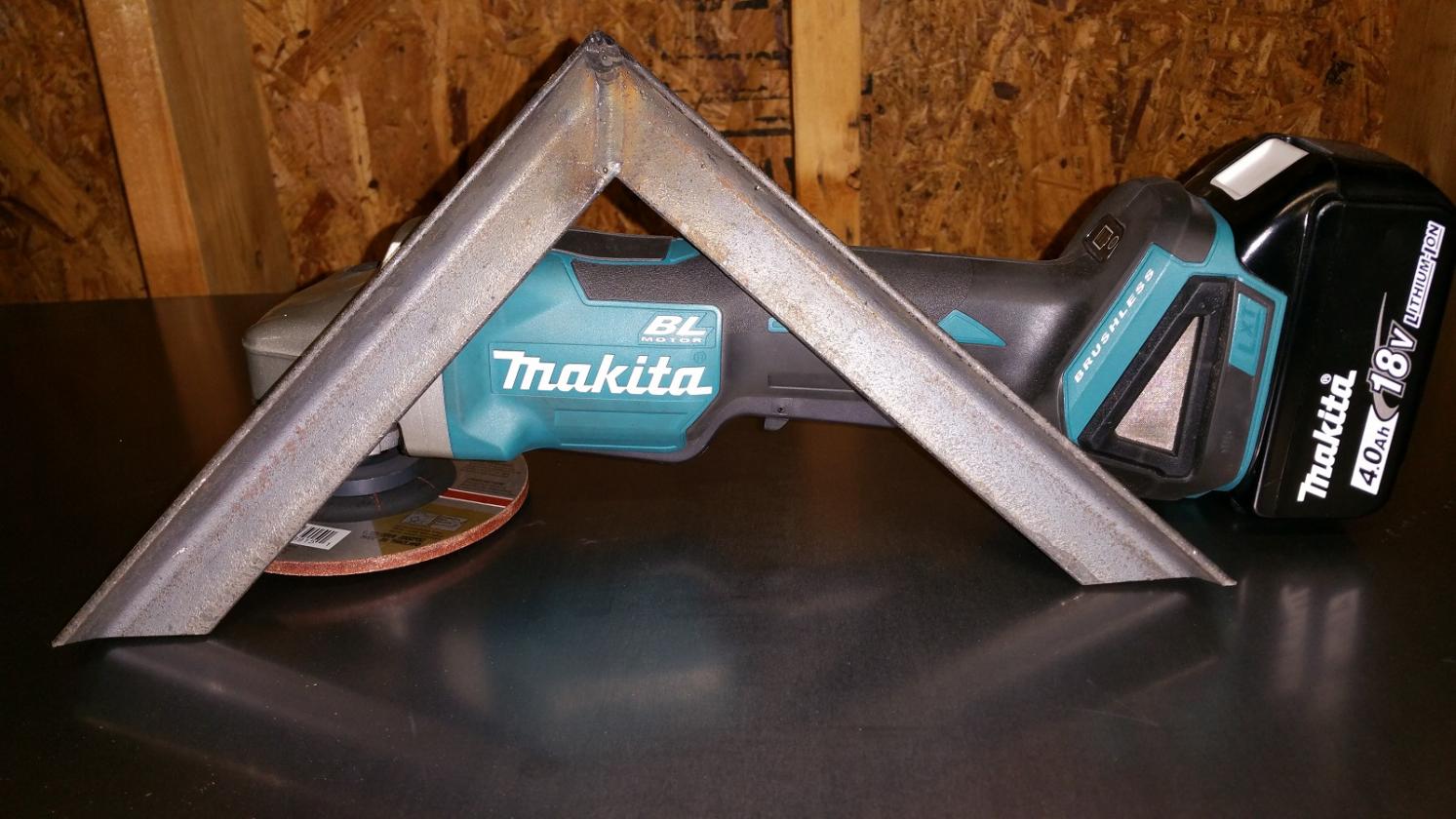

    Here's my way of building square frames like the rolling shelves I just made or anywhere you need 90 degree joints.
    I take short pieces of 1" angle, cut the ends 45 degrees, clamp them to the table at 90 degrees and weld them together. I like for each side to be at least 10" for plenty of clamping space.
    When you're ready to build a frame you just clamp them to your tube or angle and start welding. I fully weld the exposed sides of the joint without tacking, then remove the jig and weld the rest.
    The rolling shelves turned out dead square with all four casters screwed in fully.

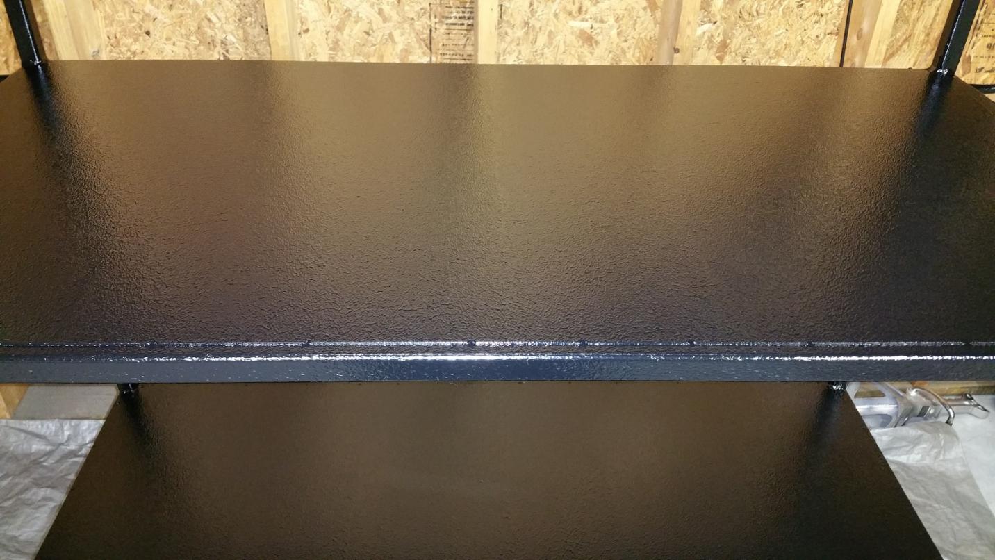

    I put a coat of rustoleum 9100 black epoxy mastic on this past weekend. It's hard to make this stuff go on smooth with a brush or roller but it's tough once it cures.

    What did you use to put it on. I like the hammered look. No skid/slip lol.
    A 3/8" nap roller. It feels pretty smooth to the touch. I tried a paint brush but it left lines that don't go away. In other words it's not self leveling. It does give about four hours pot time with the standard activator at 70 degrees. They have a fast cure activator that cuts that time in half. Lowest price I could find was from zoro.com at about $66 each for a gallon of color and a gallon of activator. It comes in many colors, can go directly over rust and makes a very tough finish like powder coating.
    So how long does it take for a full cure?
    I rarely seem to have enough time for Rustoleum products to fully cure before the items need to go back to work. I know the chemical cross linking they do gives them great toughness, but it seems like it's two weeks before that happens.

    Thanks for the info and links. We use por15 a lot of output building metal items. Might try this. The POR15 is tough but we do not need though, better price for sure. I am with Rambozo on rustoleum taking too many hours to cure.
    I used standard activator because I wasn't in a hurry and it took around 12 hours.
    There are two fast cure activators, regular and low VOC that say 5 hours dry time. 340 VOC 250 VOC
