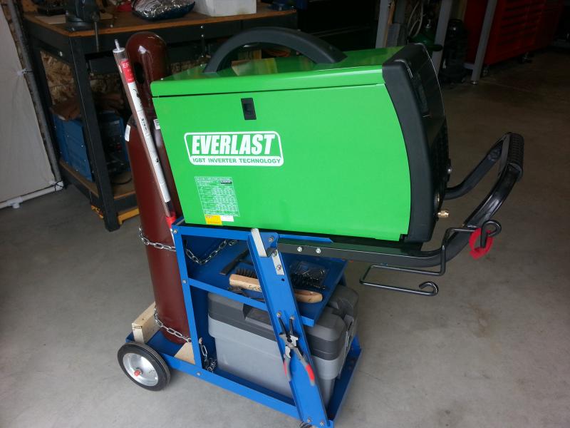

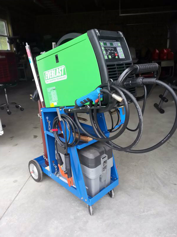

    You are correct. That is a HF cart I modified slightly so it would hold the MTS211Si. I had an older gas power washer that died and wasn't worth fixing. I removed the top portion of the washer cart's handle and mounted it (front side facing downward) to the HF cart. It was a no cost and very easy project that worked well. I might build another cart down the road, but this one works absolutely fine for now.
    Best of luck!

    The cart looks like it would be front heavy without the gas bottle. It might be tipy when trying to change a bottle.

    No issues with tipiness. I've swapped the bottle back and forth a few times, and even had the welder on the cart without a bottle for a few days and moved it around the shop without a problem. I agree that it would be more stable with a bottle on board (which is the normal scenario), but it is fine without. With about 3/4 of the unit's weight behind the front wheels and it sitting at a slight angle towards the back, it doesn't feel any more likely to tip forward then it does to either side. With the handle so far forward, any instability would be obvious once I started pulled it around the shop. So far so good, but as I mentioned earlier this is a temporary solution until I get something larger. I was pleasantly surprised with how well it worked out, especially with so little effort/cost.
    [edit]
    As a quick test, I went out to the shop and removed the bottle from the cart. I pushed the front end downwards and got the rear wheels about 8 inches off the ground before it neared its balance point. Of course maximum stability is with the bottle installed, but it is safe enough when swapping it out.

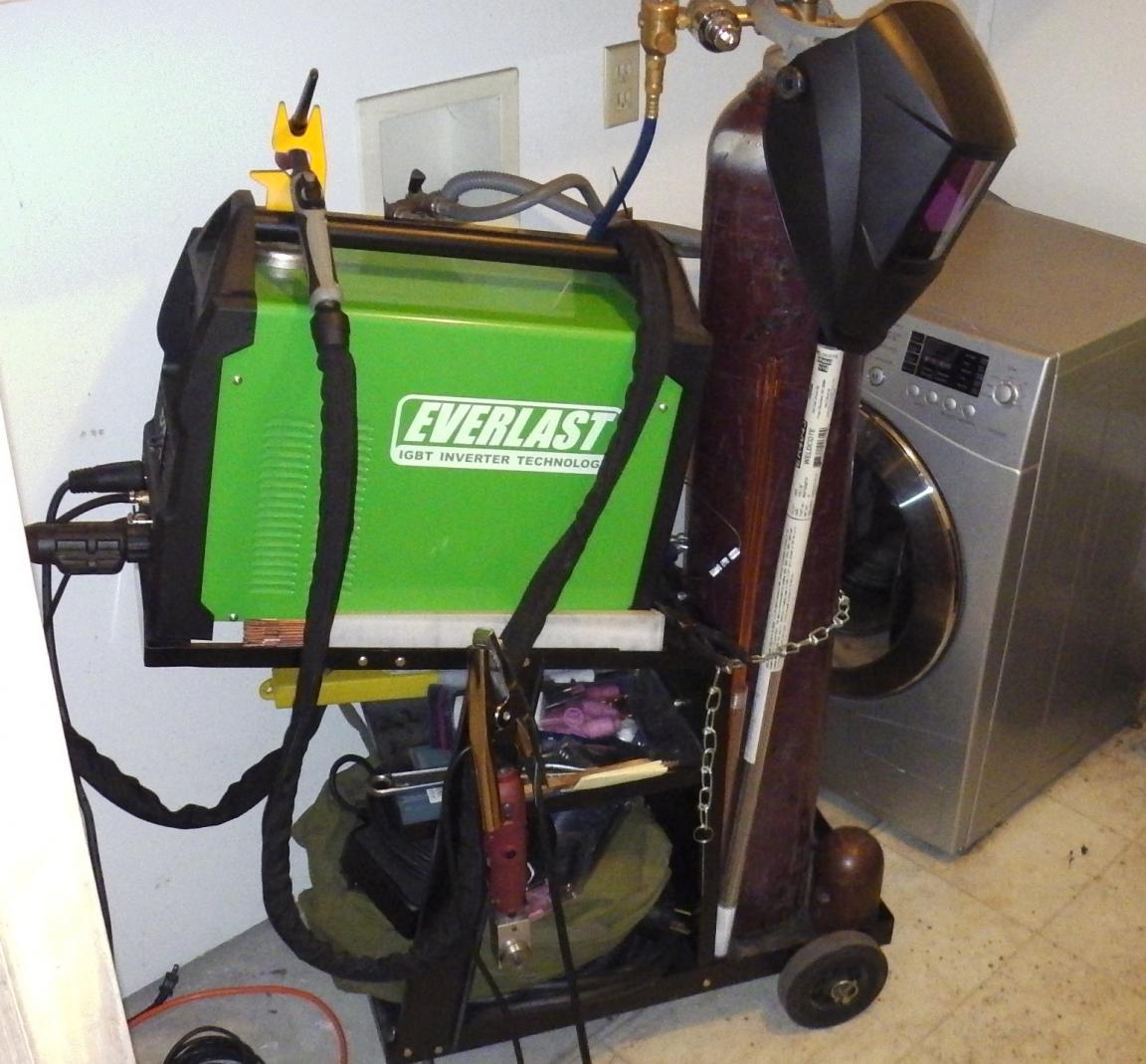

    Yeah,
    When I got an Everlast unit, it was larger than my previous unit. So rather than build or get a larger cart, I just used some angle iron to extend the shelf up top, which acts as a handle too, if pulled from underneath. There is no apparent "tippyness" when the bottles are removed, for changing.

    Call me lazy, but I'm all for the re-purposing route if it works. I think I will follow your lead with my HF cart too.
    Kudos to you and KMA
    I see you have the unit set up for TIG. What kind of materials and thickness have you had success with?
    What are the practical limitations in TIG mode with the 211Si?
