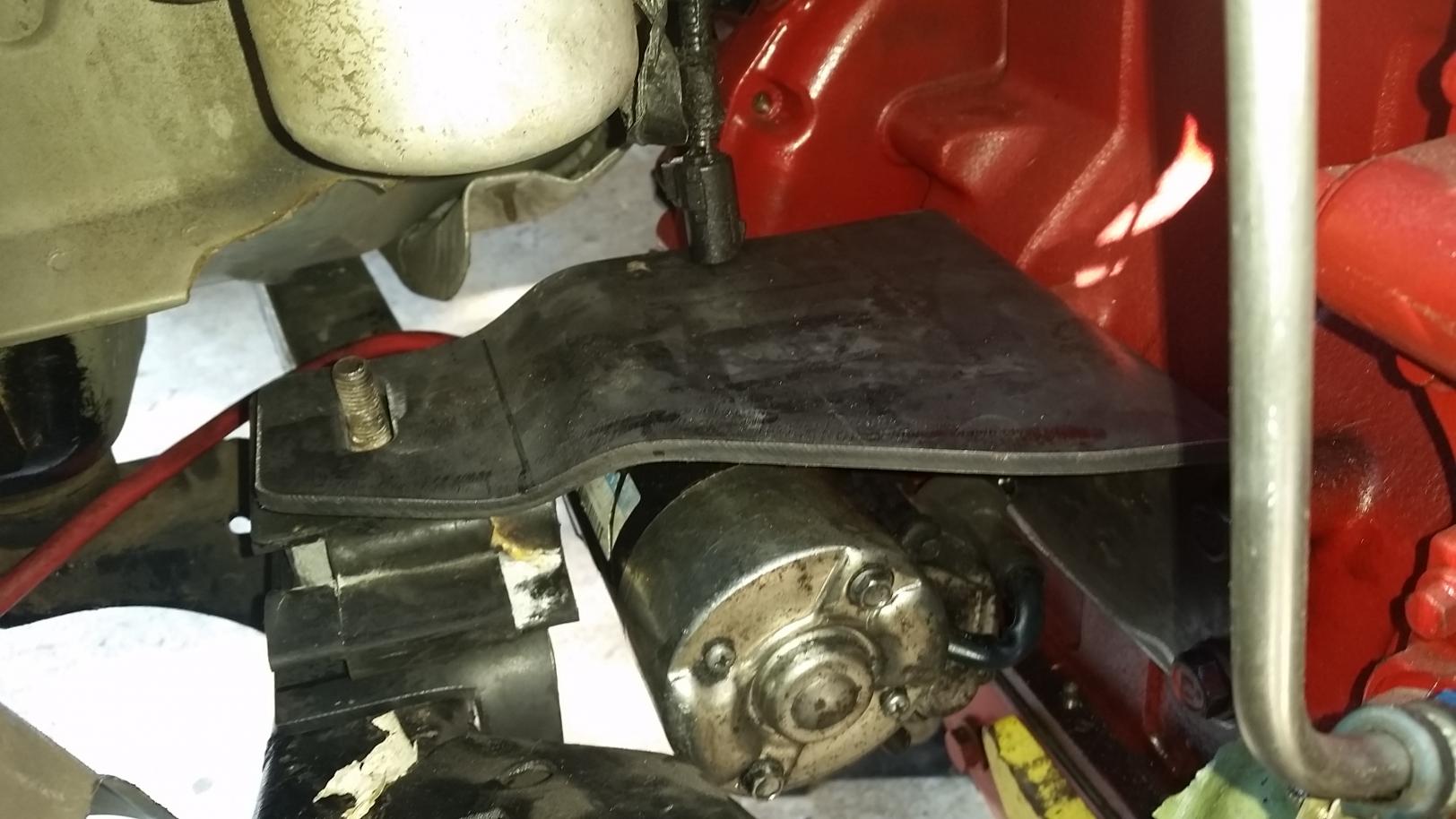

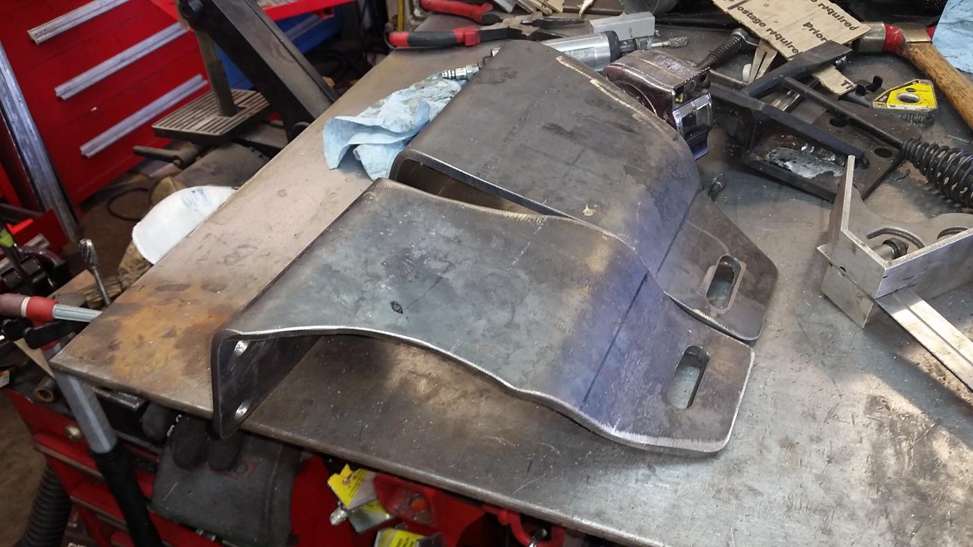

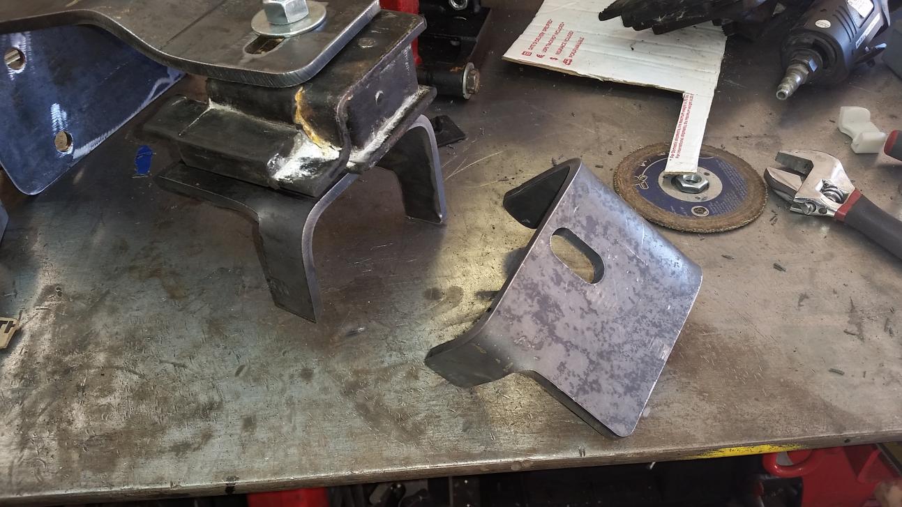

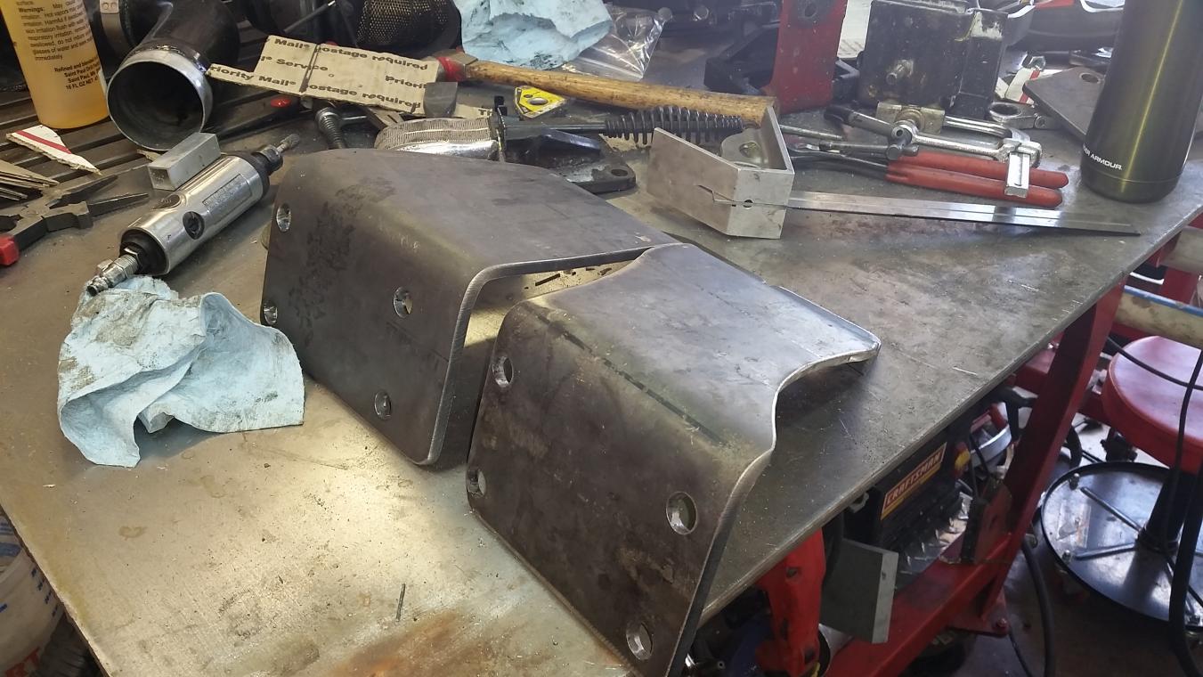

    Started motor mounts for my jeep tj Cummins projectClick image for larger version.

    Looks good, what did you make the bends with ?
    I bent them in my press brake from swag offroad

    Looks much better. I was kinda worried about the flat ones you showed before. Looked like a recipe for harmonic vibrations and then cracking. Hard to tell from the pics, but I would make those standoff spacers, on the right side, at least as large in diameter as the cast bosses they sit on, and weld them to the plates, so the bolts don't see any bending moment and are loaded in shear and tension only. Very cool project.
