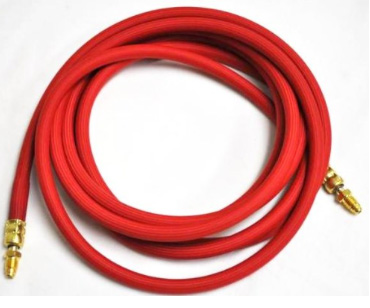

    That PowerTIG 185 seems like it is a potent little welder. I dig the size, weight, and that it even has AC frequency adjustment, and all for a nice price.

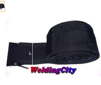

    But regardless of which style of TIG torch cable is supplied with it, I'd upgrade immediately to a CK SafeLoc adapter, and CK Superflex 2-in-one hose/power cable. Then I'd get a TIG hose/cable cover that is nylon or leather, which will be much better than the standard vinyl ones.
    I mean, the 2-into-1 cable-adapter TIG torch assemblies Everlast supplies are better than one with the Argon hose and the power line as separate and two-stranded cable assemblies. But, even they don't allow for an upgrade to a more flexible hose, and so if you damage a hose the 2-into-1 connector is undoubtedly useless without some real crafty intervention. So, the CK SafeLoc keeps things upgradeable and potentially more flexible and lighter, too. These are subtle things, though. They're a bit costly, too.
