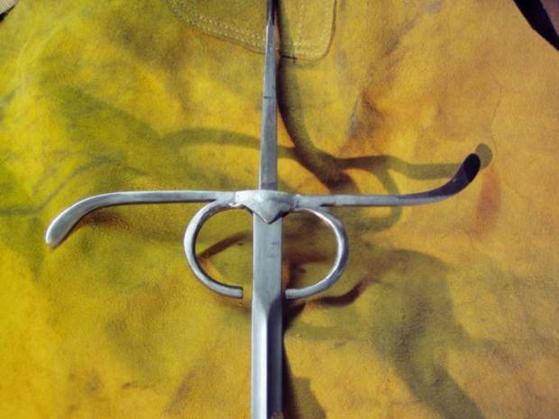

    Here's one of my latest projects, this is the basic parts of a Rapier hilt (fancy fencing sword). I was going to do a complete build, but I forgot to grab the camera till this point. I'm planning on doing a 3 ring sweep hilt, but you never know what happen when your working. All the parts are 5160 and started life as a leaf spring, AKA, junk yard blacksmithing. The hilt will be fully heat treated and tempered when finished. What you see in the pictures are the guilllion (cross bar), the quillion block, and the finger rings. In the 2nd pic I've got the knuckle guard some what in position. This is the rough stage of the 1st part of the build. Once the guard is on, I'll need to finish prepping and finish sand the whole guard because once the next parts are added. It's near impossible to get to parts of the guard when completed. Each part that is added will be finished off before the next part is added.
