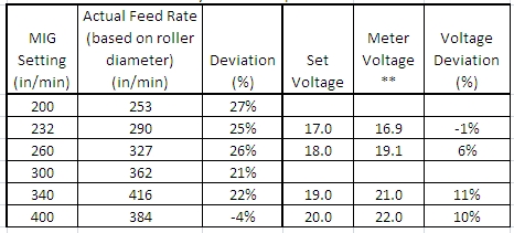

    Agreed that feed speed when not welding is not relevant. So I put together a new test that measured the drive roller speed while welding. That was then converted to wire feed speed. (see photo).Name:  Test Set-Up for wire feed when welding.jpg
    On the right side of the photo is the drive roller with yellow mark to monitor its rotation. I made a video while welding so it could record the drive roller rotation and the stop watch simultaneously. I viewed it in frame by frame mode so I could measure the time for each rotation of the shaft. The volt meter is measuring the gun voltage - I put a simple RC circuit on the meter to take care of the noise and any minor variations.
    The chart attached shows that the wire feed speed is about 25% faster than the speed as set in Standard mode. The exception is at 400in/min. But I also noticed a lot of rotation speed variation at that speed. Will probably redo that.
    The voltage runs about 10% higher most of the time.Click image for larger version.
Name:	Feed Spedd and Voltage.jpg
    Overall I am pleased with the welder (I only tested MIG welding) but I was hoping the settings in Standard mode would be more accurate.

    Quote Originally Posted by WeldMore View Post

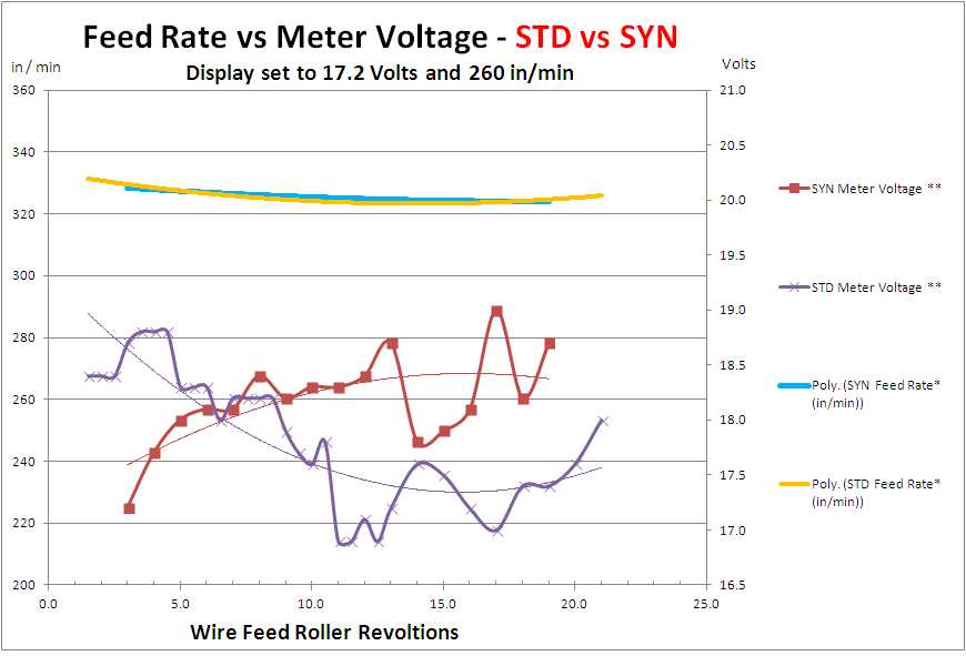

    I did run additional tests. There was no difference in wire feed speed in either Standard or Synergic mode. Same data as before (repeated below for convenience).
Name:	Feed Speed and Voltage.jpg
    Below is a graph showing the wire feed speed and voltage data at one particular setting.
    As the graph shows, the speed feed, although not the same as the display setting, was consistent during welding. But the voltage was both not the same as the display setting but varied quite a bit while welding. I could also hear the difference in the "sizzle".
Name:	Synergic vs Standard.jpg

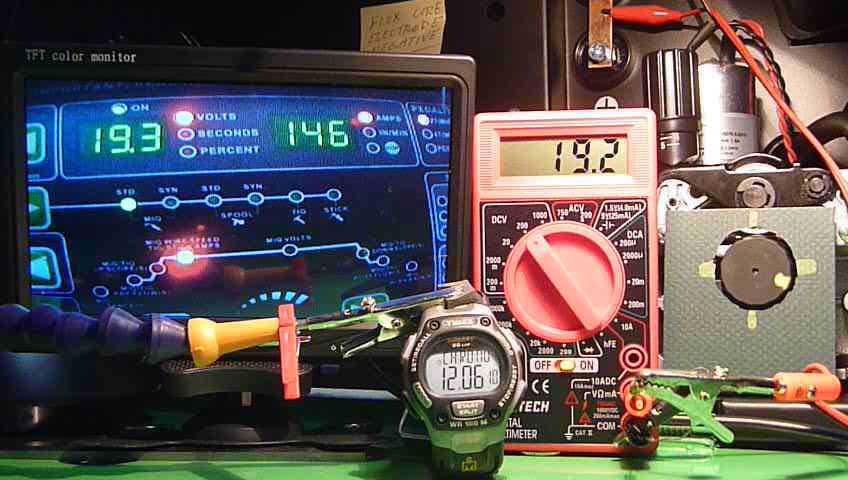

    The voltage was measured with a volt meter on the output as well as monitoring the welder display (a video camera was pointed at the display and a monitor was positioned next the volt meter so I could capture all the data simultaneously). See photo below of the test set-up. Both the meter and display tracked each other fairly well.
Name:	Set-up 18V-260 while welding.jpg
    The voltage variation did not follow the same curve from run to run. But it always had quite bit of variation.

    Several things here.
    1) DC isn't DC here as it is chopped up bits of AC. Cheap meters like this can be affected be affected by it and are not the gold standard of accuracy. I know because I have a couple just like that...and have noticed differences in much more expensive ones.
    2) Drive roll rotation does not give a perfect sample of true wire speed. Wire speed can be affected by spool size and roll tension. It can also be affected by actual feeding back pressure at the puddle. Also there is a difference in figuring roll diameter and revs per minute and actual wire speed due to differences in wire diameter.
    3) Arc force settings can affect readings as well as it affects current rise time.
    4) Doing a comparative test on competitive brands will result in discrepancies as well and without those for comparison, then the information holds less value and weight.
    Not to say that it isn't an interesting tid bit of infomatino, but without something to compare to, and many variables that are not well controlled, and no consideration of the results of the welding it doesn't really make sense to put a lot of stock and time into it.
    Change in sizzle and voltage is affected by stickout and deviations in exact tip to work distance which cannot be controlled unless used in a jig and consistently fed at a continuous rate.
    Hi Gene,
    Thanks for following up. What type of voltage variance were you seeing in your testing? I did three runs and recorded the welder display in order to capture the voltage and amperage shown. The standard deviation I calculated for the voltage was approximate .25 volts, and for amperage it was approximately 9 amps. I tried my best to last a constant bead, but others may have been able to do a better job. If the forum cooperates, I'll post the plots of my reading.
    Thanks,
    Kevin
