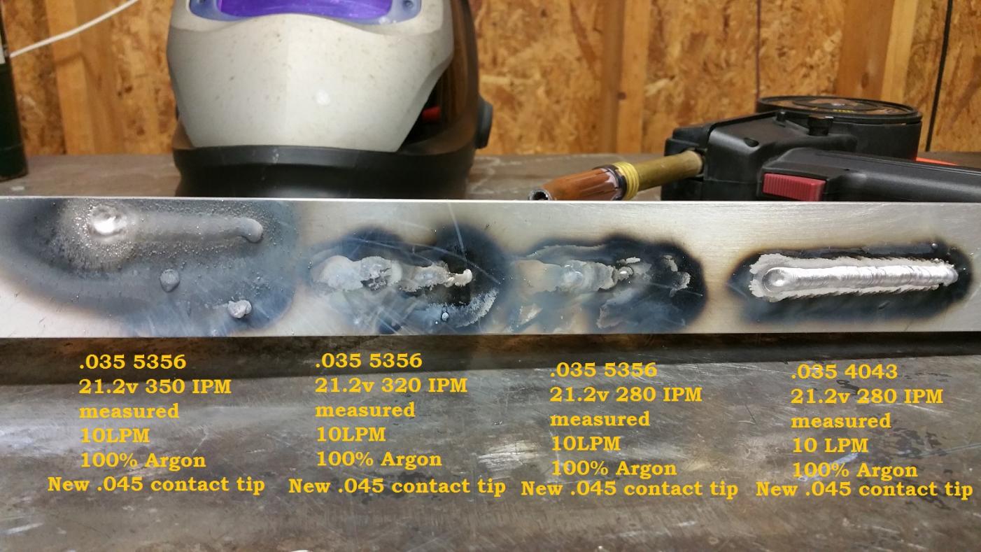

    I've been practicing with my 200N spoolgun on the I-MIG 250p. I started with 5356 .045 wire on 1/4" 6061 T6 and found there is no setting where it would spray. All I got was smoke and lots of spatter. I tried on some 2" x 1/8" angle with the same result. All material was clean, brushed and oil free. Using pure argon at 10 lpm and a 15 degree push angle. After searching the web for answers I came across another guy having the same problem. His fix was to switch to 4043 filler and all was well. I got some 4043 and now it sprays and makes a pretty nice weld but I have black soot around the outside of every weld. I also get a greenish flame popping from the nozzle every second or two with an odd sound. I cant find any place where air would be getting in the nozzle. The only cause I can think of is maybe the new piece of 1/4" pvc air line I used to connect the argon tank to the mig welder may be out gassing. Any suggestions ? I'd love to hear any tips or advise. I need to get this thing dialed in.

    zoama, without getting into a useless argument about 'spraying', what voltage are you starting at? Forget the IPM as that is meaningless until you achieve the 'sweet spot'. Strange things happen but it makes little sense that it won't run 5356. Pics would help. Some smut is always going to happen, though pulse reduces it measurably.

    I've been working a lot lately is why I haven't updated. I may have to wait til this weekend to do more testing. Here's a pic from my last quick test.
    I know the wire speed was too low but the 4043 made an ok weld on that first setting so I put the 5356 in at the same setting and got nothing but a burned tip. I'll do more thorough testing this weekend.

    Ignore the results with 4000 stuff. It seems you have not enough wire for the voltage. These machines that don't have amp/volt meters can be all over the place. Set volts @ 22 and turn the wire up full. It should 'stub' meaning too much wire and no welding happening with wire folding over and 'stubbing'. You can't f__k up a tip that way and I'm guessing perhaps you may have roasted one or two? (Oops edit, you did burn some tips! Too fast read through of your post)) Gradually turn wire down until you get a semblance of a weld, then tune down more until it's minnie-ginny. The first sign that you are going in the right direction is the welds are proud and look like worms, like your 4000 weld.

    I am a rookie at spool gun welding but turned out some pretty good welds so far. What I've had good results with is-3/4" stickout and NO more but works with just a tiny bit less. Slight forward backward motion. Always push the gun when possible (less soot) same size tip as wire. I saw in pics .045 tip with .035 wire. 1/2 " nozzle as a universal size. 18 CFM. Make sure the tip is not a long ways in from flush with the nozzle. Move quickly. Tig welded for more then 30 years and just started with a mig. Certainly not my preferred method.
    Zoama,
    Work with your arc force control and set it left first. Turn burnback as far down as you can. Keep in mind that these machines can't be measured easily as far as wire speed since the unit speeds up somewhat when arc is sensed. Take a look at the actual output amperage when you have the gun engaged. Use one size larger tip since you are likely using copper tips, the same as you would with steel. This will cause feeding issues as the aluminum will swell up faster than the copper and cause burn back and sticking...even bird's nesting in extreme cases.
    Edit: never mind....I see the picture says you are doing just that. Turn the wire feed wide open to start and back it down till it smooths out.

    No luck so far, just lots of spatter and smoke at any setting with 5356. I start at 22v with the wire speed at full and slowly turn it down while welding. .035 never stubs, it just smokes and spatters as I turn it down until it melts the tip. Arc force doesn't help.
    I've tried two different brands of wire and three different rolls. I burned a small section out of my only nozzle last night and they're not available locally. I think one of the biggest problems is my wire curls hard to the right coming out of the tip and I'm welding to the left. I don't understand why it will weld with 4043 and not 5356, it just doesn't make sense. Does anyone know how to correct my wire curl issue ? Are there any different barrels for the 200n that use common front end parts like Tweko ? I like screw on nozzles because they seal and always stay centered. The slots in these Binzel nozzles will suck air if the nozzle isn't fully seated. It's easy to see by putting a small light inside the nozzle and pulling the nozzle forward about 1/16". You'll see the slots light up.

    If .035 never stubs then you do not have enough wire speed to run it. Go to .045 and turn the wire speed all the way up. You should get more metal per inch so you do not need as much speed. If it stubs then start turning the speed down till you get a weld going. In extreem cases I have actually bent my contact tips to correct for the curl in the wire. That was on older guns that had the 4-5 in. long tips that clamp in place so I could spin the tip to the direction I needed to correct for the curl. If your gun uses short tips and or screw in ones you might not be able to do that. You might need to anneal the contact tip first to bend it.
