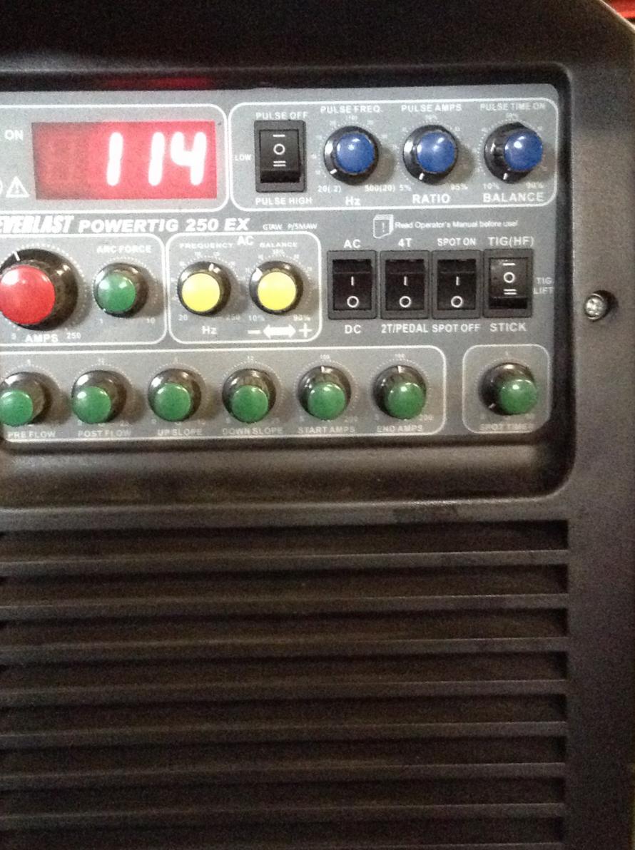

    I would like to know how to check and adjust points on my welder? Can someone point to adjustment procedure? SN# is 155704099. I want to make sure these are set correctly. Thanks ahead,Skeeter
    To elaborate it a little further I am usung a ck torch,no switch,ssc pedal. Weld 1/8 steel. Wire wheeled and wiped down.Welder set as in photo. All was going well and stopped for a few minutes. Went at it again and amps seemed low. Looked at display with arc struck and it showed 46 amps. Was using foot pedal. I had to stop but went at it again a few days later and welder worked fine. Then stopped for a few and went back with no amps at all. Display did not change this time. Using about 7-1/2 lpm on argon. Checked all connectiions. Checked ground. Ground clamp was attached at wire wheeled spot on work. Seems like something intermittent. I want to insure points are right. I do not know where they are located or what the correct setting is. I know how to set points. I am using a Everlast cooler with RV coolant. Welds shown are test welds.

    For TIG, you really need to grind off all that mill scale until you have bright metal. Wire wheeling won't usually remove it. That scale will plate your tungsten with a lot of contamination. The points are only for the HF start and won't have any change in welding amps or the display. The points gap is around .030". If you want to check them, call support for a walkthrough in how to access them. However, you can also switch to lift arc start and try that. If you are still having problems, it's not the points. I suspect that most of your issues is from that mill scale. It can act as an insulator both where you are welding and where the ground clamp is. Can't see where you have postflow, but make sure it is about 10 seconds or so. The rest of the green knobs can be set to minimum settings for use with the pedal.

    If it has points, .032-..040 works. closer to .032 usually makes easier arc start. .035 is kinda the sweet spot on mine. Put .032 paper between,closed up, turn open till paper falls out,lock them down.
    If you do not have a feeler gauge, I used to tell people use a credit card, set it where the card will move a little and also slide out. Not humidity will effect it a little. Clean metal is a must for nice looking TIG. Also, make sure the amps are a little more that on need if using a foot petal. You can go up and down as you go.

    Looking at the front grill of the machine, the points are roughly behind the 10 o'clock position. If you look through the grill when you press the pedal you'll see the points arc and hear the buzz.
    Unplug the machine and wait at least 15 minutes. The cover comes off by removing the rear and side screws. Do not remove any screws from the front panel. When replacing screws be careful not to over tighten.
    Depending on the build date you might have the threaded rod type points previously described, or flat points that you will bend to adjust. If you search this forum, you can find pictures of both types.
