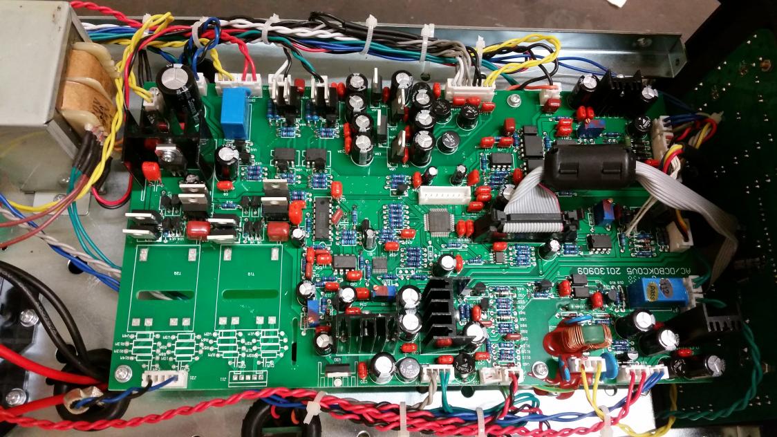

    Well, my luck has struck again. Welding along today at 75 amps, DC, no pulse when all of the sudden I couldn't strike an arc. I tried grounding the tungsten to the work repeatedly and nothing, looked over at the machine and the panel is dark with the fan running, WTF!?! Of course this happens when I'm seriously under the gun with work. Called tech support, he said cycle the breaker on the wall, maybe a leg isnt making good contact... well of course that didn't work. No other ideas from tech. Gave me an RA number and said I may could get a board sent to me to try. Two calls in so far, no response. Really really anxious as I've read some horror stories on warranty or service work. The machine is 6 months old, 2015 model, single phase, NOT worked hard at all. Is there any diagnosing I can do myself? I can verify with my meter that theres 240V going to the board at one point, but have no display lights at all and nothing from the gas solenoid when hitting the pedal or switch. Does this seems like a board failure?

    As this machine is pretty new, you will most likely have to be the troubleshooting trailblazer. First thing I would do is a through visual inspection of the insides, specifically all board to board interconnects. Then go over the boards to check for obvious physical or thermal damage. If you have electronics knowledge you can trace the low voltage power supply that powers the control boards. Check voltages at the primary filter caps and before and after the voltage regulators. You should be able to look up the data sheets to see if things are in spec. Probably a 5 volt rail for most of it, but it could be 3.3, as a lot of new micros are going that way. Since the display is dark, that's where I would start.
    However, be sure to talk to support to get the OK to proceed. I'm not sure how many of these have been repaired, so they may not have much in the way of statistics on what goes wrong with them, apart from the common shipping damage from being dropped and such. If you are under the gun to finish a bunch of work, it's probably not the right time to try and troubleshoot an unknown machine. Rent or buy a replacement machine. You can always sell it later.
    Well, you're right that I shouldn't poke at this thing too much as I don't have an in-depth electrical skill set. This just couldn't have happened at a worse time and while I really need a machine right now, the closest thing is a Dynasty or a Lincoln Aspect. Buying one of those means green is gone as they're both a HUGE investment. Never had a machine go down and man is it throwing me for a loop now.

    Rambozo, here is a shot of the old one. I took it to make sure I got everything plugged back in Click image for larger version.

    Well it sure looks like there is some type of programming port right next to the processor. Can't make out any chip numbers from that pic, though.
    My curiosity is piqued by the unpopulated sections, where two transformers go. Is this the 240/480 model or the 240 only model? Overall it looks like a nice board layout.

    Got the board in, fired up the machine and all seems well! Bummed that I lost all my memory settings but at least I can get back to work. I still don't see a thing wrong on the old board so I have no idea what exactly went wrong. I may look into having it rebuilt to keep on hand as a spare. Thanks very much for getting me the part, I was literally going to buy a machine today!

    Board is actually fine, the software was corrupted somehow. All that board needed was to be flashed with new software
