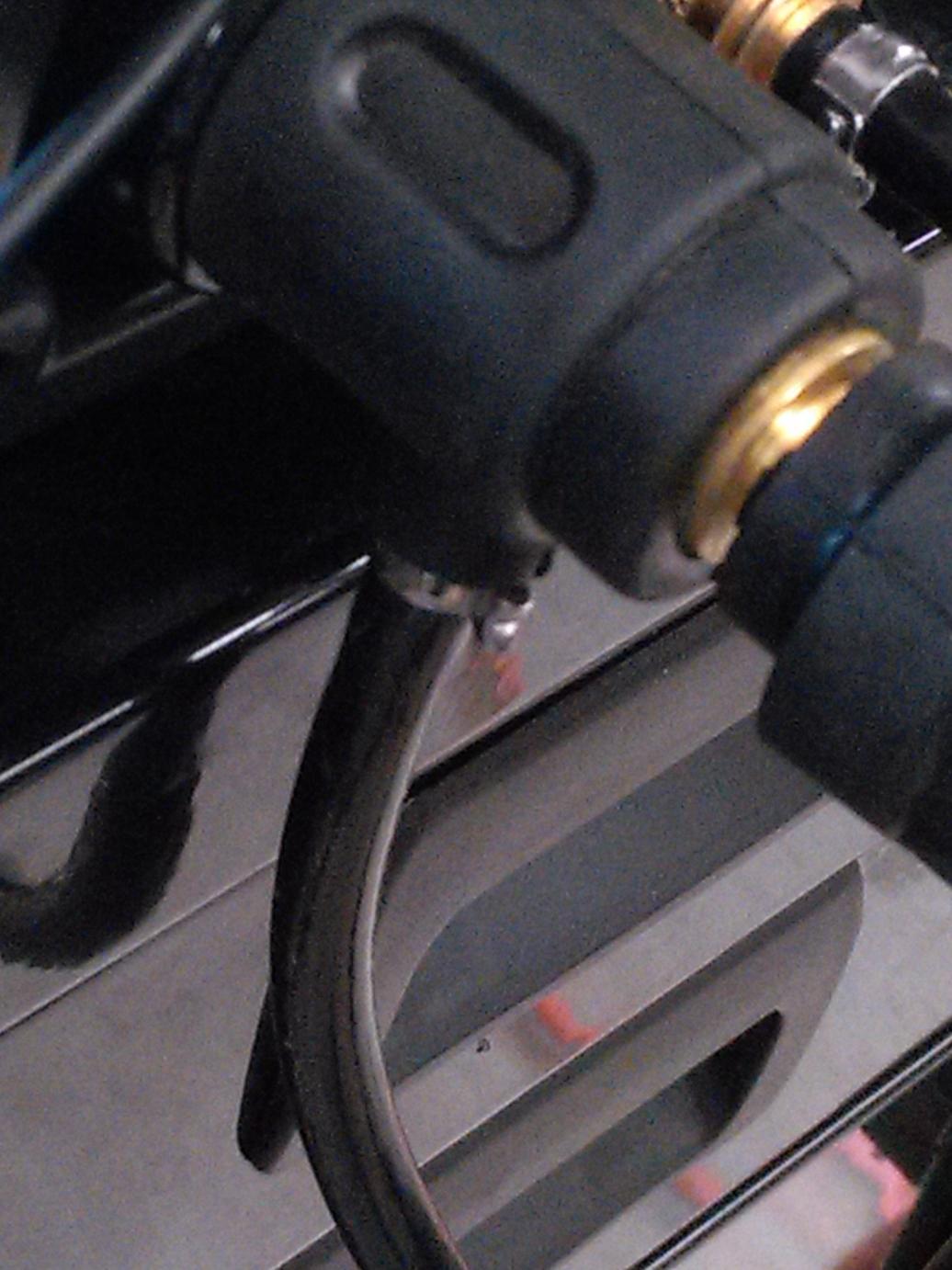

    Thank you to everyone for the advice. While I am planning on using this mostly inside the garage on 220V.... I can also see a real need to use it in the driveway on 110V.... (unless I either have long 220 extension cord or longer leads for the stick welder). I was using the stick with the indicator sat at 112.... does that indicate 112A? Also, is there anyway to rotate the air intake on the plasma plug? I have it setup per the drawing in the manual and my airline turns straight down... this puts a bad bend in the airline and I think it is restricting the airflow.... if I can rotate this 180 degrees, the airline will go straight up.... if not, I will put a block under the unit to raise the front. (I am using the better welding cart from HF if that helps in the visual)

    Could you post a picture of the airline problem ?

    Zoama, I do not know how to post a photo. If you will send me a PM I can send you a photo. I found that I can get the airline straightened out sliding the entire unit forward. This may be the answer. I can put a block behind it to keep it from sliding backwards. BTW, does 112 showing on the meter indicate a maximum of 112A?

    Hopefully this will work...... Just in case, the middle photo is with my Everlast pushed forward to allow the airline to clear the cart.....
