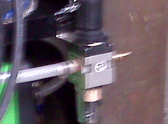

    One thing I did discover was the air regulator mount bracket was WAY too close to the inlet pipe, I will be making a modified bracket to move it over and guard it more and I will provide pics when I make it.

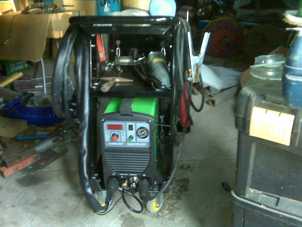

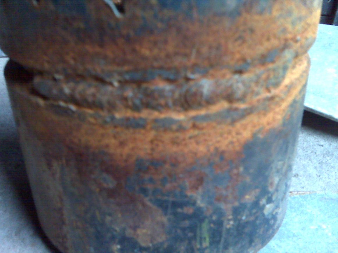

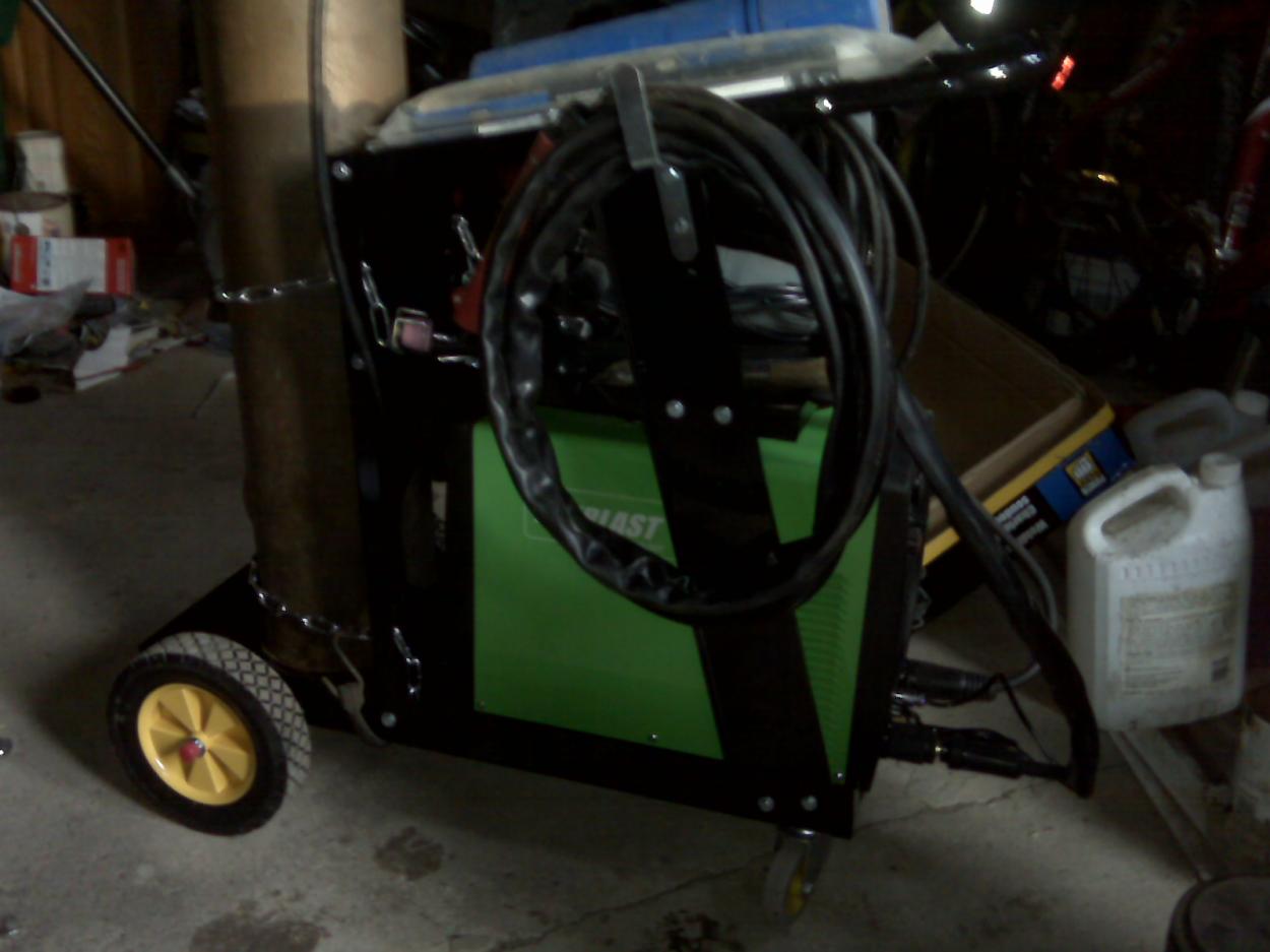

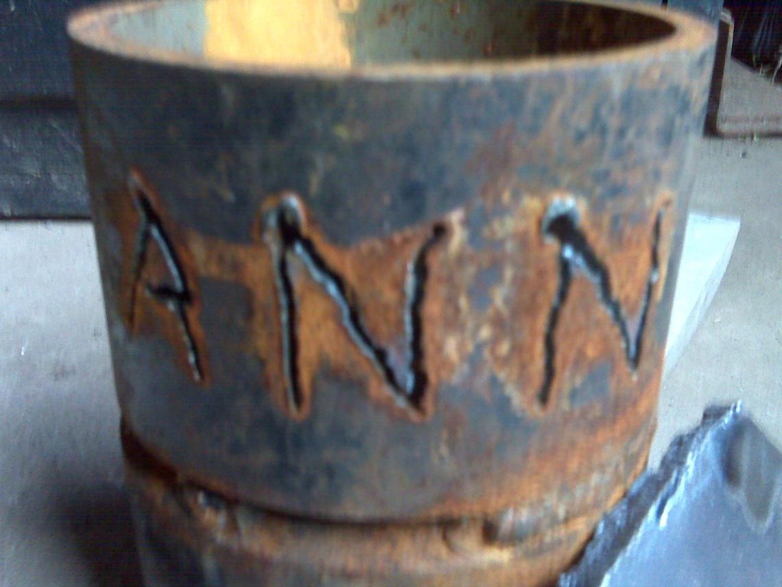

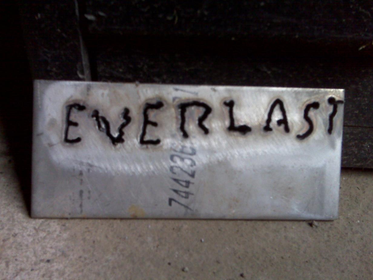

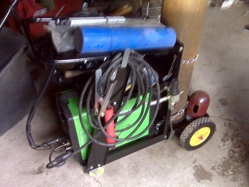

    Sorry about the long delay for pictures, it was a busy two weeks at work and home. Had some exhaust problems with my wifes truck called the muffler shop they told me it would cost $200-$700 to repair. It cost me twenty bucks and some hydro(thank you Everlast). My old machine would have repaired this but would not have been as neat or as quiet. the pipe repair was done at 60 amps with the stick welder on the truck vertical up pipe split and forced over the old pipe, #308L 3/32 stainless rod. Also welded a jig for one of my associates at work hardened 1/2" plate preheated and welded with 7018 rod. then we Plasma cut some pieces for fun, wrote my wifes name in one pipe and Everlast in a piece of 3/32 stainless. It cuts really well, even with low air pressure. I repaired a broken weld on a chair with tig and didnt even remove the fabric from the chair(no burns in it either) I dont know if you can see it in the picture but I had just enough room to get the gun between the rails. Also welded some more stainless strips just for practice. the cart I put the machine on is a fifty dollar Princess Auto mig cart. modifed the handle to fit in my van, cut a hole in the back panel so the fan works properly,mounted the welder in the bottom after cutting the front lip down (hole and lip were plasma cut and ground clean. I moved the water separator/regulator to the right side of the cart and reattached the hose I included some shots of the unit on the cart. My boss saw these pictures and asked me how big it was how much it weighed, power capabilities etc. I really want to bring this machine to work as it would make weld repairs and asbuild cutting on the machines we build much easier.That is all I have time for now, will submit more pics on the project site as time permits.
