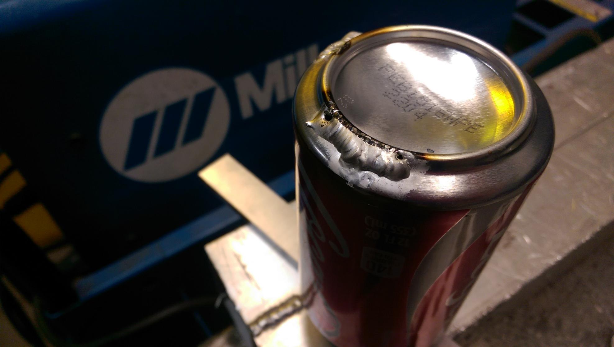

    Just to show I'm not a complete hack with no clue, I just went down to our weld lab at work and hopped on a Dynasty 300DX and laid a 5356 bead on a Coke can.

    Pedal control from 5 to 15 amps, 15 cfh argon, #5 conventional cup with 1/16" tungsten. It was actually pretty easy, and could hold a 5 A arc at 15 volts, all day long. There is NO way I can do this on my 255 ext right now.

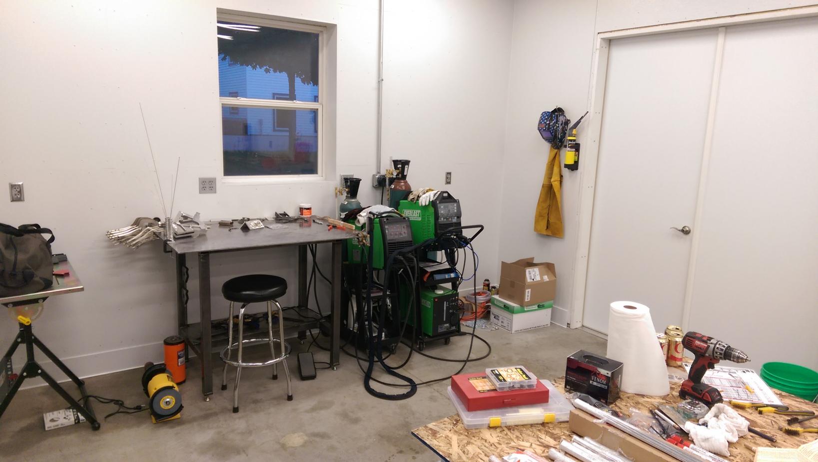

    Environment
    My shop is completely enclosed, doors shut, and windows shut. It's finally warm enough that the heater isn't running anymore. I'd say the air is dead still. The welder is on a cart, about 3' from the table.

    Other than when I swapped out my usual water cooled torch to see if the gas cooled was any better, I've been using a #5 gas lens. All Weldcraft parts on the torch body that came with the welder. I checked for gas leaks tonight by pushing the tungsten up inside the lens, snugging down the back cap, then plugged the lens with my finger and turned on the purge. There was a leak past the back cap o-ring (which seals to fairly non-firm rubber of the torch body, but that's a whole 'nuther issue). I fixed the leak by going to a thicker o-ring I had in an o-ring set.
    I normally run indirect grounding via a single star ground point on the welding table (3 cables: TIG, MIG, and an extension cable with a clamp for off-table work. All with crimped on ring terminals and 1/0 cable). Per your request, I did the tests below with the ground clamp directly to the material. I used the factory supplied cable and clamp for this. The ground clamp is connected to the machine + and the torch to -, as it should be for TIG welding.
    I made sure the aluminum stock for this test had very clean surfaces for ground and striking the arc. I cleaned up all the surfaces with a 180 grit flap wheel in my 4.5" grinder. Subjectively, free-handing, this did seem to yield a bit more stable arc, but the change was small, and still no go when I tried starts at 5 and 10 amps.
