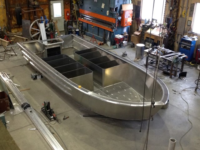

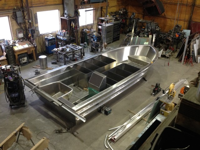

    This is off topic a bit but it does, at least, include the word PULSE. The picturesincluded shows a skiff I designed that is being built by someone else as I couldn't fit it into the schedule. Anyway, the two young men that are putting it together under my direction (they've never built a boat before) bought a complete Miller set up a year ago: XMT 304 with an OPTIMA pulse control, XR wire feeder with water cooler and water cooled 30A gun. They paid over 11K for the whole taco. About a month ago I stopped in to see how they were doing; the day before the XMT smoked, as in billowing toxic yellow clouds. Two weeks later the XR box went oingo-boingo (erratic feeding) then completely crashed, hooked up to an old spare power supply. So, they have been finishing the project with an old 30A spool gun off the old power supply! Of course, it's under warrantee, but the service with Miller really sucks in Alaska. Not to throw gas on the China Vs. USA debate but it is an example of poor QC with a major. Frankly, in my moving about in the welding world here in AK, I've heard increasing unkind words from some about mostly Miller equipment.

    Would that that would be good for me but I'll be hooking whatever supply I choose to an XR box w/30A gun. I really wish that Everlast would get with the program on a real MIG aluminum welder, I think you guys are missing the boat on that. I can understand that expecting a push-pull feder might be daunting but I think you could relatively easily make hookups for 30A, Prince and Lincoln spool guns for your machines. If me and Kempy can do it, certainly you guys can!
