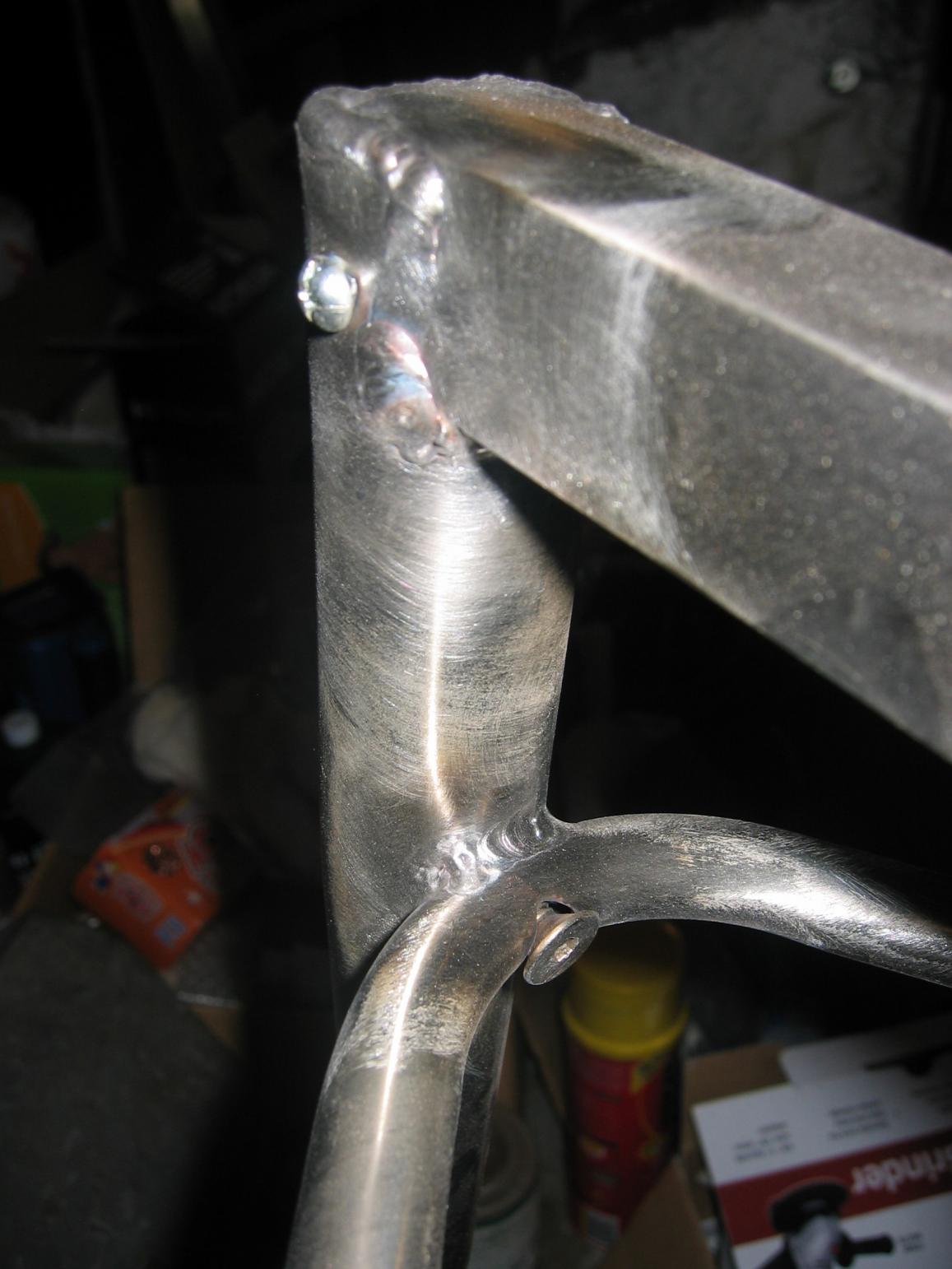

    Attached picture is a stainless steel chair .049" diameter, I welded using 1/16" 309L and .040" tungsten. You don't want to use much amperage for welding stainless. I usually control with footpedal, but would guesstimate about 40 amps average or less for exhaust tubing. Keep a tight arc to focus the heat and make a narrow puddle, and minimize overall heat input. Weld in stitches and allow cooling of the part in between. If a large portion is glowing red after you are done welding a stitch, take a break and do something else to allow the work to cool before welding near there again. Stainless is slow cooling. A larger diameter gas lens cup is also adviseable. Using some pulsing to minimize heat input if your machine offers it. (For this I would go with min. pulse freq, min. pulse duty cycle, and minimum background current.)
    Oh and almost forgot, use plenty of post-flow to keep the metal shielded, it needs to stay shielded with argon even a little bit longer after it stops glowing. You can re-trigger the post flow by tapping on your footpedal, repeatedly as many times as is needed. Avoid the "dull grey" looking heavily oxidized surface.

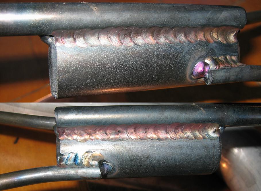

    However I've noticed something I like using about 309L to join mild to mild - it seems to dissolve oxides very well, and not leave anything floating on the surface, giving a really fluid, easily controllable molten puddle, as well as a great looking weld deposit. check out the attached picture, 309L joining cold rolled mild steel together. The puddle is really fluid. I've heard the nickel is what gives the oxide dissolving qualities. Sort of like a built-in flux that needn't be cleaned off afterward. 308 might work well for this too but I haven't experimented much with it for welding mild steel yet.
    I've heard from others that 309 works really well for welding dirty steel (like hot rolled mill scale), although I haven't had opportunity to try it on that yet. Maybe kind of like a built-in flux that doesn't need to be cleaned off afterwards.
    (The "L" suffix means low carbon by the way, and generally increases ductility of the weld deposit at some loss of tensile strength - usually but not necessarily always a desirable thing IMO.)
