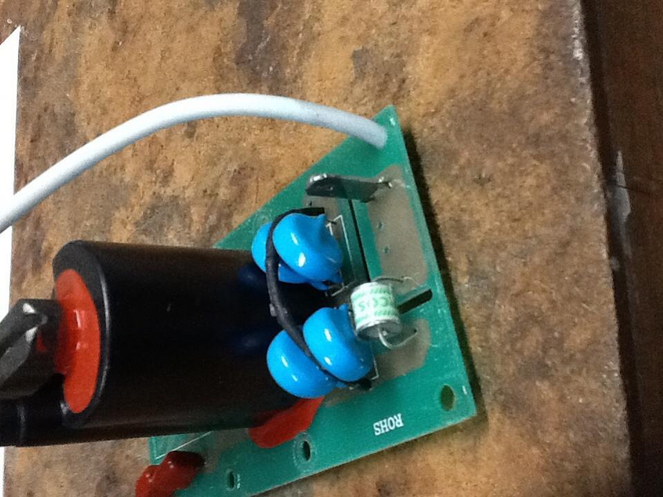

    I have the 255ext with the same problem. I see a blue light through the front cover, but no spark. I don't see any contacts. Does this mean it has solid state HF?

    Here's a picture of the HF board. The small can in front of the blues caps is the blue light. There's aren't any contacts to adjust. Unless they are somewhere else in the welder

    No, that is the solid state board. Must be a little different than the one I have. The "can" doesn't emit light on my unit. It's metal.
  19. Default
    I see and hear the same part in my 325, lights (like an arc) when pedal is pressed.
  20. Default
    It's strange. You wouldn't think it was a light by just looking at it, but it definitely lights up when the pedal is depressed. It kind of looks like a capacitor.
