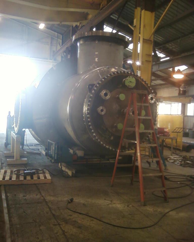

  1. Default coal trailer and some tank pics from work

    HEAVY METAL!
    What is the travel speed on that submerged arc rig?
    well i usually just eyeball it when i set it up but i'd say around 20-25 in a min give or take and after i get a little bit of filler metal in there I crank it up to about 36 volts and 125 on the wire speed using 1/8 wire
