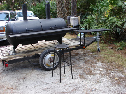

    I posted this over on welding web but thought I'd share it with you here. I built this for a guy recently and it turned out quite well. He did not want a large fire box and I built a lot of it to his specifications. It turns out it works quite well. Though I have built several over the past few years, this is the largest one to date. Its supposed to be a 330 gallon tank which is about 9.5 ft long and about 32" wide. Those are rough dimensions of course. I built it in stages. The customer decided he wanted a couple of more things done once he got it back...so I obliged.
    Even with the small fire box, I managed an even 230 degrees with only about 30% air flow. There was no more than 10 degrees difference from end to end. It cooked for about 6-7 hours before I "killed" the fire by shutting off the air flow. I started with about a 10 lb bag of charcoal, got it ashed over and then put some quartered up oak on top of the coals. All total it only consumed one bag of charcoal and 7 -8 pieces of oak. When I shut down the fire, it left 3 large pieces of relatively unburned oak in the bottom.

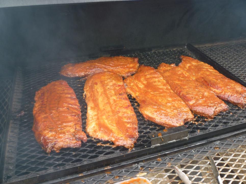

    Mark's grill (well not really Mark's grill he just made it and tested it) in action.
    Im calling FOUL...........no posting of food that looks that good.
    Now I gotts find me a Rib joint for supper.

    Default Mark, how about some more pictures of the inside??
    Hey Mark, If you have more pictures of this grill, would you please post them. I have a tank available that's about the size if the one in your first post on this thread. I've had it for a couple of years, and seeing this thread has rekindled my interest doing something like this with it. I'm hoping to see some detail of what the firebox, and damping system look like. Thanks in advance
    ESAB MigMaster 250-borrowed
    Purox OXY/ACETYLENE
    The fire box was under built per customers request. It should be three times as large by most peoples recommendation, however, it worked very well. The damper system consited of a butterfly valve a the top of the stack and the air control at the back of the box which simply slides in a angle iron track.

    ok, so with only 10 degrees difference from side to side does that mean you have a trough or something in the bottom that makes the heat/smoke have to travel the length of the cooker before it gets to the food? indirect cooker or whatever?

    No it doesn't have a trough, but seeing as how the heat travels fully from one side to another before exiting it heats evenly.

    Default Have you weighed the finished rig?
    I just came across a deal on some trailer axles that may be a good fit for my project. My tank is already in trailer form, but not nearly as nice as what you've got. If these axles will hold the weight, I'll be getting them and going with a design similar to what you have. Could be said that I REALLY like what you've done

    The first pictures were of the finished product.
    I am working on another now that will go cross ways over the axle...with the tank in the bed of my truck in the pictures. I have been looking around for a better fire box. I had a perfect one picked out of a air compressor that had gone south, but when I cut it open, it was about 1/8" thick. You need a minimum of 3/16" preferably 1/4" thickness, or it will burn out rapidly. It will be configured differently with the fire box attached to the side of the tank. I have been letting it sit for a while now, and I really need to get it together, but work and other concerns have been distracting me from its completion and my search for better firebox. I have another tank to go get, but its larger than I want for a firebox. I found some slightly damaged thick wall 24 inch pipe, but the price is too high.
