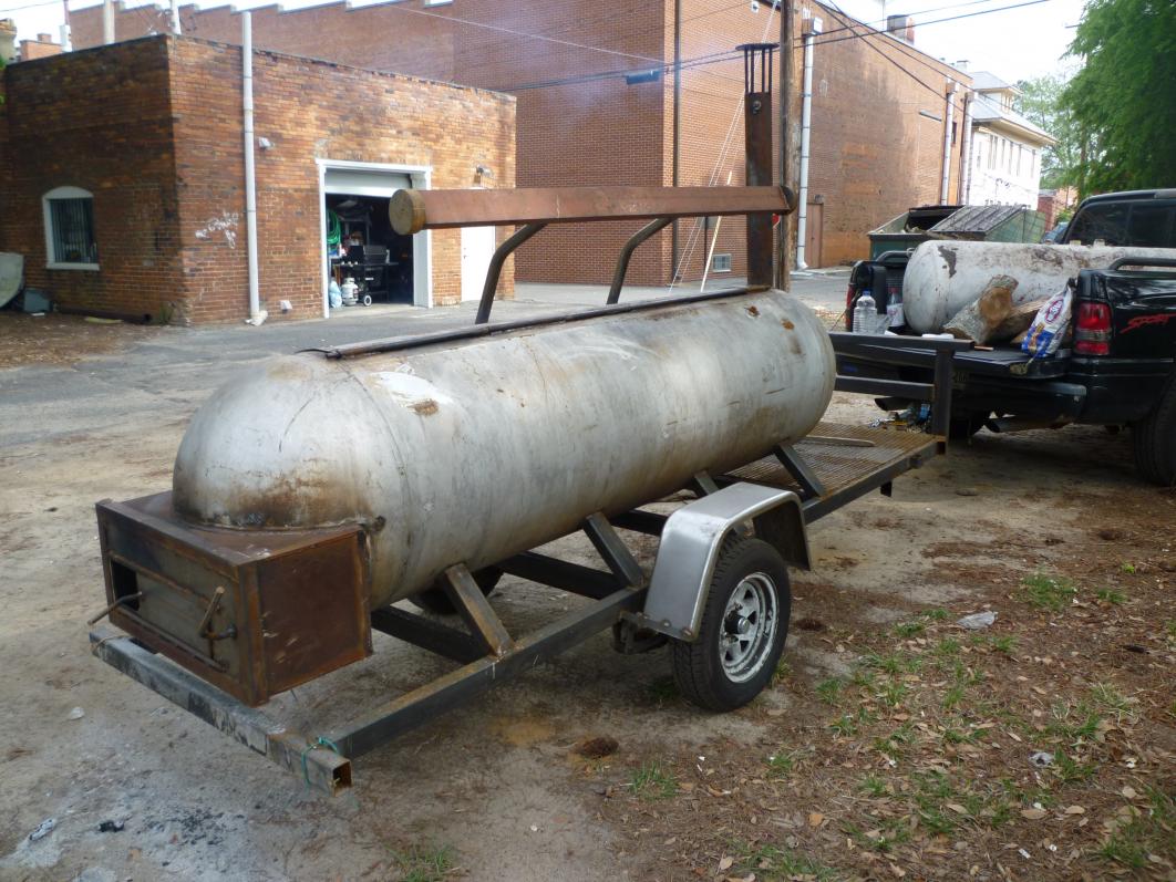

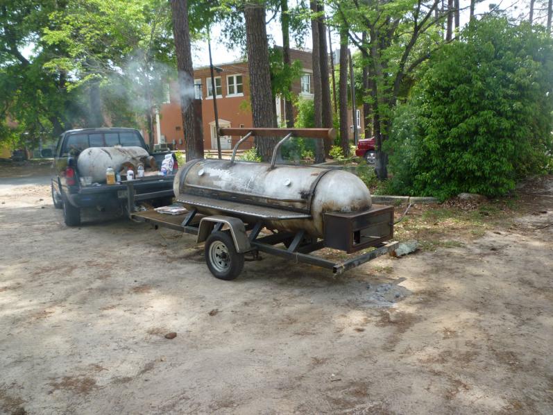

    I posted this over on welding web but thought I'd share it with you here. I built this for a guy recently and it turned out quite well. He did not want a large fire box and I built a lot of it to his specifications. It turns out it works quite well. Though I have built several over the past few years, this is the largest one to date. Its supposed to be a 330 gallon tank which is about 9.5 ft long and about 32" wide. Those are rough dimensions of course. I built it in stages. The customer decided he wanted a couple of more things done once he got it back...so I obliged.
    Even with the small fire box, I managed an even 230 degrees with only about 30% air flow. There was no more than 10 degrees difference from end to end. It cooked for about 6-7 hours before I "killed" the fire by shutting off the air flow. I started with about a 10 lb bag of charcoal, got it ashed over and then put some quartered up oak on top of the coals. All total it only consumed one bag of charcoal and 7 -8 pieces of oak. When I shut down the fire, it left 3 large pieces of relatively unburned oak in the bottom.

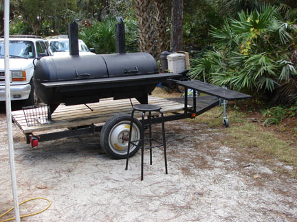

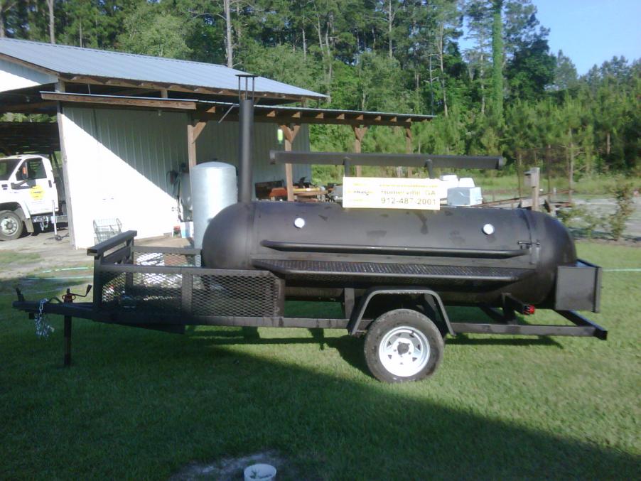

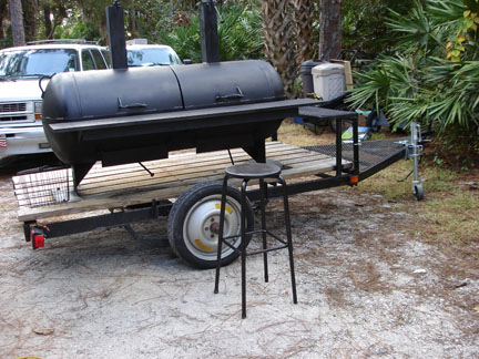

    Here's one from awhile back. Not as large or nice, but it is a grill/smoker. We used it for a month before the guy came for it. About went broke feed the local kids that showed up each weekend.

    Mark's grill (well not really Mark's grill he just made it and tested it) in action.

    The fire box was under built per customers request. It should be three times as large by most peoples recommendation, however, it worked very well. The damper system consited of a butterfly valve a the top of the stack and the air control at the back of the box which simply slides in a angle iron track.

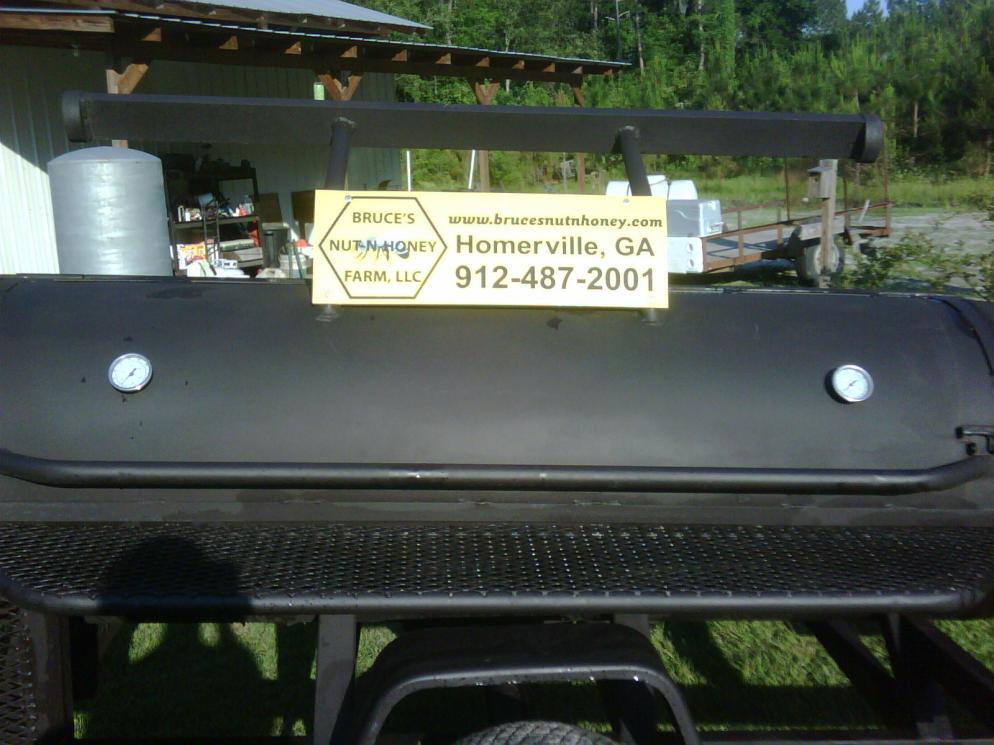

    any chance you'd post some pictures of how the hige is built, and how the door seals up? Also, where did you get your thermometers?

    The hinge is a simple piano hing I make out of pipe and cold rolled round that slides into it.
    The doors were cut with a plasma and have a narrow kerf. Then seal is a piece of 1/8"x 1 1/2 or x 3 laid over the seam. The inside of the hinge has a piece welded on the inside cover that straddles the hinge to cut down the smoke escaping. You don't want a 100% seal, trust me. A little smoke out here or there is perfectly fine.
