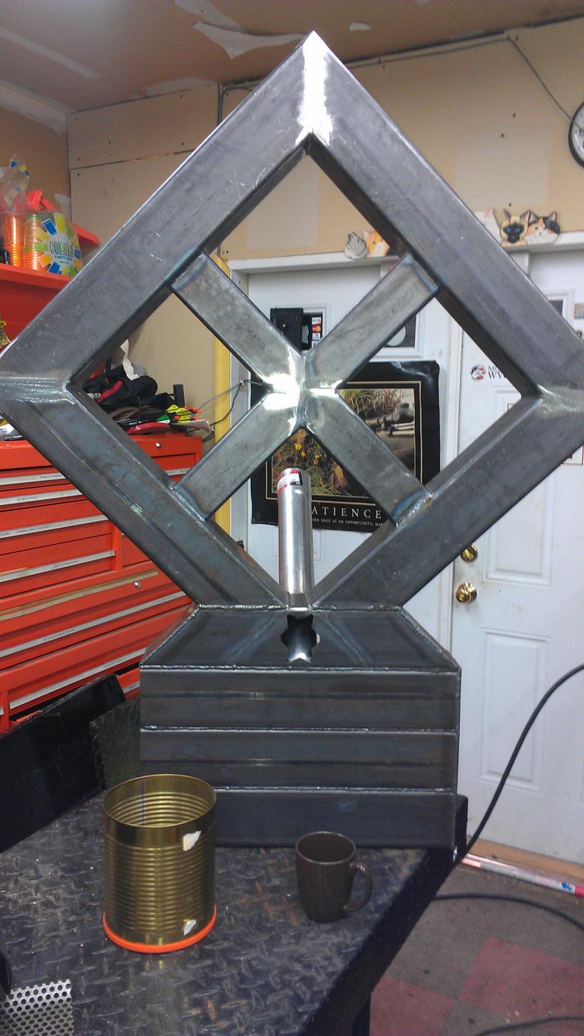

    Default New stove in process
    Can't find what you want for a price you think is fair? Build it yourself.
    Gravity fed, no electricity required pellet stove, Version 2.0.
    If I'm lucky, I'll be able to fire this puppy up either late today or sometime tomorrow.

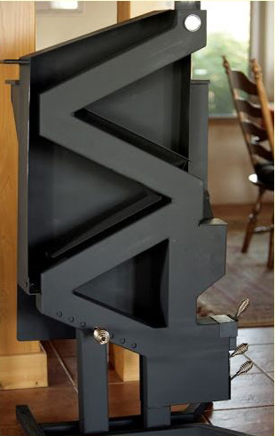

    Interesting design. Looks something like a Wiseway. How big is it?

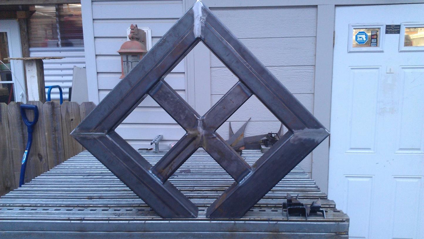

    We'll just call this one the "Rightway" stove, since my first version hasn't filled any homes with smoke. This version doesn't seem to be much different than the first, so I'm not too concerned with burning anything down.
    Outside of square tubing, not really the same thing, although the owner has offered to take my money as royalty payments.
    Right now almost 49" tall, and just under 40" wide. . Stand will bring it to 60", and the side shielding will move it out to about 42".
    initial burn was yesterday. Fired nicely, clean burning, no visible smoke at the stack.
    https://plus.google.com/u/0/photos/1...64994425379044
    Gotta build a stand for it today. The PP205S has been the perfect machine when coupled with the little Lincoln 3200. TIG for the small stuff, the MIG for the long seams on the combustion chamber.

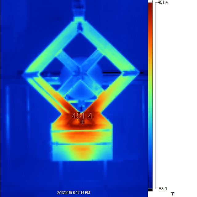

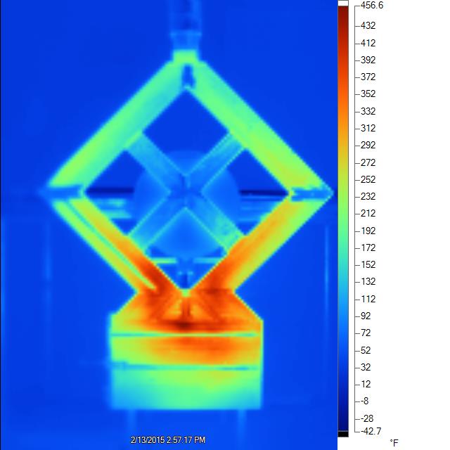

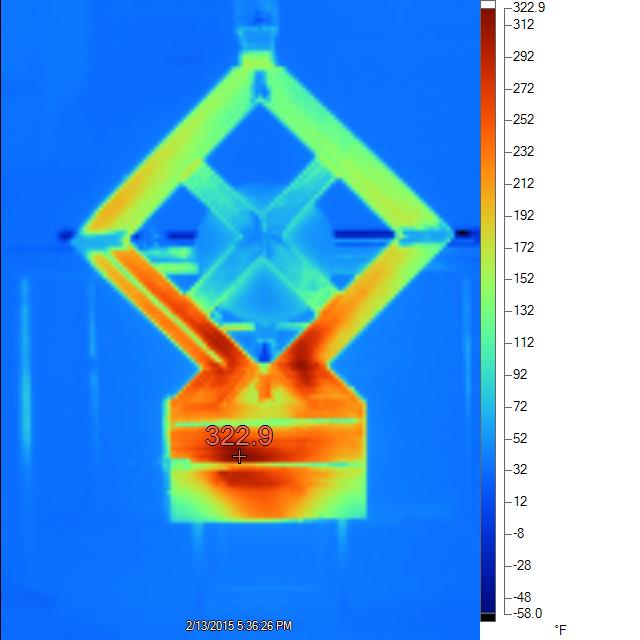

    It's working.
    Still tuning, but it'll heat my house as well as the other one.

    The diamond shape one is 'industrial' heat; shops, garages, renovation spaces where you can't use propane/nat-gas heaters.

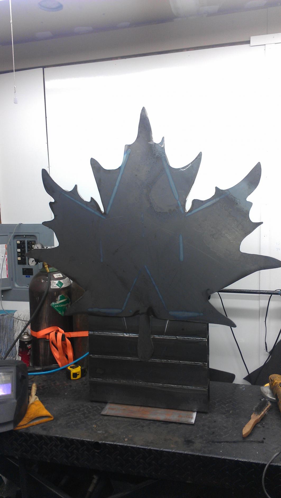

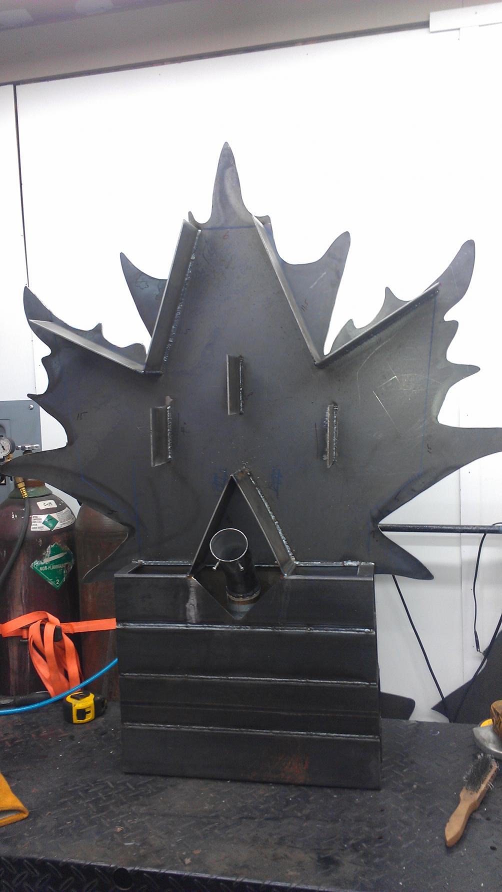

    Version 3.0 front and back cut.
    All the pieces except the 4" strips are cut to size.
    Welding to commence shortly.
    Maple Leaf pellet stove coming up!

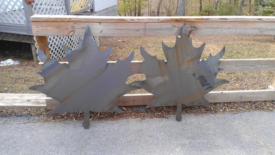

    The Canadian government needs the revenue, so you will have to pay big time royalties for stealing your design off their flag.
    Our Maple Leaf is red.

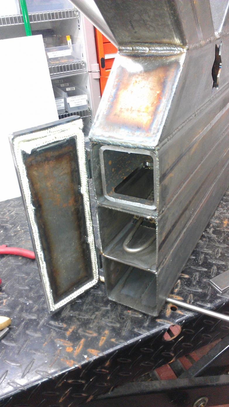

    Version 2.0 no longer belongs to me. The design was given to a gent down-under.
    What he does with it, and where it's built, ain't my business.
    And the fun begins!
    All internal welds with the lil' tyrant (Lincoln 3200) and all the externals will be done with the Everlast TIG.
