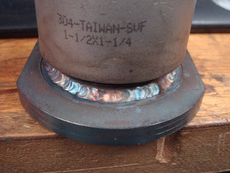

I needed a part for a project, but it was backordered with no ETA. Time to make a substitute.
I had a stainless pipe nipple to use for one part, but only carbon steel for the other. Weld the two with TIG and 309, then put it in a coupling to machine it to size.
Here is what I needed.

And here is my solution from parts.
