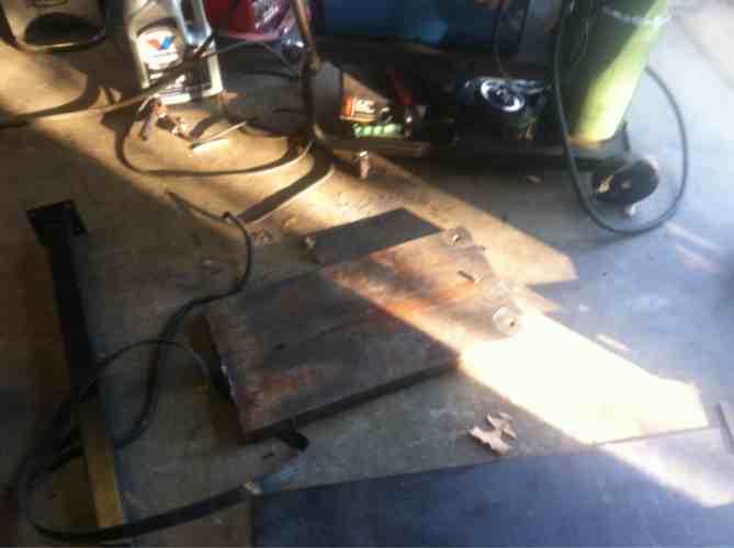

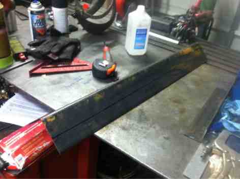

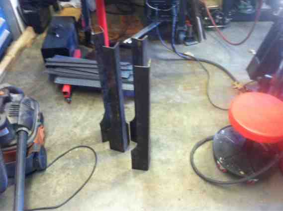

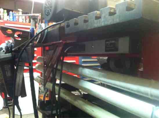

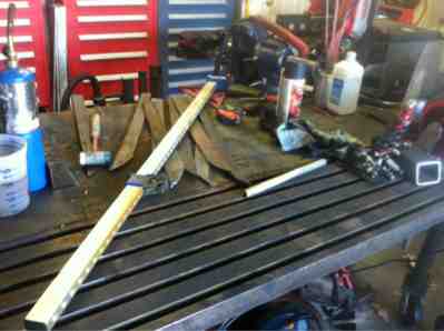

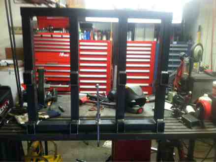

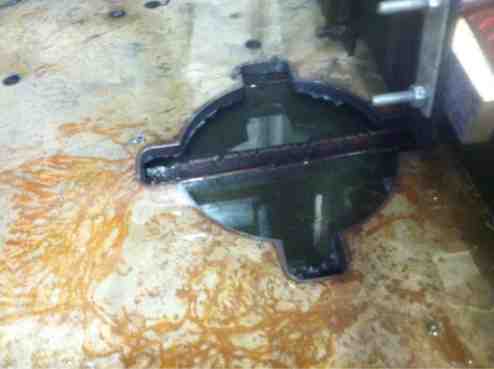

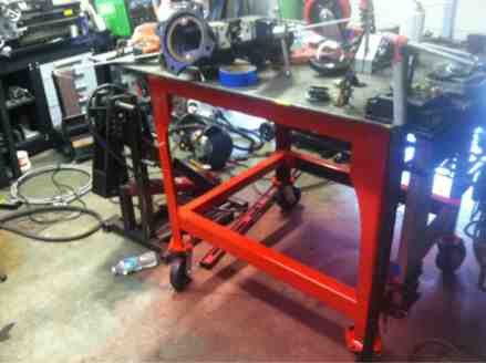

    I decided to to a over haul on my welding table, right now it is 3'x6' and I'm gonna make it 3'x4' to gain some space back in the garage one section is 3/8" oiled and pickled plate the other part is a t-slot table from a big knee mill, I am going to incorporate the receiver style accessory ports and possibly cut slots in the plate like the jmr table. All I have done at this point is rough out the legs

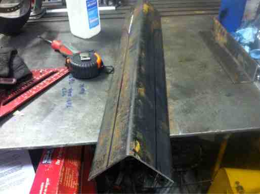

    To make the legs I cut apart a 4x4 left over from a project

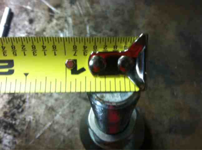

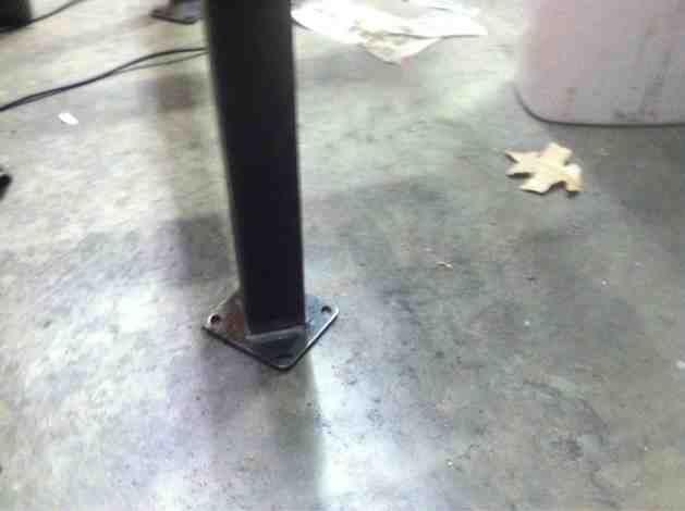

    Leveling feet I am going to use

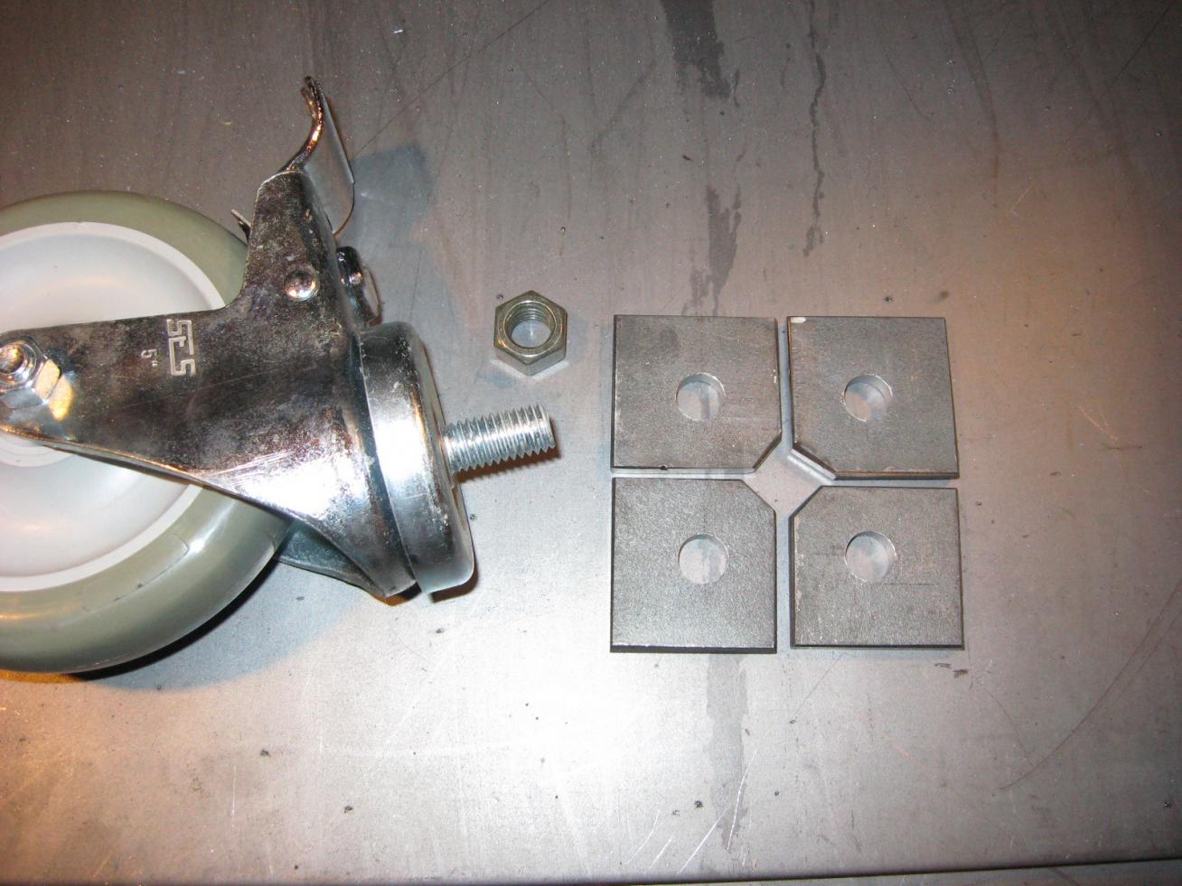

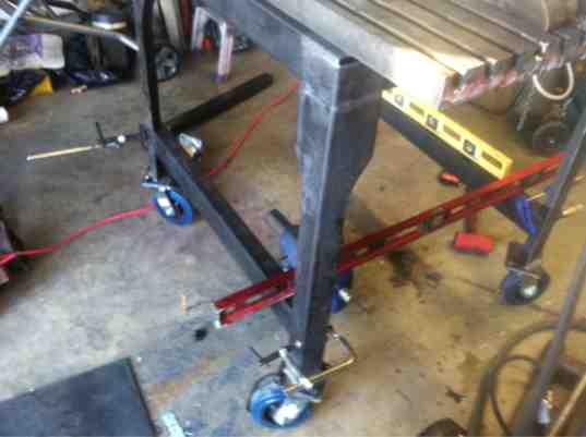

    Why not put it on locking casters so you can roll it out of the way when need be ?
    I use these 5" total locking ones on my welding table... 300lbs capacity each and cost about $7 when I bought them a few years ago. Weld a nut onto the backside of the mounting tab and you can level it with a washer if needed.

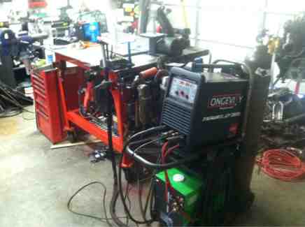

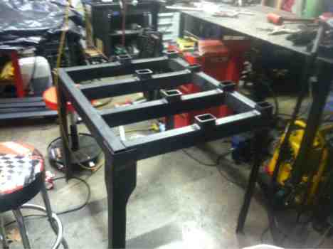

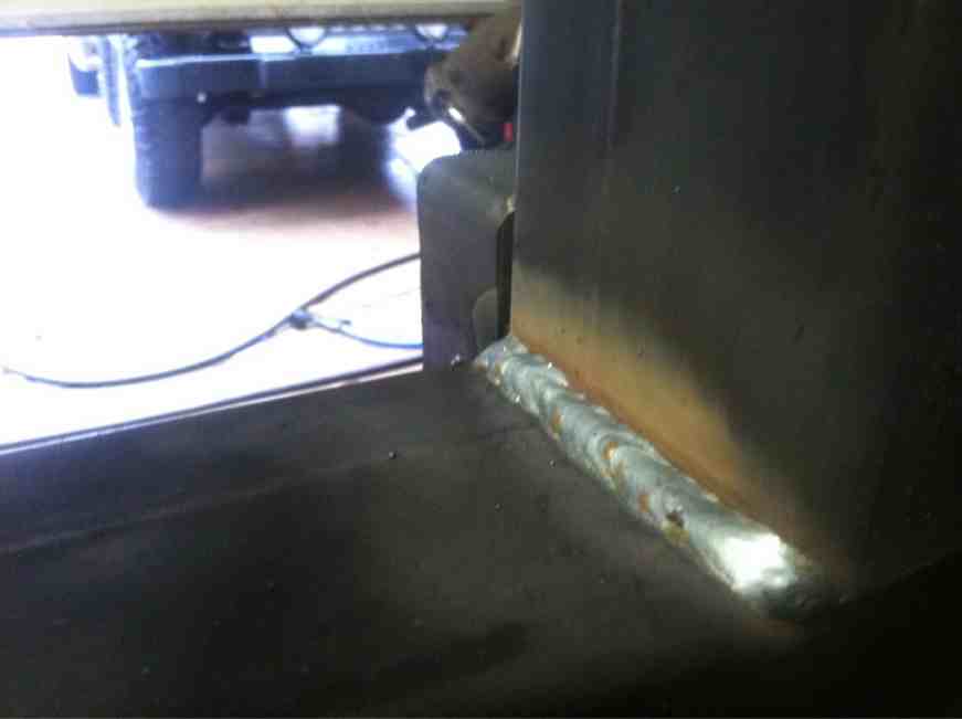

    Table progress

    Almost doneClick image for larger version.

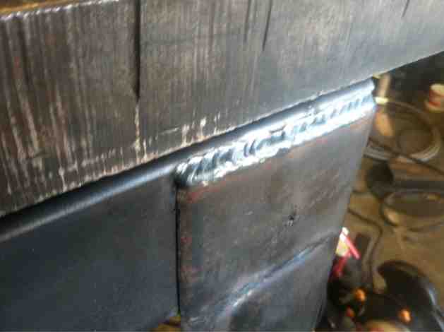

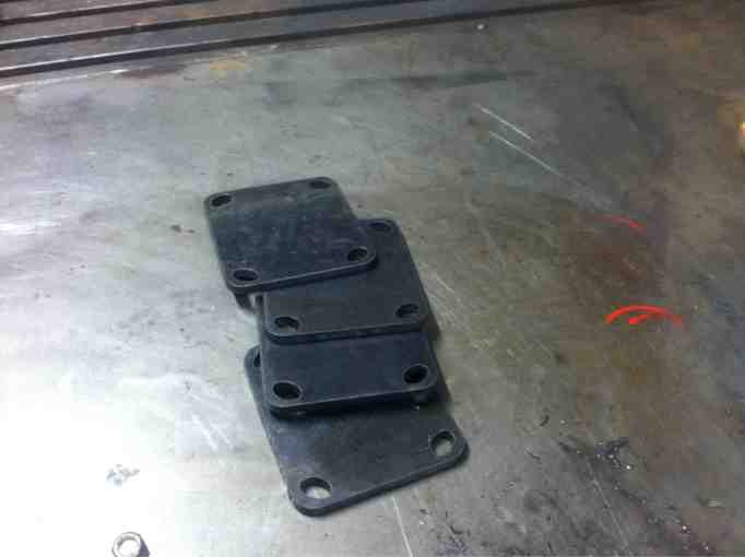

    Caster plates cut from 1/4"

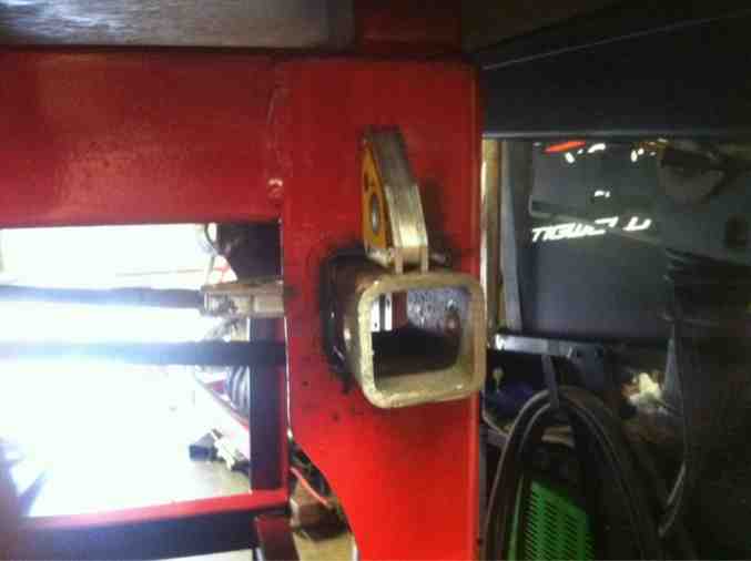

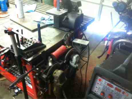

    Started building accessory ports

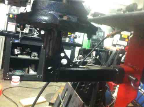

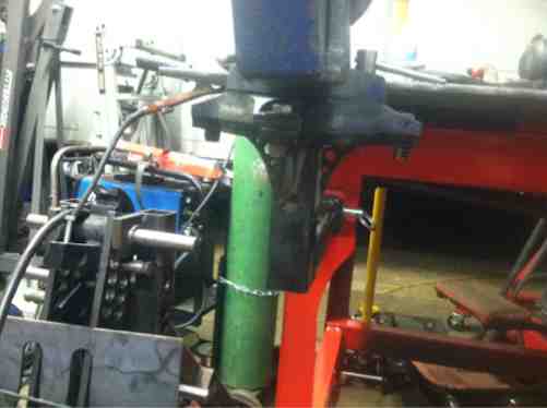

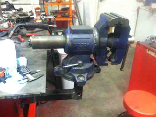

    Vise mount

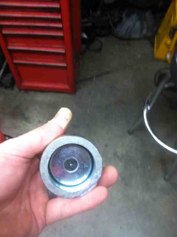

    Made the vise greasable

    Made gussets for the vise mount

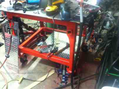

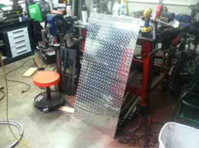

    Picked up aluminum diamond plate for the lower shelf
    LONGEVITY 250EX Tig
    MILLER 211 mig w/spool gun
    SMITHY 1324 mill/lathe
    60 gal. 7.5 hp air compressor

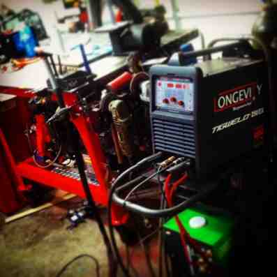

    Table progress and added 4' led lights
