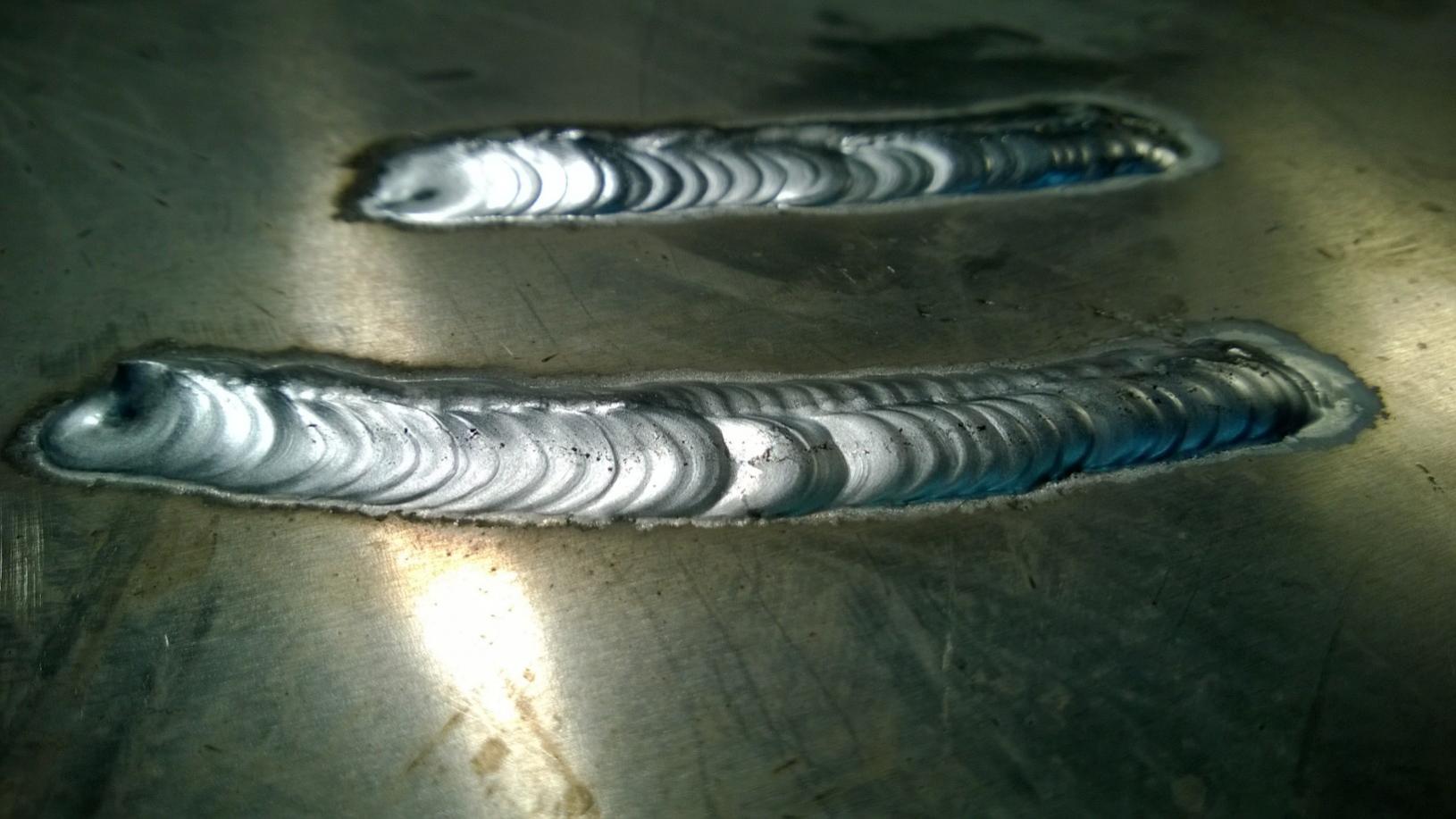

    rambozo, I am a ### sometimes... thanks for straightening me out! I did not get a manual with the machine, I went through the box again and did not see one. I did get it up and running easily once I straightened it out... I put down some crappy welds, albeit seemingly solid. The aluminum was newish, but dirty. I do formally apologize to everlast for turning into the hulk! hahahha
    I should add I have never tig welded so bare with the lack of conformity and straightness.. these are my first filler rod ever.

    No problem, glad to see you are up and running. You can download your manual HERE. The online manuals are usually better than what comes in the box anyway. Aluminum will also show the most issues from any residual moisture in your argon line. So it might take a little while to purge the last of it. The bottom weld looks like it might have some of the tell tale pitting from damp argon. For a first try they look very good. It's all about practice. One tip, slowly back off the amps at the end of the weld and add a little extra filler. That will get rid of the crater at the end. End craters are where cracks will start, so you don't want them.

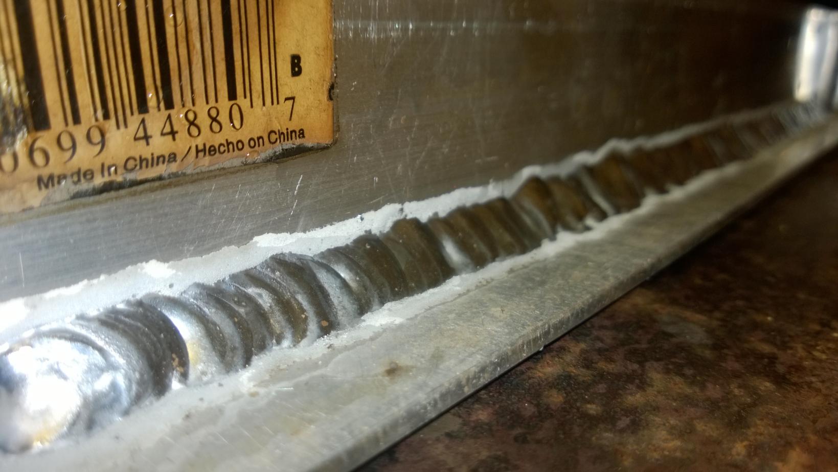

    first fillet weld ever with tig. didn't clean the material....
