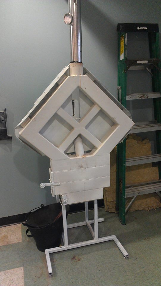

    The current batch of 'stuff' to be built with my new PP205 will be more stoves. Not just any stoves, but gravity fed, no electricity needed pellet stoves with a bit more than the 'box' shape. Right now the shape is an open diamond, with 'runners that meet in the center. Next up will be in the shape of a Taro leaf. How about a maple leaf....that's in the works as well.

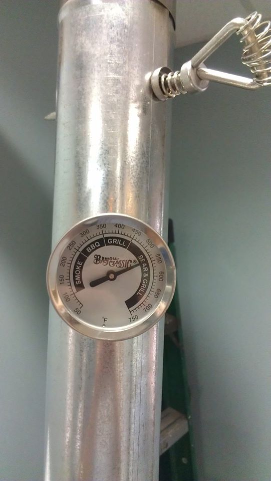

    The diamond one in the basement is, right now, making a disappointing 550F at 1/2 draft with the outside air nearly closed. I accidentally left the draft and air full open after I lit it...and nearly ran myself out of the basement. It was pushing 750F before I got it shut down a bit. Just a prototype of sorts, to make sure of the gravity feed worked without burning my house down. A week of outside running, a month of living room running....and it's now at home in the basement. I painted it white to check flame spread...and to prove 2 things: that the fire goes where I figured it would, and that people should NOT paint stoves white! They get dirty so fast, and everything both leaves a mark and stains.

    Need to rearrange the flue pipe tonight. The 90' didn't fare too well with the draft. It's back to 2ea 45's and a length of straight and try it again. Too fast of an intake, and too slow of an exhaust...backs up smoke into the house. I'll throttle down the intake a bit as well. Turned into a rocket stove with well above the design temps of the double walled pipe. I was pushing 700+ stack temps if I left it wide open. Back to the drawing board!
