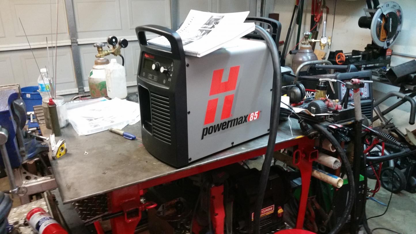

    Also got this for the plasma table
ID:	12849   Click image for larger version.

    What's wrong with the PP80s ?

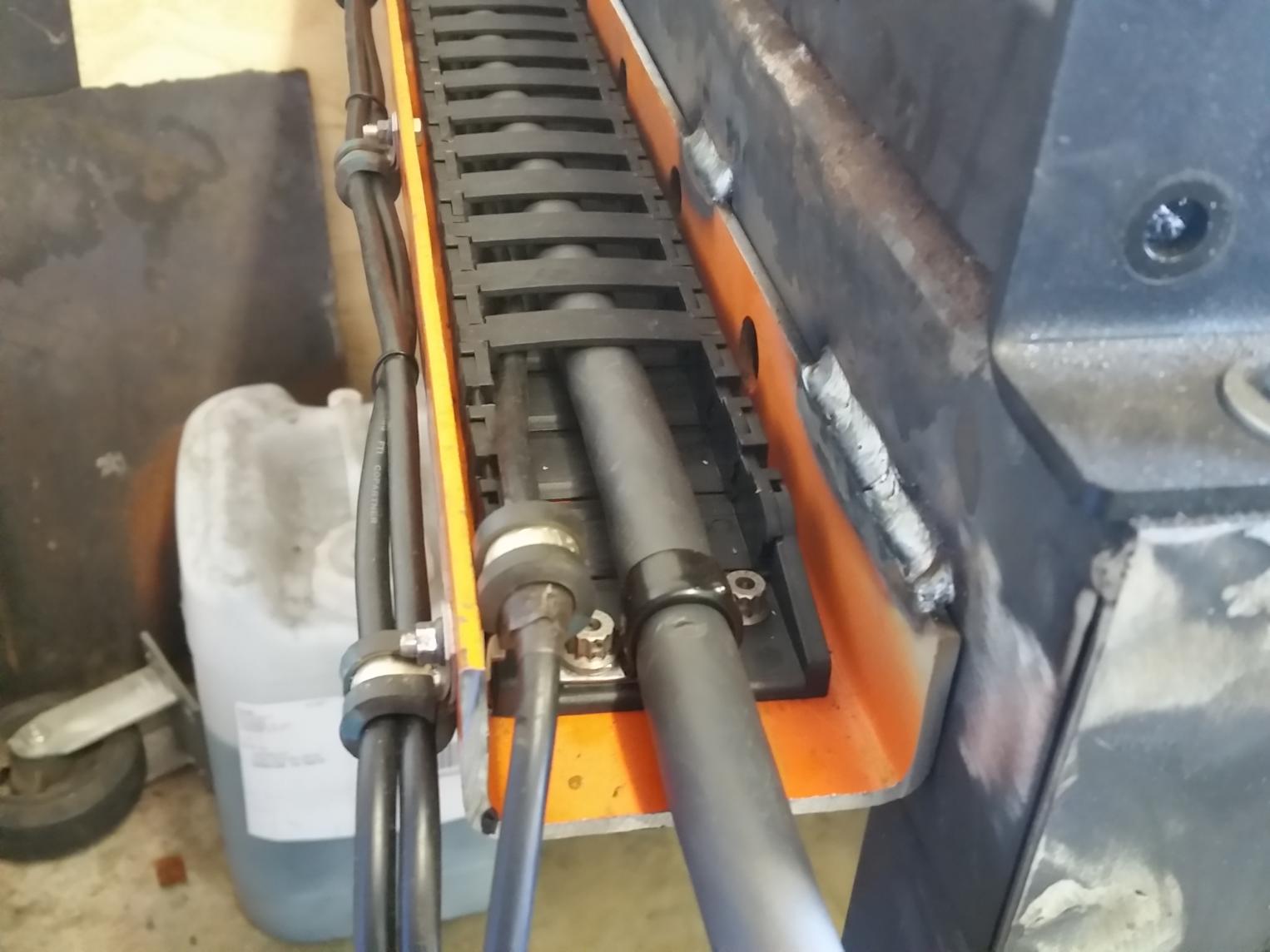

    Re-purposing a harbor freight press to carry my cable's on my torchmate
    LONGEVITY 250EX Tig
    MILLER 211 mig w/spool gun
    SMITHY 1324 mill/lathe
    60 gal. 7.5 hp air compressor
ID:	12914Click image for larger version.
ID:	12915Click image for larger version.
    Time for them to do a PP80c with a machine torch bundle like the PP60c.
    I agree but a torch head is far cheaper than a whole new machine. Just add the blowback torch head of your choice.
    At the moment they do not even list an 80A blowback machine torch much less a 100A for the PP100. Time to update the line. I'm sure they are available, but not listed on the website, yet.
    Could another brand be adapted ?
    I'm sure it could, but it would make sense for Everlast to offer a bundle if they want to make sales to the CNC crowd. The PP60c is great, but more power is always nice and with the PP80 and 100 in the lineup, having CNC packages for them just makes sense. While many hobbyist units adapt a hand torch, having a real machine torch would be a nice option for those that want to go that way. It keeps you from buying a torch that you never plan to use.
    The 100 is currently a HF start unit. We do have some newer 80 amp torches coming out from what I understand. At least they've been testing some in the factory.
    Apr 2015
    Ocala, Florida, United States
    7
    Any idea when this will be? I'm currently building a 5'x 10' CNC table and was considering the PP80S but if there isn't a compatible machine torch available for it yet I'll look at other options.
    I was able to get a S75 Trafimet Machine torch for my PP80 from Everlast Canada. Just call them and he got it. He even forgot who he ordered it for until I called him months later asking as my home modified torch crapped out.
