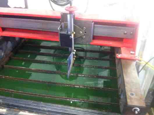

    Talked to mark at kci chemicals about a product called plasma green 1050, it's supposed to keep corrosion down and keep biocides from growing in the water table, it can only be bought in 5gal containers for $80 but 1 gal treats almost 30 gal.

    A biocide is what you want in your water to kill anything biological such as algae or bacteria. I'd add an ounce of copper sulphate solution to plain water and let it go at that. Cost maybe 25 cent.
    Yup, add a shot of soluble oil and no corrosion. Used that combo in many wet grinders.
    Plasma green 1050 showed up let's put it to work

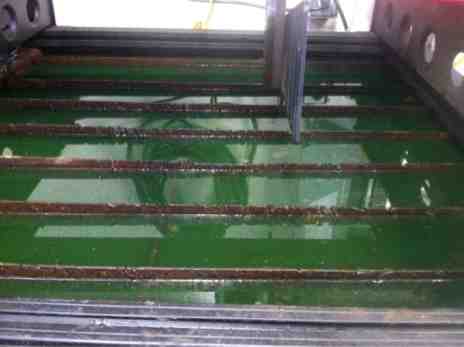

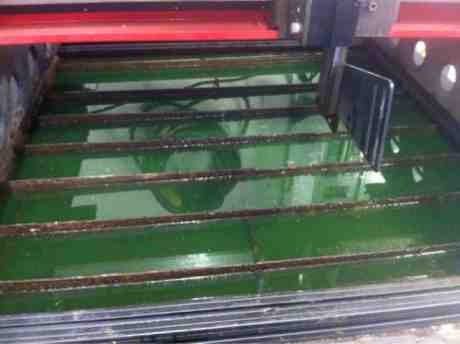

    Cleaned out the table and added 1 gal of the chemical

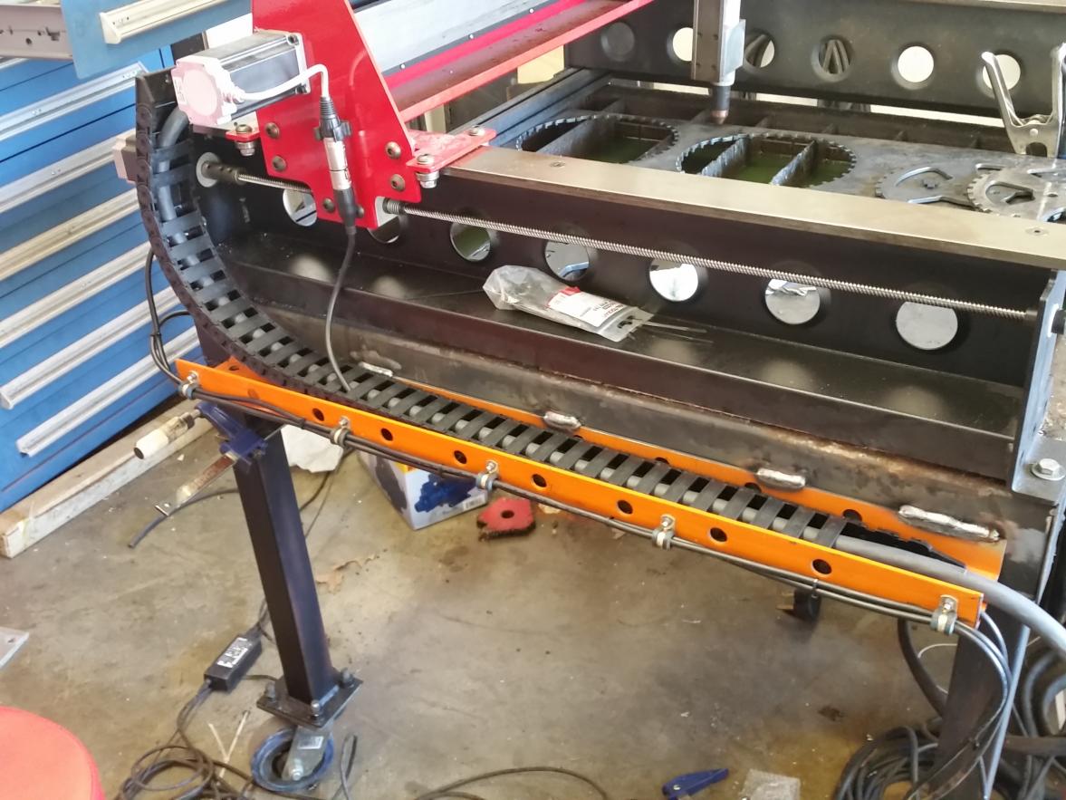

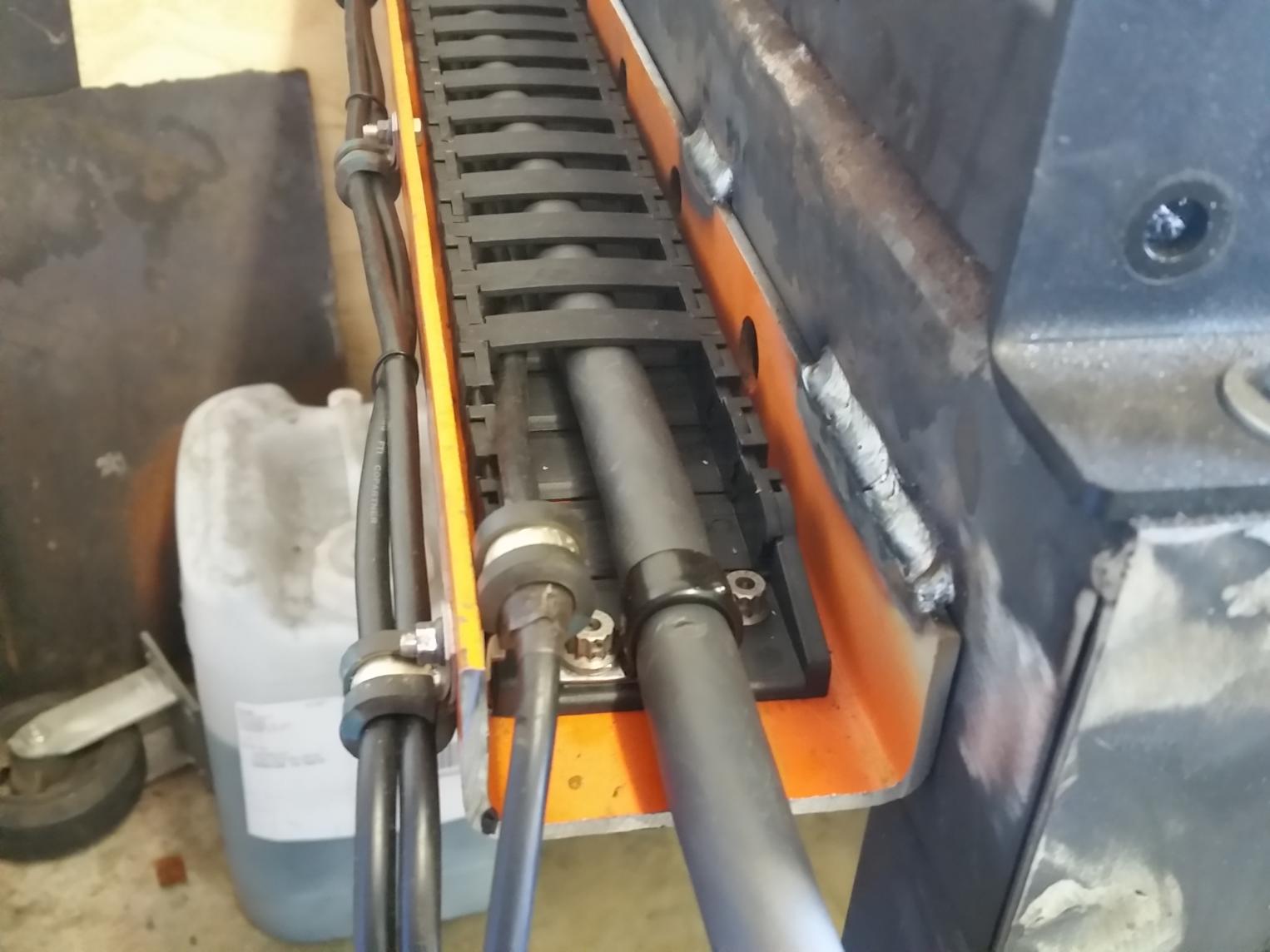

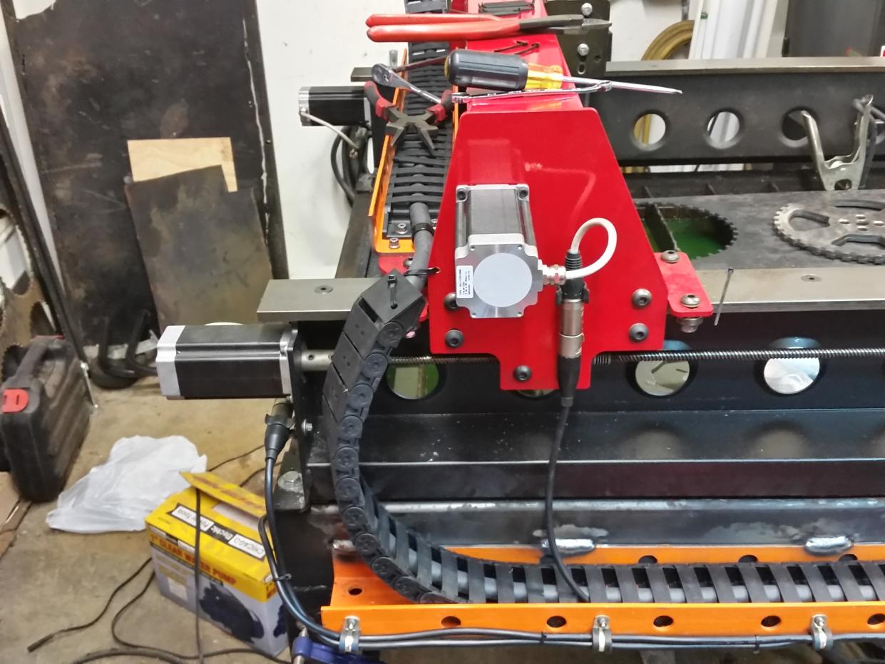

    Re-purposing a harbor freight press to carry my cable's on my torchmate

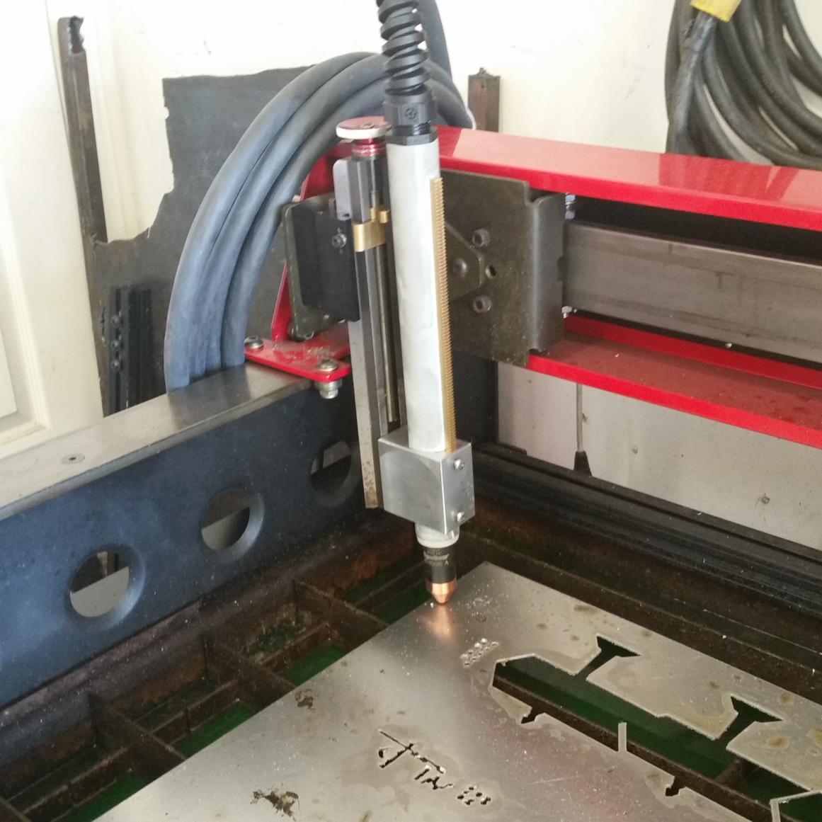

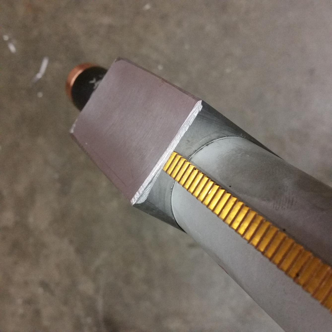

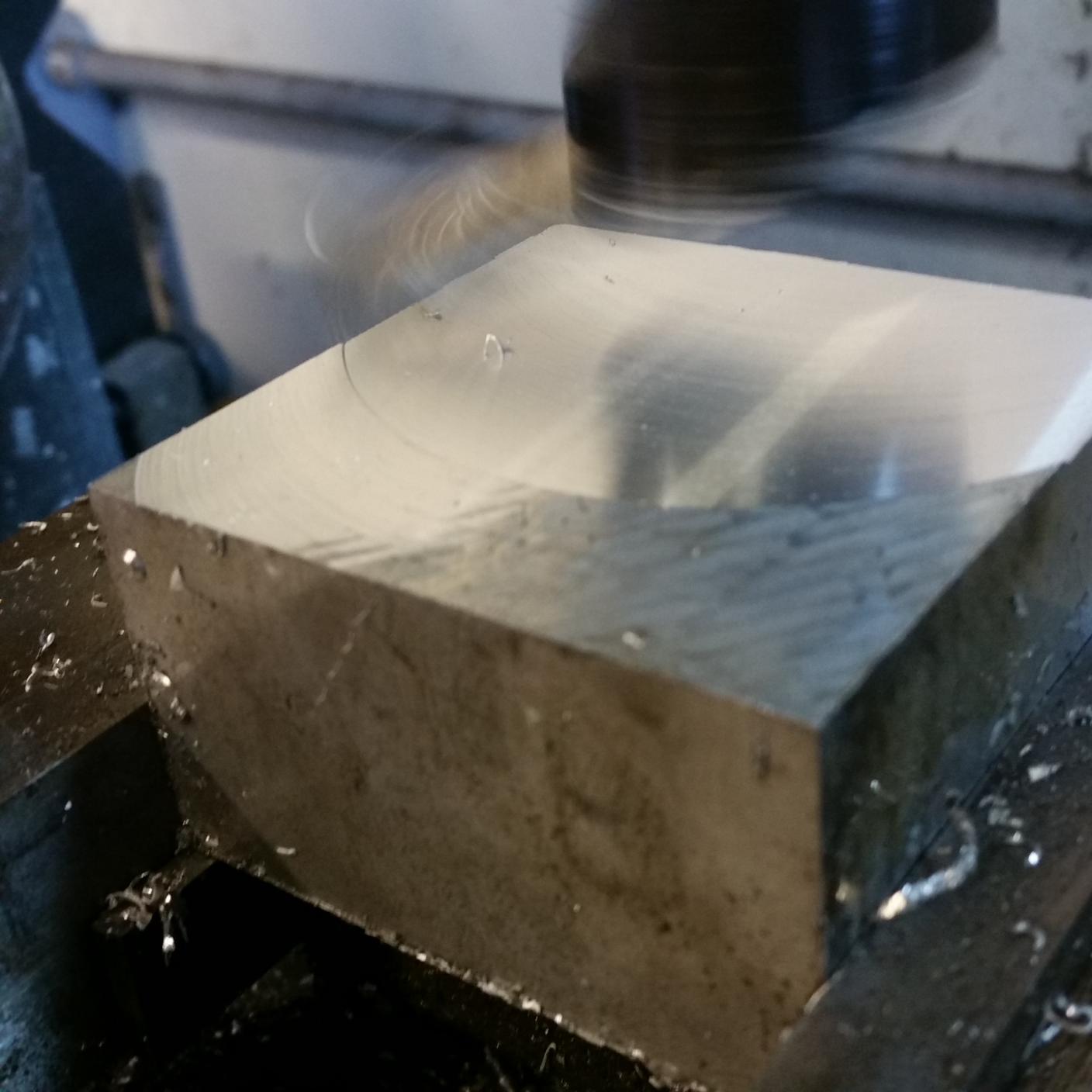

    Machined a torch holder from aluminum
