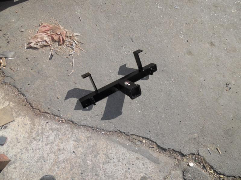

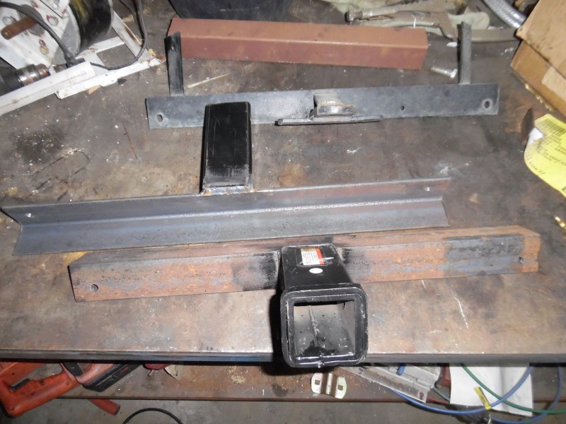

Dueling golf cart receiver hitches. Not for towing as much as for other hitch mounted accessories, like spreaders and sprayers, etc. Factory had a drawbar type unit, but the 2" is the common standard. Pretty lightweight as far a a hitch, but more than enough to do this job. Quarter by two angle, and some quarter by 2 flat bar for the bracing. Welded up with the FrankenMIG, this time. Added a couple of shackles for tie down points for easy transporting. First one all painted and installed. Second one I still need to fit the bracing and finish up on the other cart.
