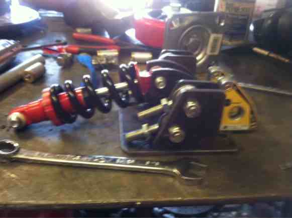

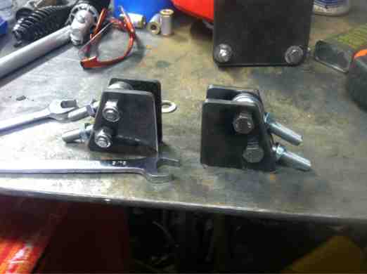

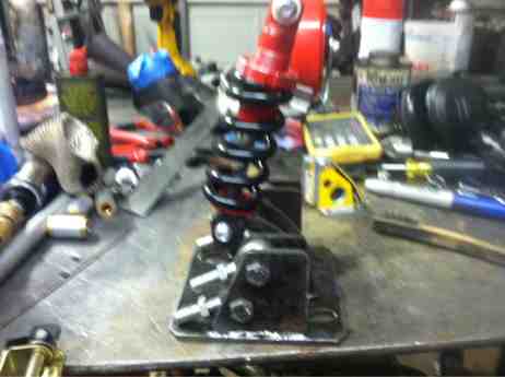

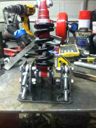

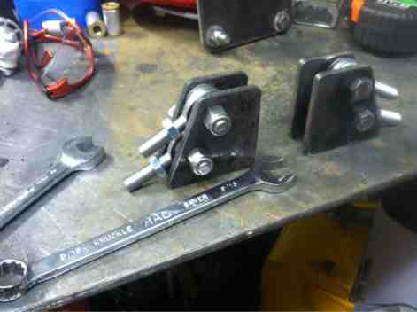

    So I have decided to use a rear shock from a mountain bike and build a 4 link suspension for my gate caster, some will say its over kill and going way to far but the tools are in the shop and I have the materials already do why not! Here are some shots of what I got done before thanksgiving took priorityClick image for larger version.
ID:	12584Click image for larger version.
ID:	12585Click image for larger version.
ID:	12586Click image for larger version.
ID:	12587Click image for larger version.

    Sounds like a winner. It's not overkill, it's art!
    Thanks rambozo

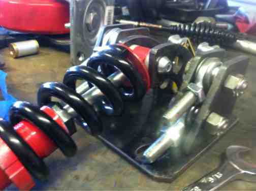

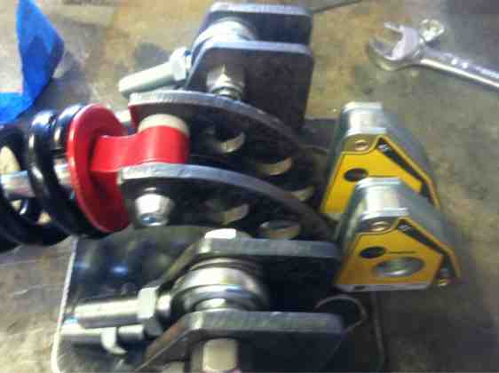

    More partsClick image for larger version.
ID:	12589Click image for larger version.
ID:	12590Click image for larger version.

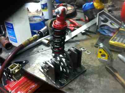

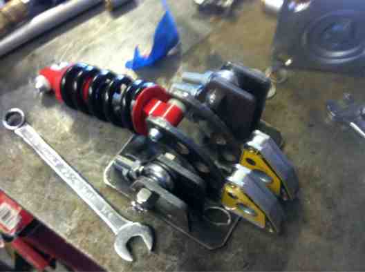

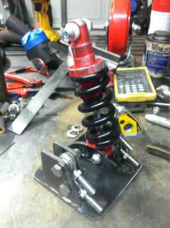

    Getting mocked upClick image for larger version.
ID:	12604Click image for larger version.
ID:	12605Click image for larger version.
ID:	12606Click image for larger version.
ID:	12607Click image for larger version.

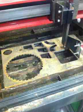

    3/16 steel I cut the pieces from

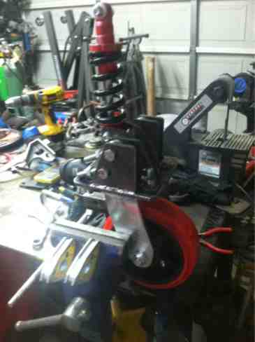

    Look with wheel

    If you have the tools, time and materials (and talent). Why not. Looks good so far.
    Thanks!

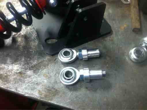

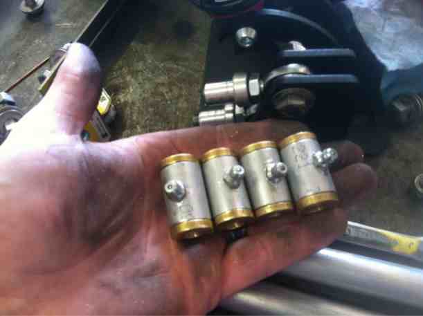

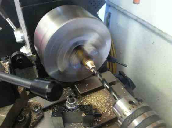

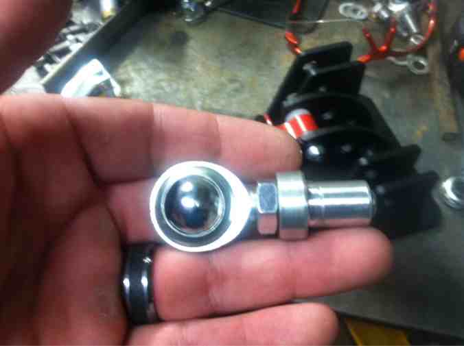

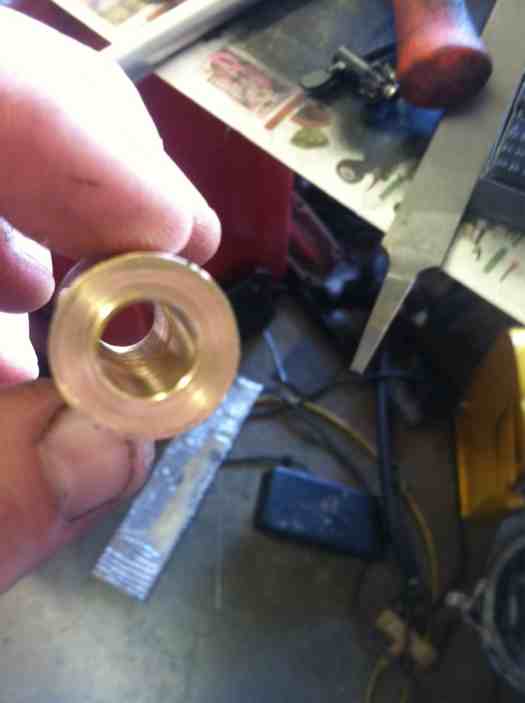

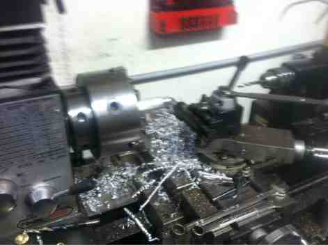

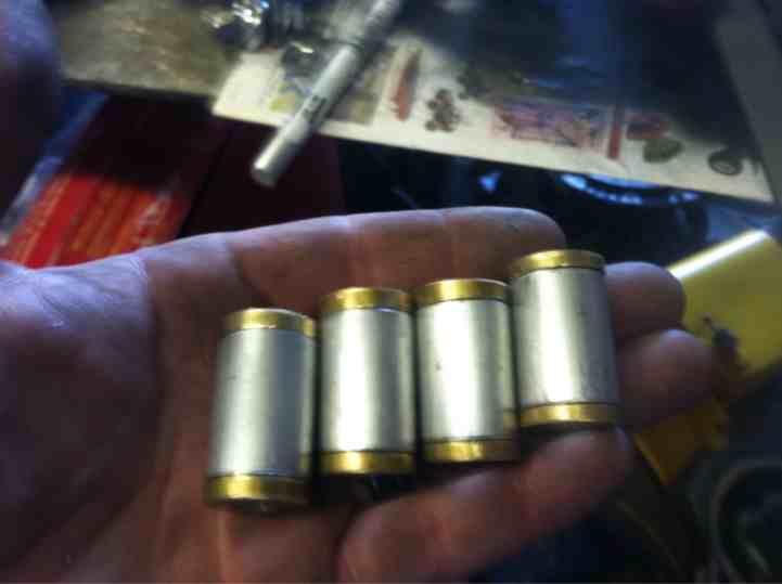

    Aluminum link inserts 3/8-24 thread
    LONGEVITY 250EX Tig
    MILLER 211 mig w/spool gun
    SMITHY 1324 mill/lathe
    60 gal. 7.5 hp air compressor
    Did you do left and right threads?
    Right handed threads
    LONGEVITY 250EX Tig

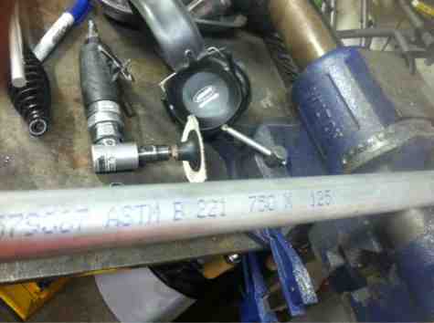

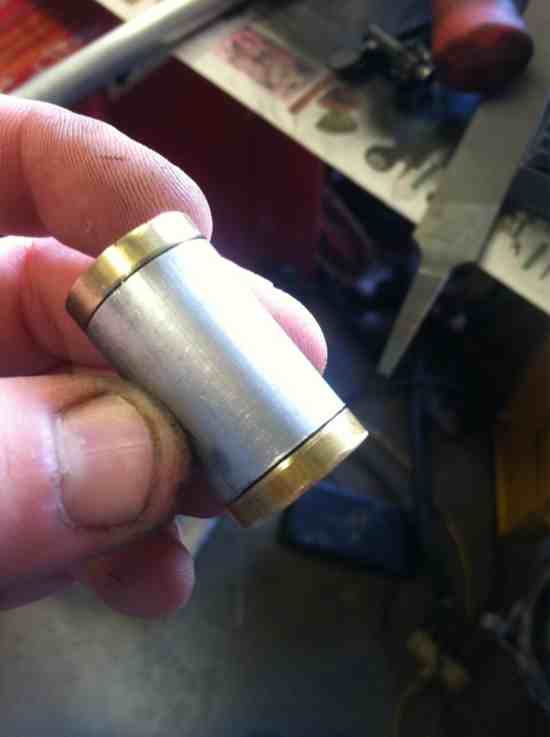

    Link material

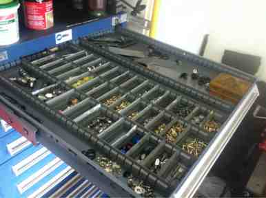

    Getting organized
    LONGEVITY 250EX Tig
    The organizing battle continues
