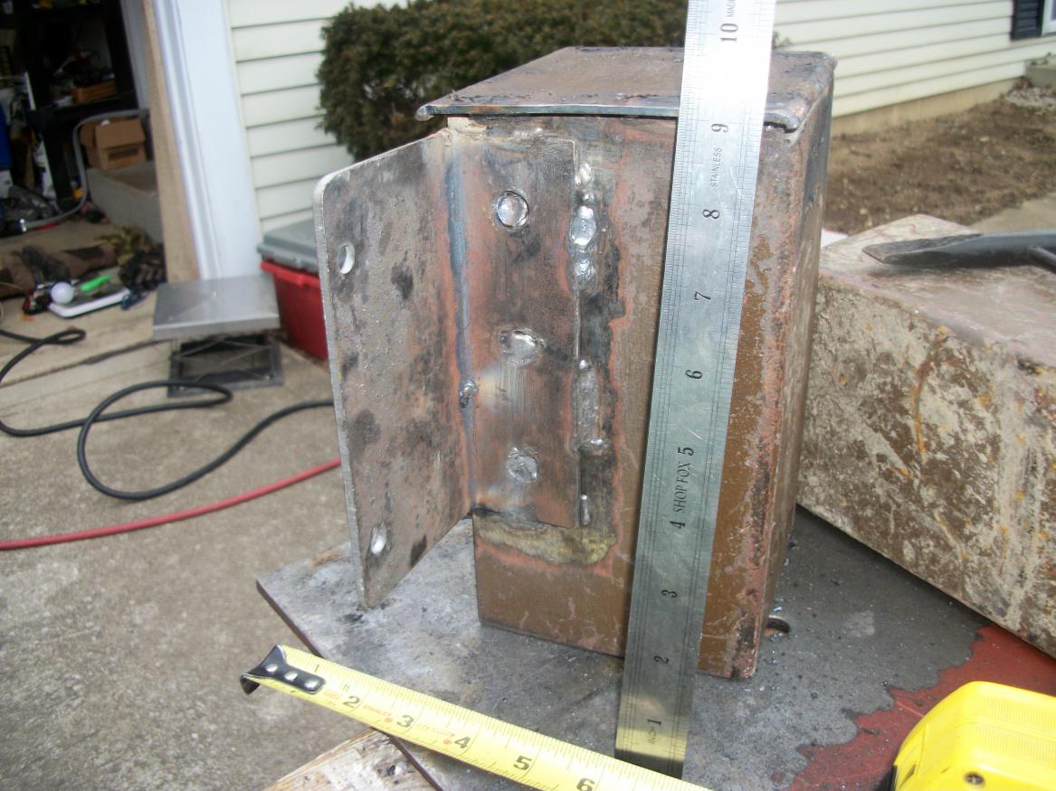

    Today the box for the VFD was fabricated.
    Photo #1. Nice clean edges of the 5"x5" 10 gauge tube after cutting.
    Photo #2. Assembled box, top, and mounting flange all welded together.
    Photo #3. Right side of the box so more of the mounting tang is visible. Three plug welds as well as a couple of lap joint bonds.
    Photo #4. Box mounted to drill press. The black motor mount was fabricated earlier in this thread.
    Photo #5. Test fit of VFD electronics. Mounting holes for the VFD as well as power cabling holes still need to be drilled.

    Quite a sturdy box. Be sure you meet the ventilation requirements of your VFD. They often specify to be mounted a minimum distance from vent obstructions. Is it passive or fan cooled?
    Aug 2014
    Westerville, Ohio
    72
    Cooling should be okay; the heat sink on this unit is *huge*.
