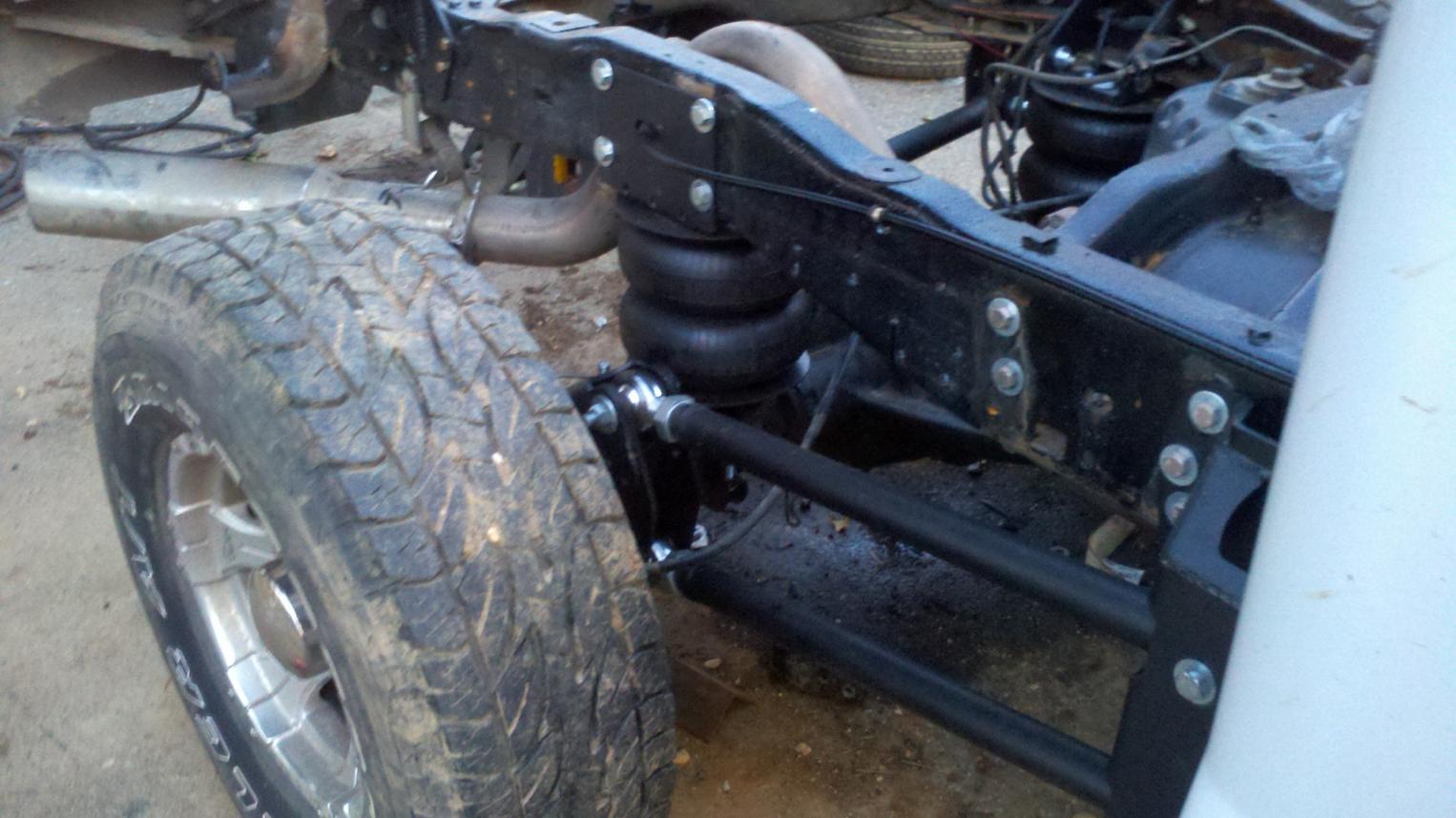

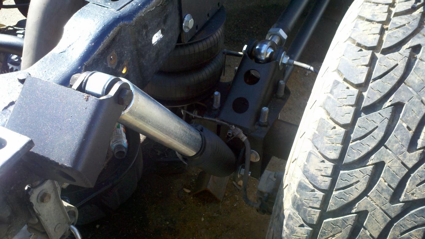

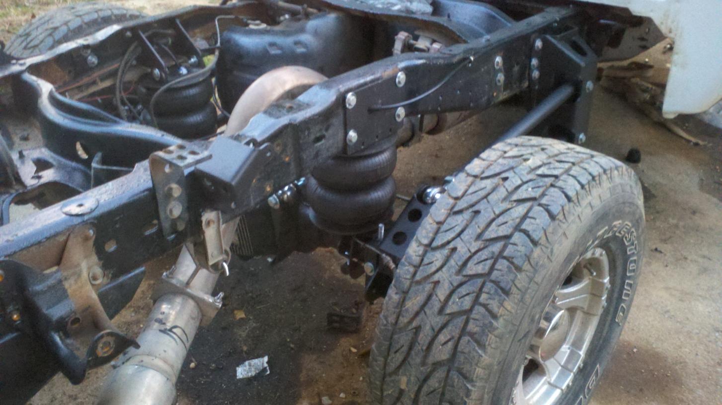

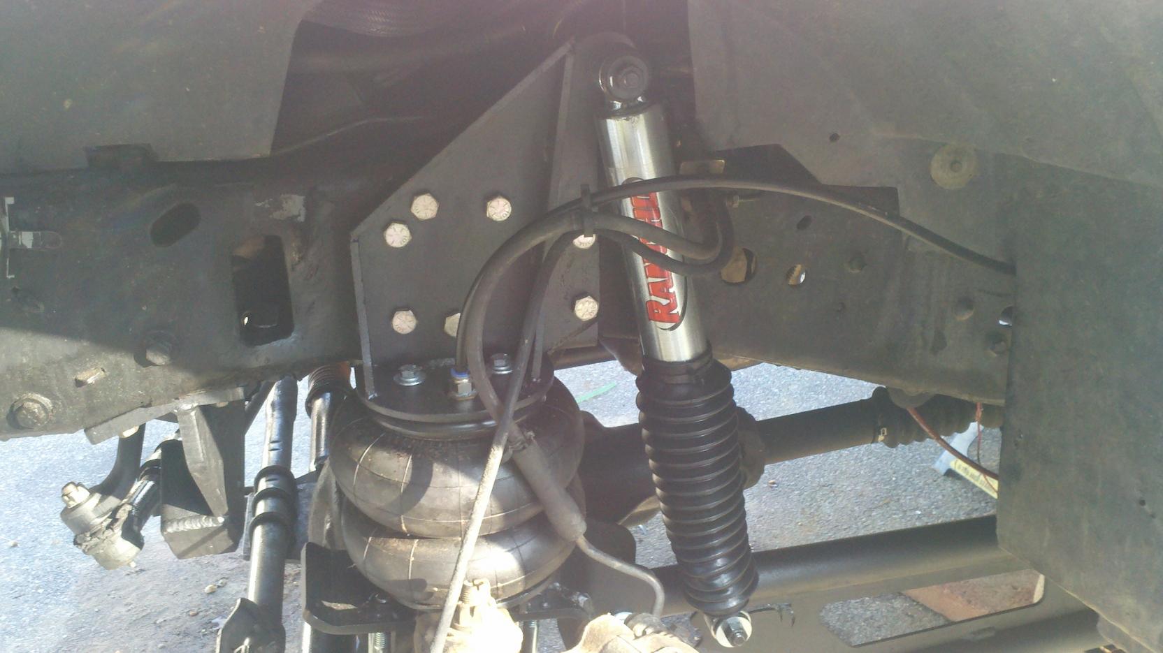

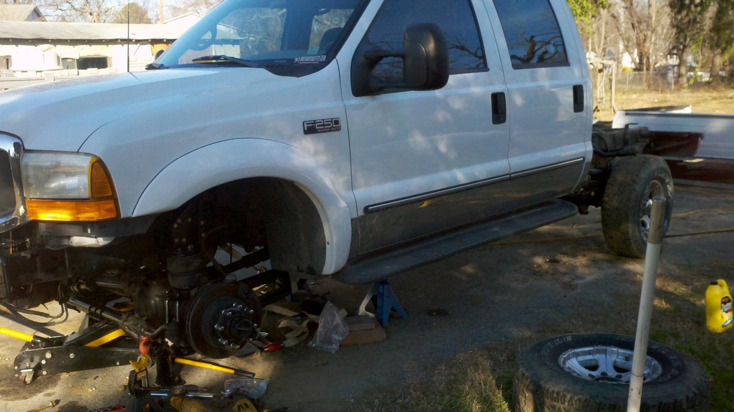

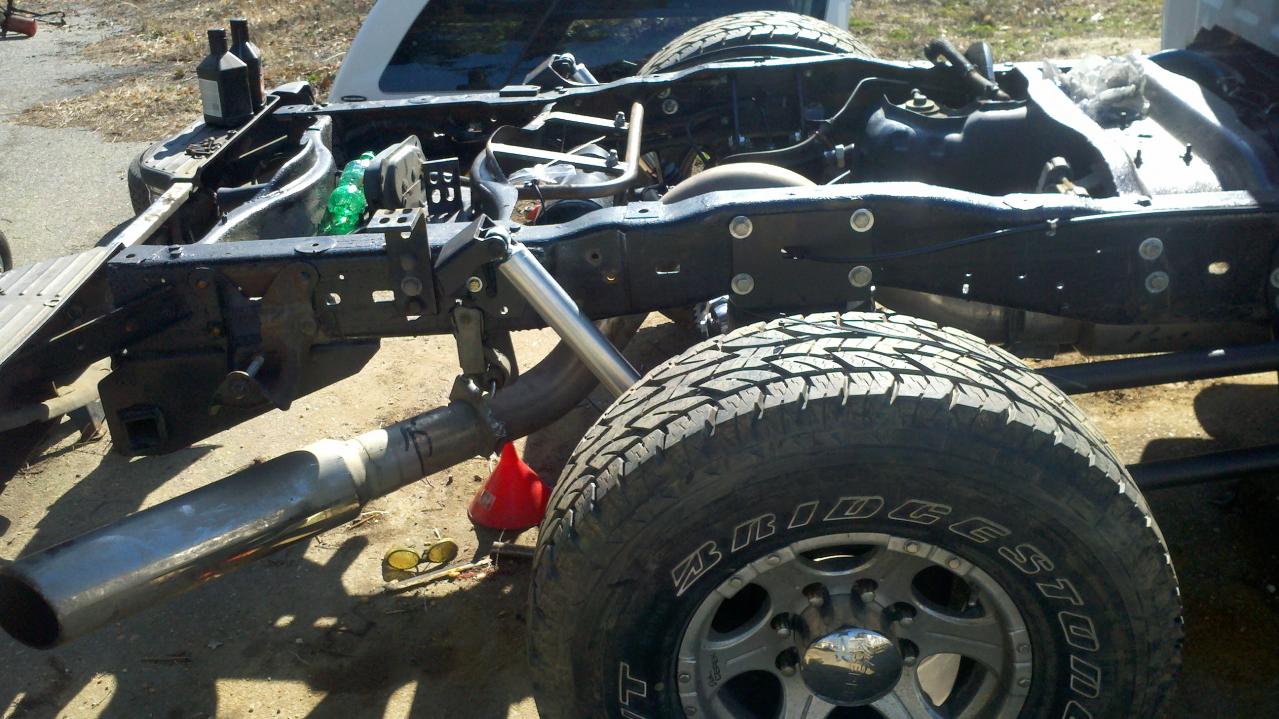

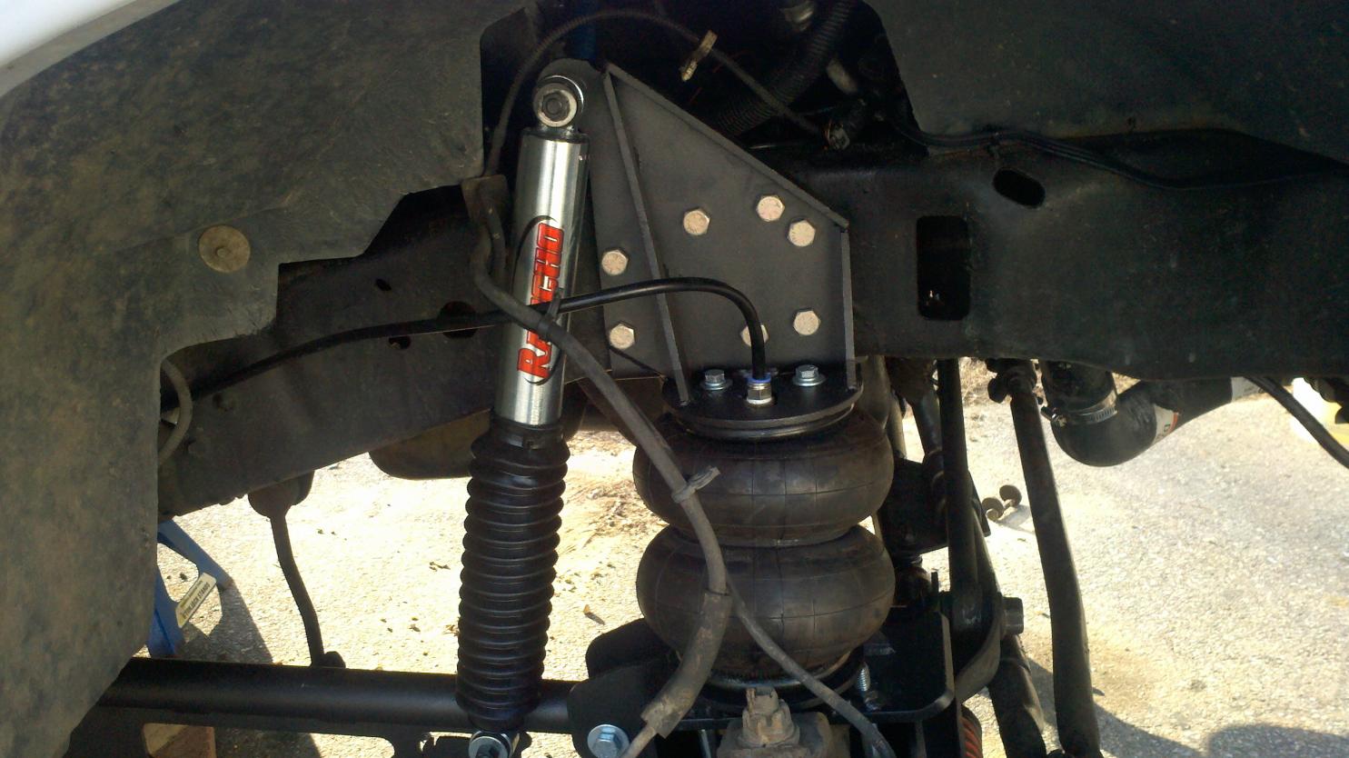

    I installed this in 2012 when I did the cummins engine conversion

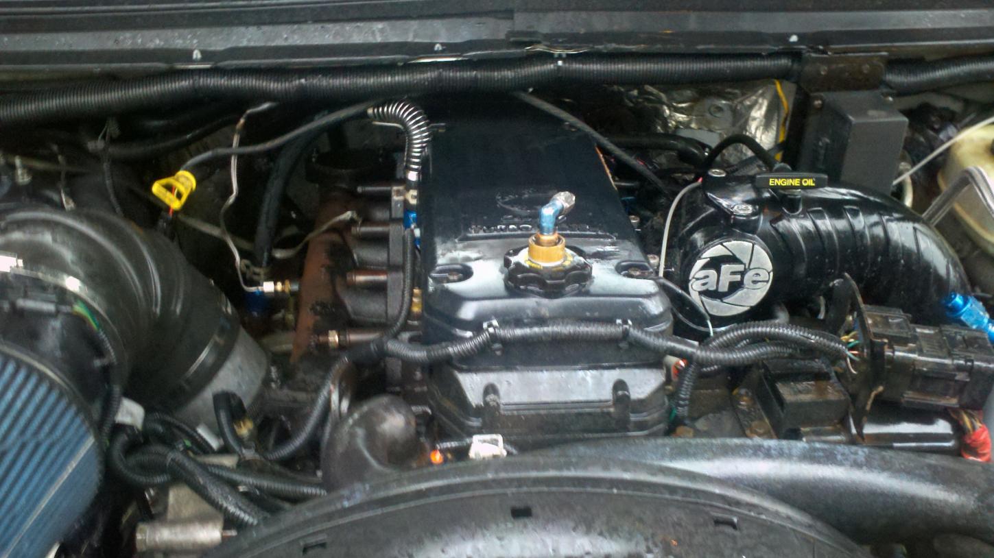

    Here is a shot of the cummins under the hood

    How do you like the air ride, did it turn out as expected ?
    How much power is the engine making ? Is there an engine conversion kit or did you fab it all ? What transmission are you running ?
    the ride is awsome, getting it dialed in it the hardest part for me. The engine is just over 400 hp and uses a variable turbo it took from a 2012 6.7 when the owner swapped it out, the exhaust brake functions when the throttle pedalis at 0% I am using the ford 4r100 trans, and I did fabricate everything but the trans adapter
