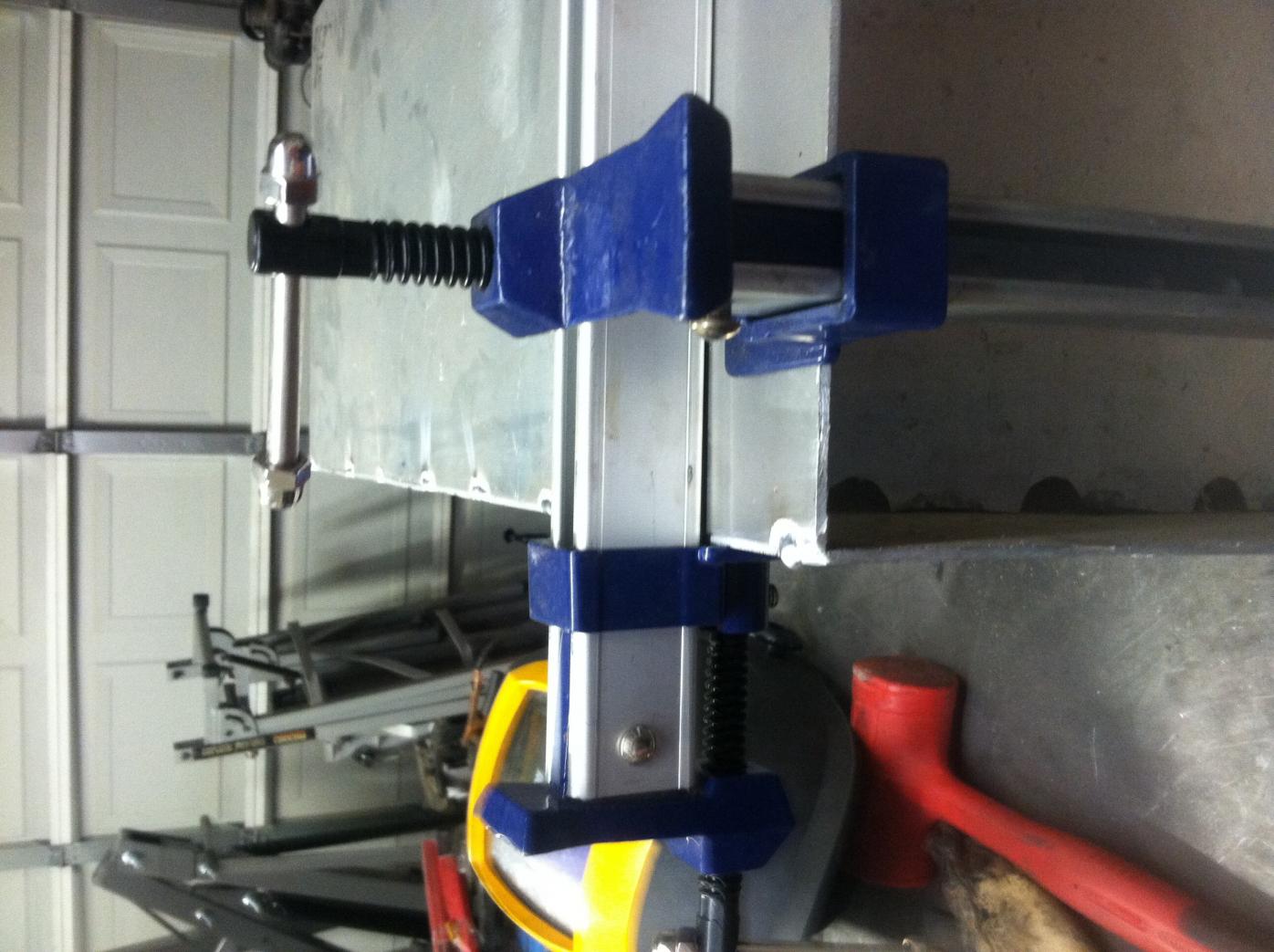

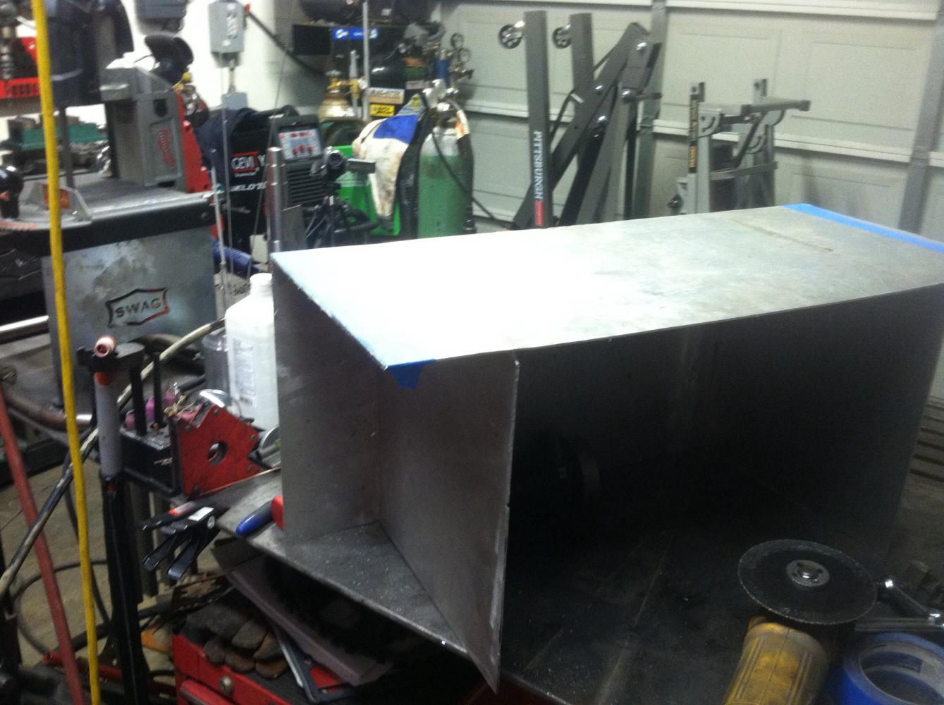

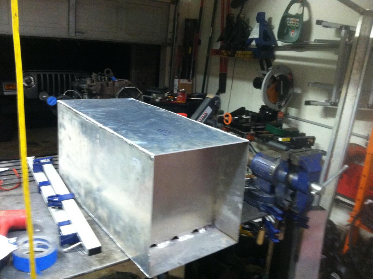

    Local guy needs a custom fuel cell for a hot rod he is building, so I started Saturday and this what I have so far

    Keep us posted on it, my son is going to build one for his mud truck. Do you have one of Jody's TIG fingers. Aluminum can get warm.
    I'm sure you know this but I will say it anyway. Make sure you check it for leaks with low pressure air and some soap suds. It is very easy for an aluminum weld to be porous. Especially if it is not extremely clean. I would check it with only a couple pounds of air pressure or you will buckle the sides.

    Are you building to an off the shelf bladder or having one custom made?
    I do have a tig finger, love it!

    Thank you for sharing your experience, leak test is on the list already

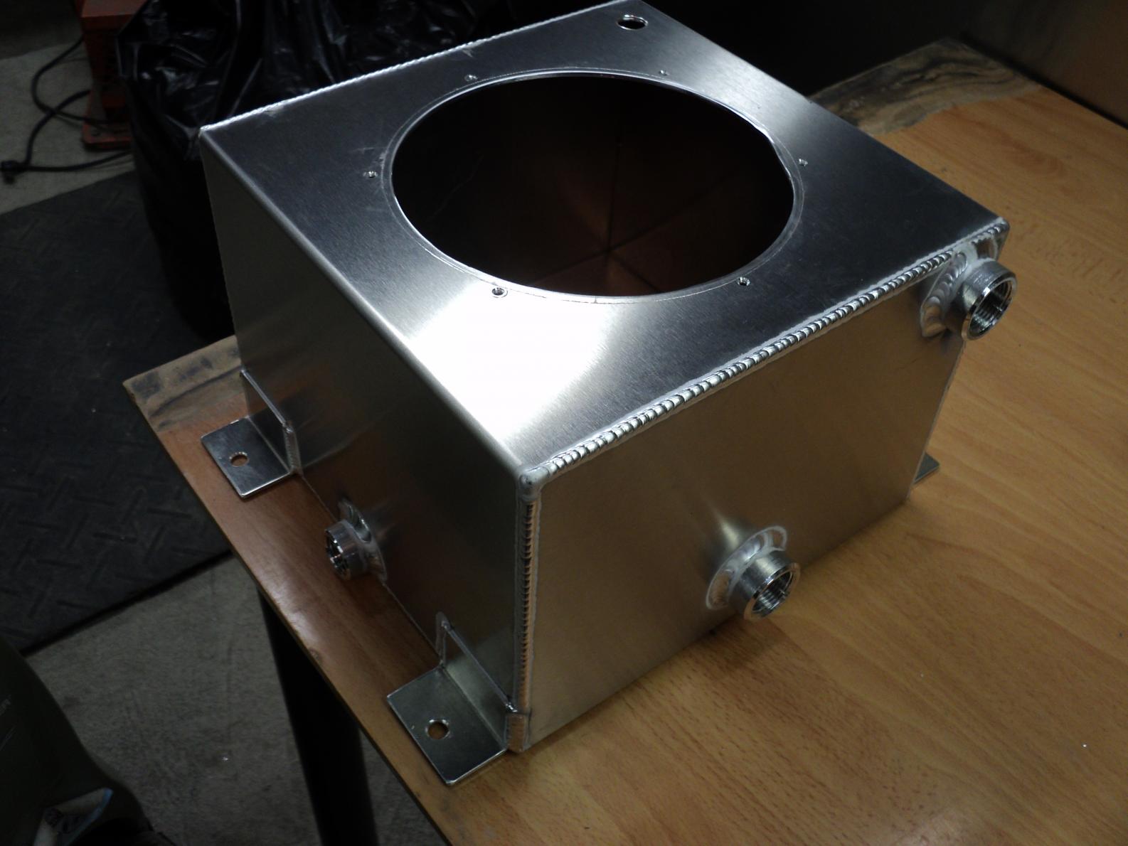

ID:	12950small fuel cell i welded a few years ago.
