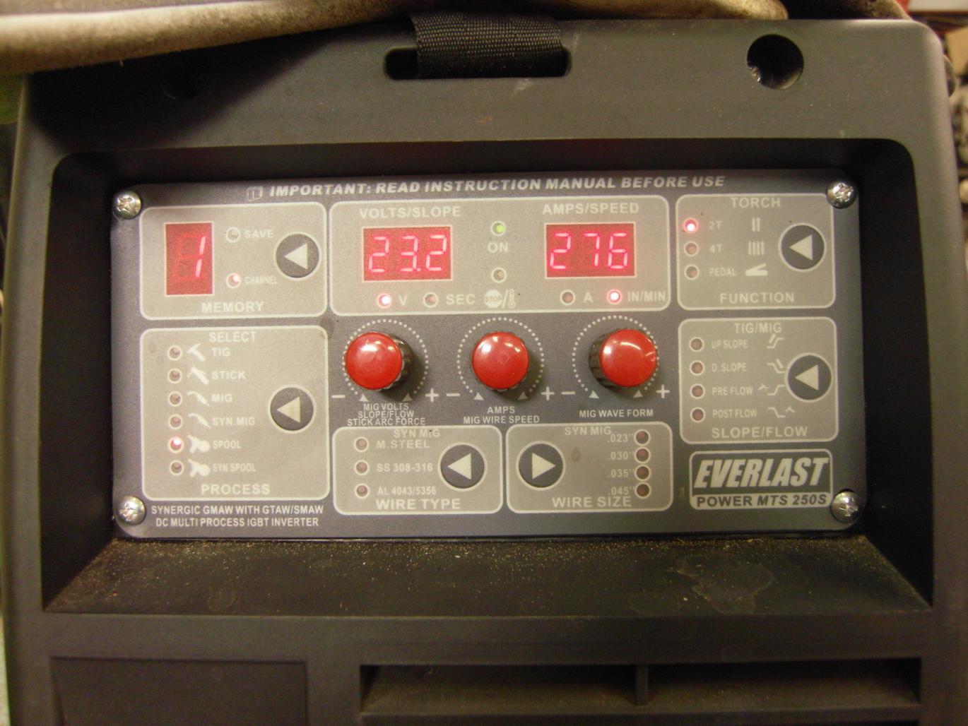

    Look at (http://www.everlastgenerators.com/fo...hlight=MTS250S) this is what I did with Yofish help and it works very well. Just did a test pass on a 3/8 to 3/8 before I do the weld on a flat bead truck later this week.
    I don't know if it will work on a iMig205 they don't have the option to run the wire feed from the gun but Yofish might be a help there. My MTS250S spool gun dose have that built into it so that was why I was able to mount the 30A to it. On my iMig250 you have to do it on the machine the spool gun dose not have a wire speed Rheostat controller in it. The 30A and the MTS250S Spoolgun use the same Rheostat 47 ohm.
Name:	30A to MTS250S A.jpg
ID:	12531Click image for larger version.
Name:	30A to MTS250S.jpg
