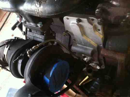

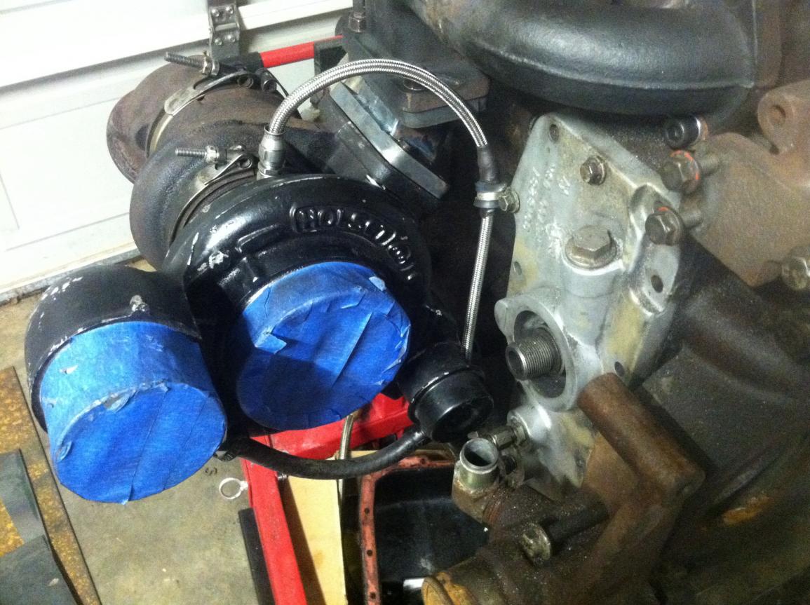

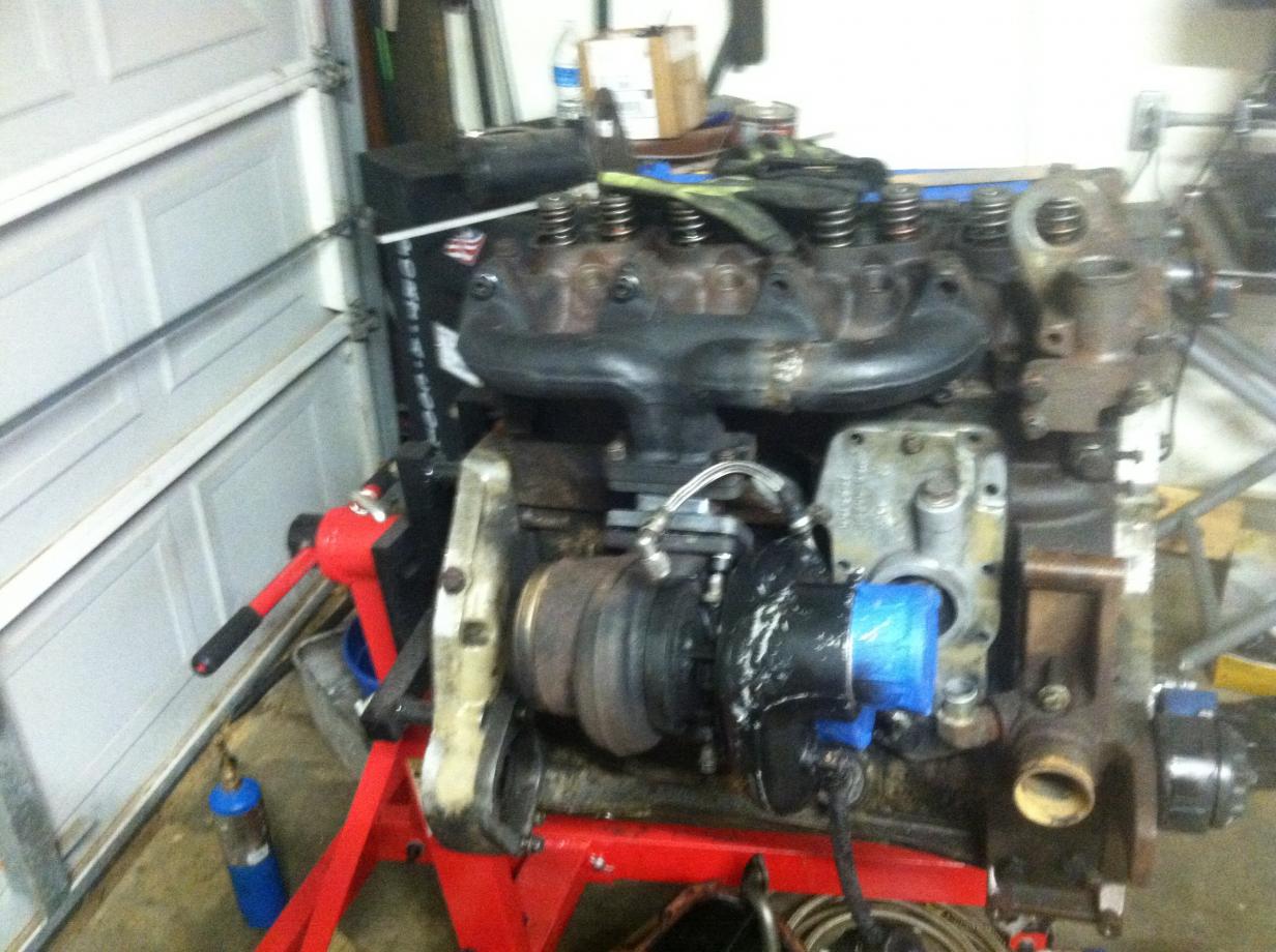

    Needed to angle the turbo away from the blockClick image for larger version.

    Test fit, looks like it will work

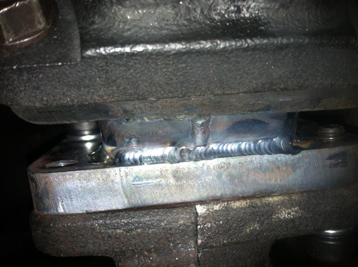

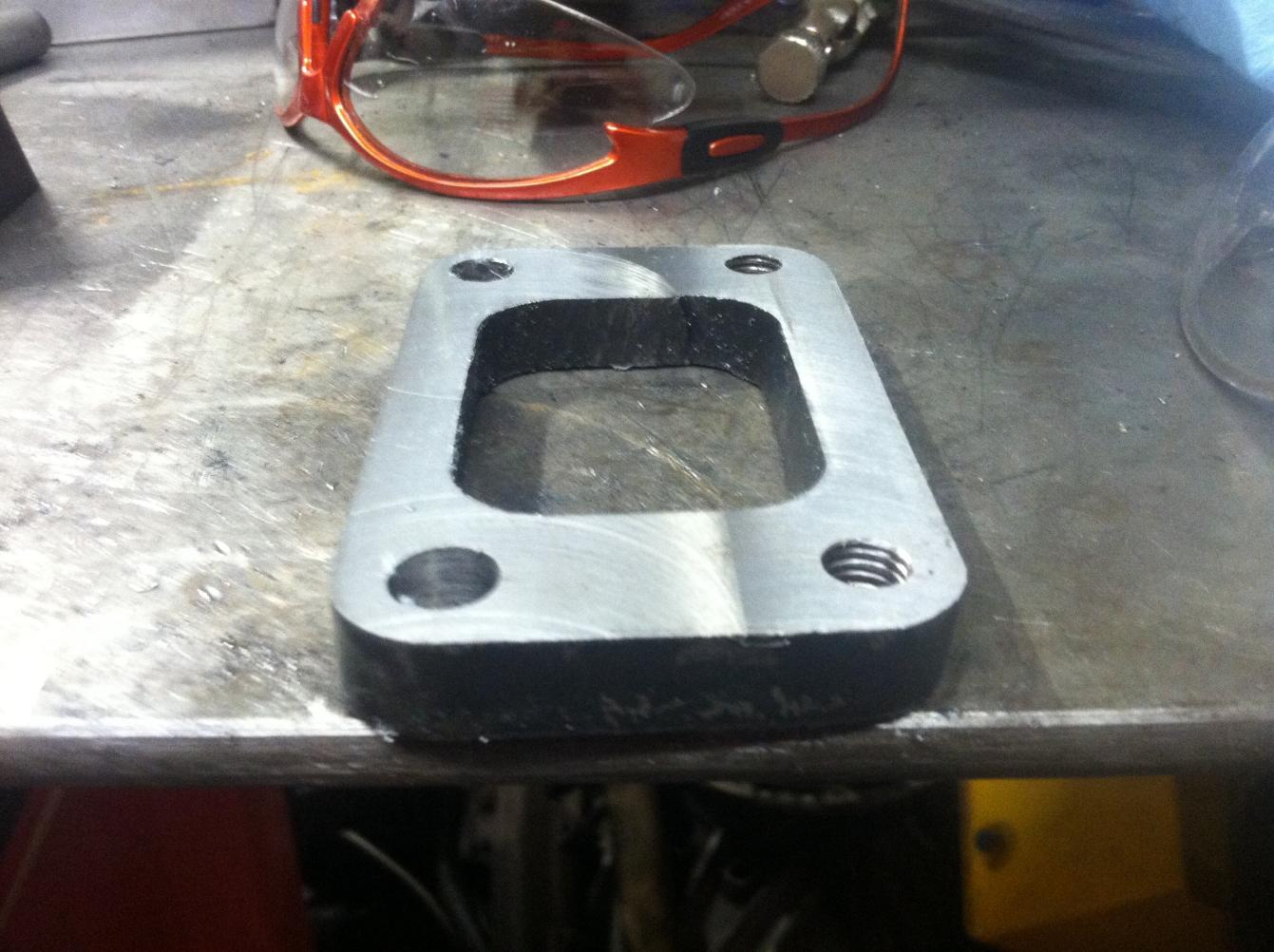

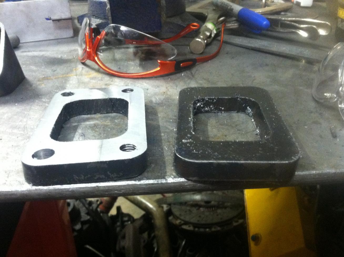

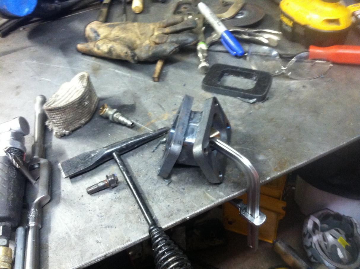

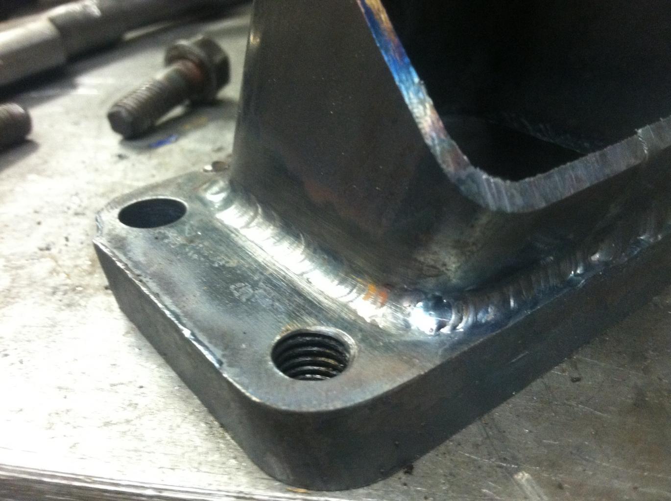

    Almost done with the mount

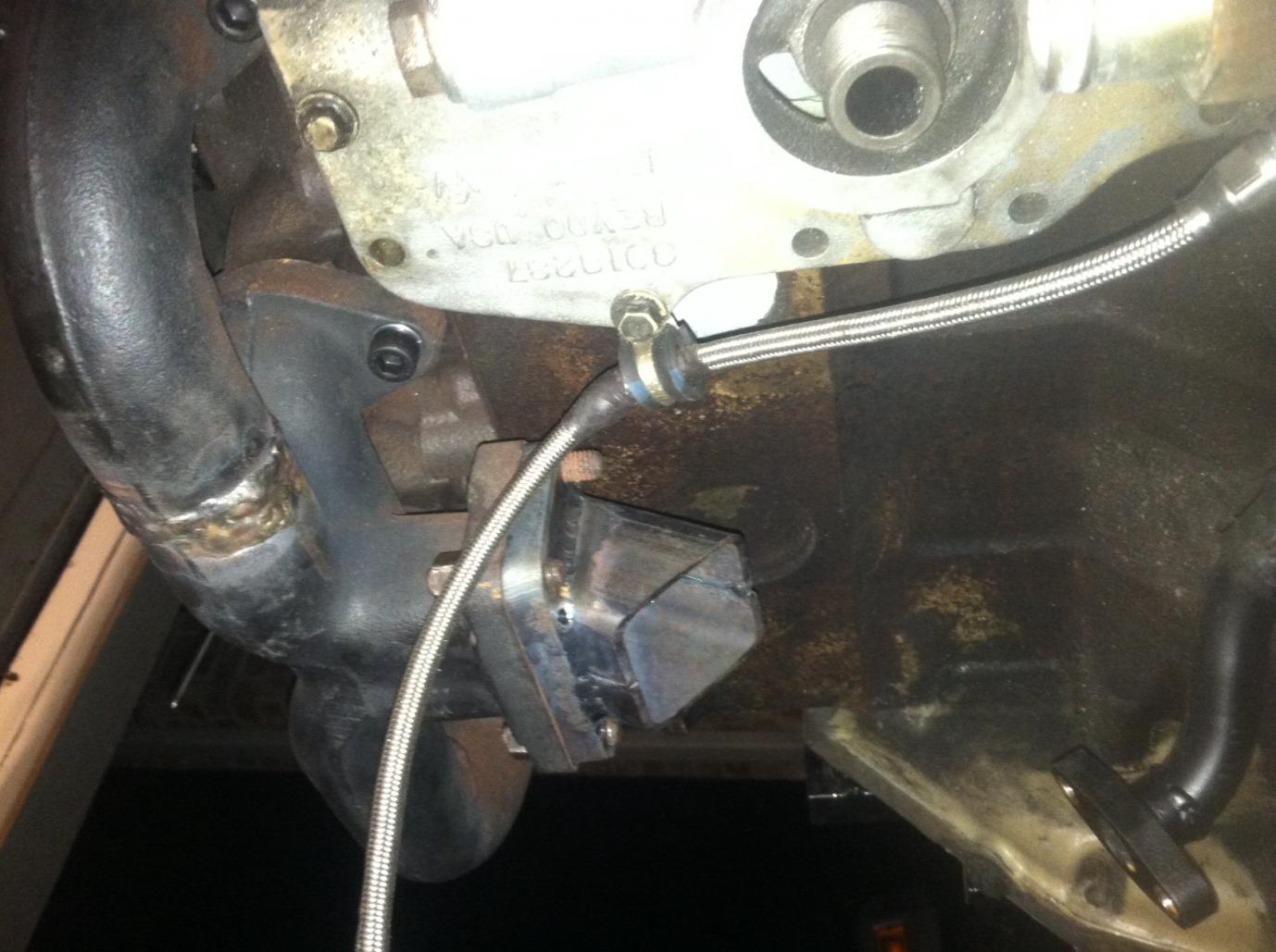

    Test fit turbo

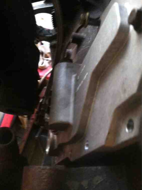

    Built with everlast equipment and I am happy with the quality of the part featured

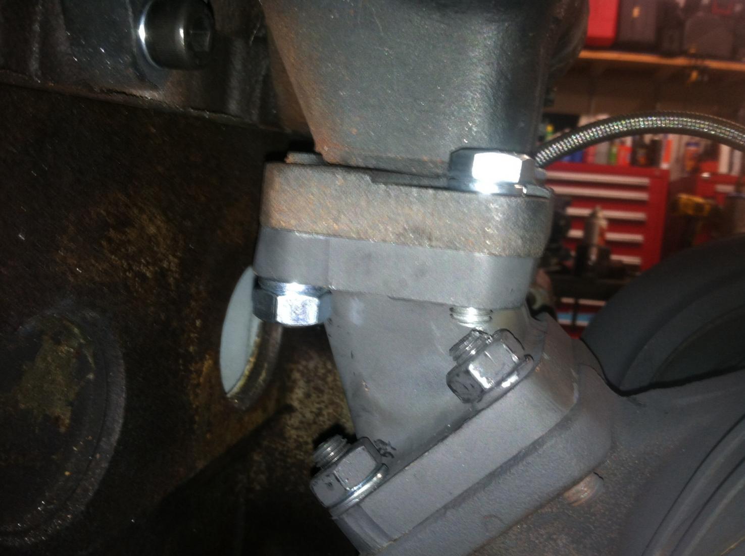

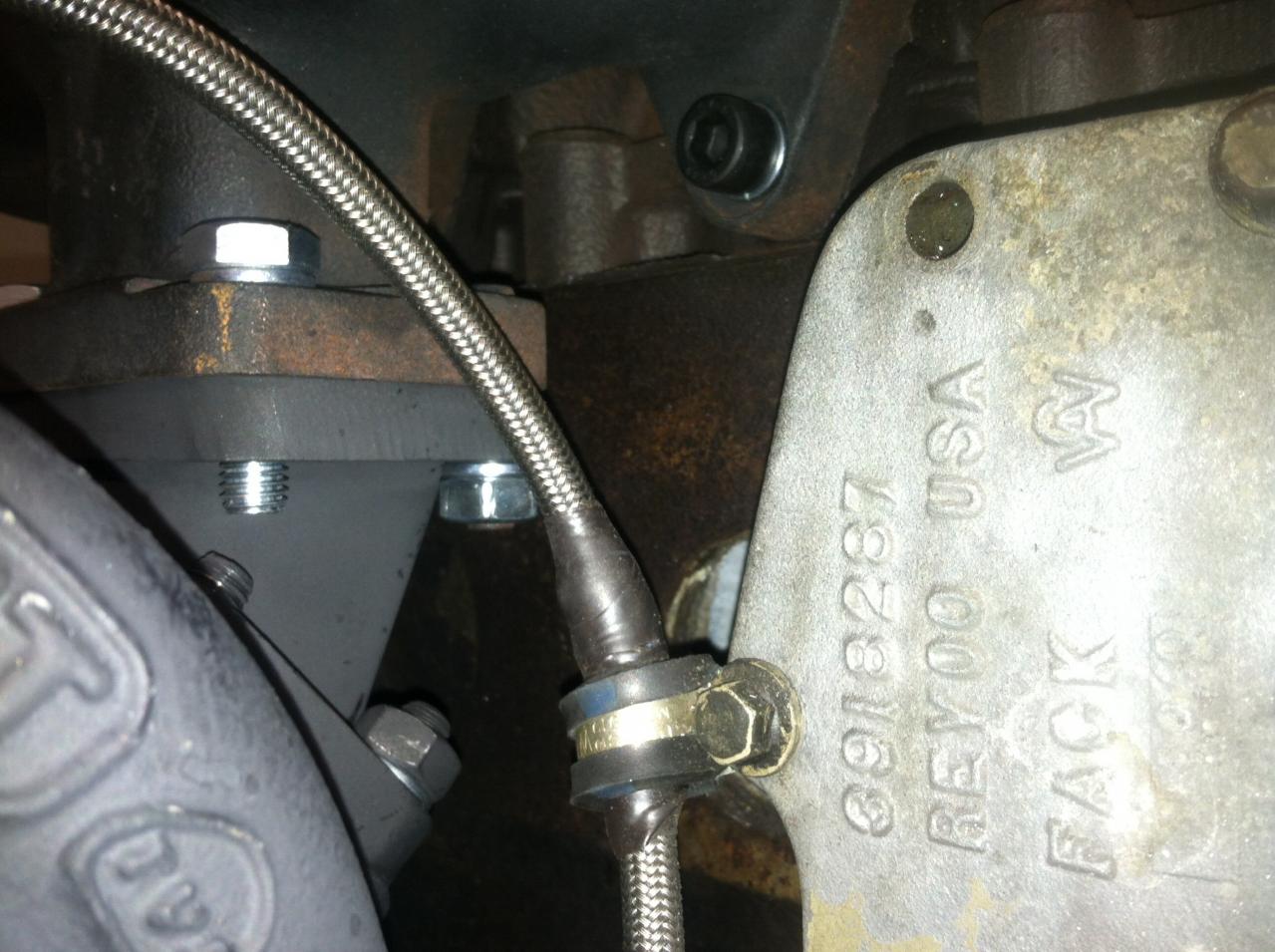

    Mount is all done

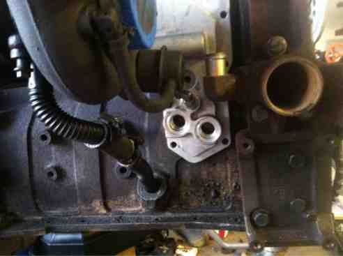

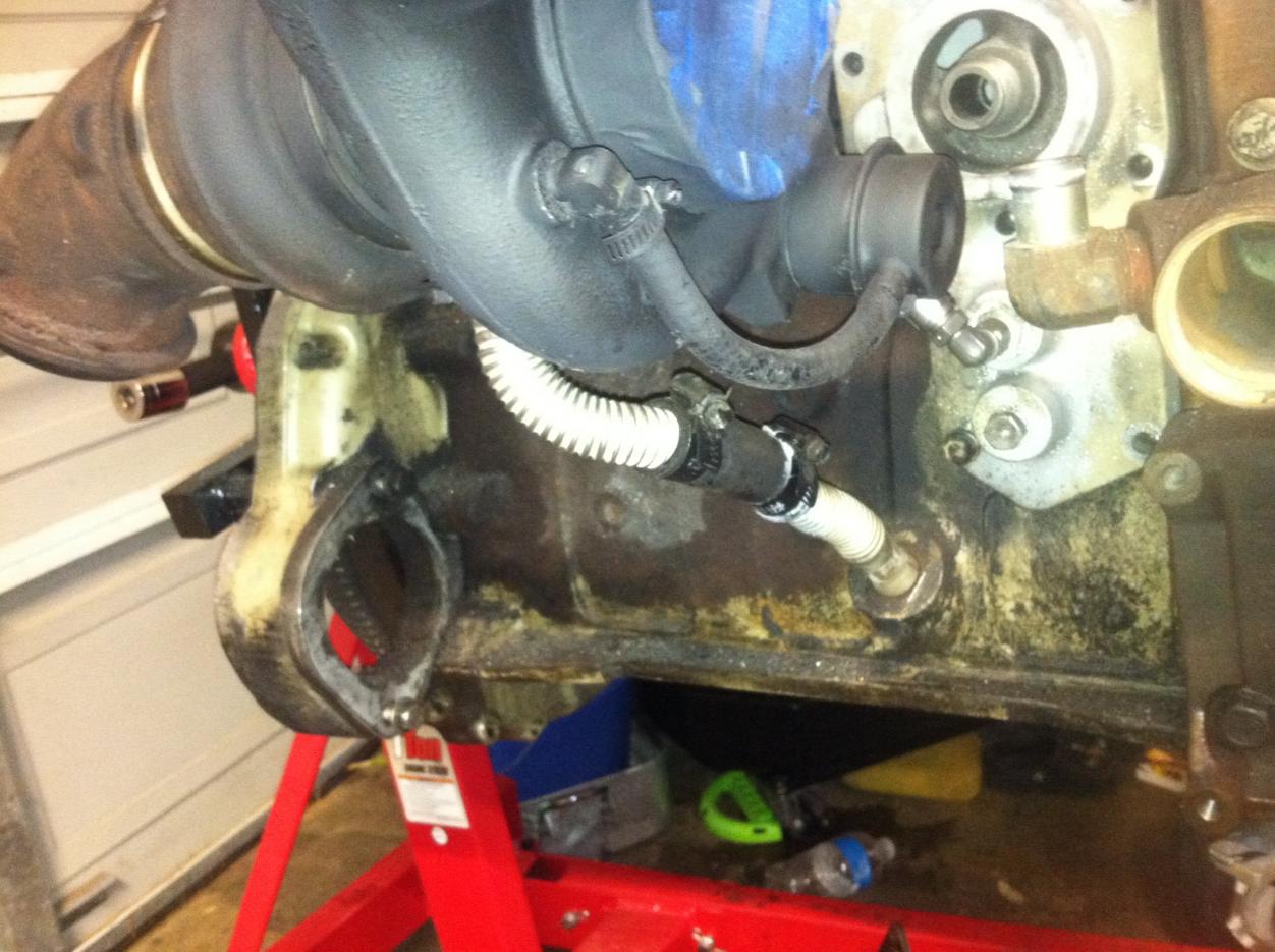

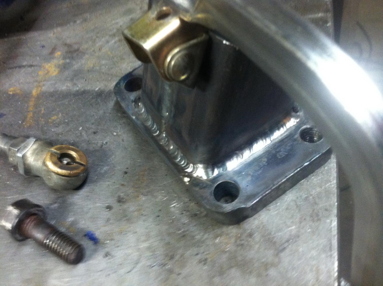

    Installed a new oil drain for the new configuration

    Do you have room for the oil filter ?
    New part on the way to install a remote oil filter

    Quote Originally Posted by dzljon View Post
    It'll stay cleaner without oil running down the side of the block when the filter is changed. Fumoto oil drain valves are nice too. I even have one on my lawnmower.

    New fitting for the remote oil filter
