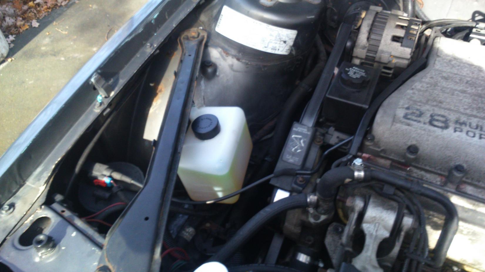

    It was a Close Fit. Had to bend a little. Move the Overflow hose. Then found out that the Hose was larger than the fitting. Put a hose clamp on it. Didn't seem to be leaking. Click image for larger version.
