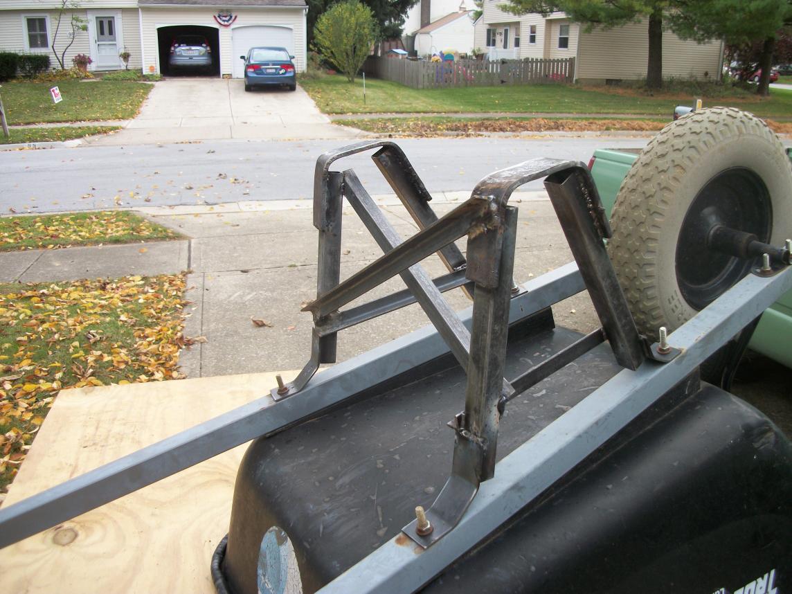

    My trenching in the previous thread overworked my wheelbarrow's rear support legs causing the thin stamped metal to buckle.
    Won't suffer that issue anymore!

    Looks much beefier than the original, thin-gauge stamped stuff!
    I recently replaced the wood handles on my 'barrow, and look forward to having an excuse to give them a try. The steel parts were in decent structural shape, so I ended up just wire-brushing the rusty spots on them and shooting them with a zinc-rich spray. Re-assembled with new hot-dipped galvanized nuts and bolts, should be better than new.
    Only weak point now is the metal where bolted to the handles that hold the legs. We just re-built one of our two. I think the brand is Jackson. Dual front wheels.
