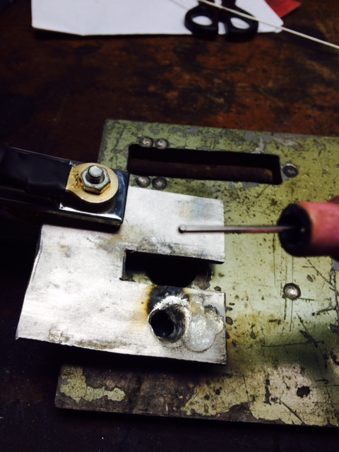

				I have finally found some time to try out my PowerPro 164 on aluminum.
I first tried to practice on a couple of aluminum cans and it was blowing through the cans even at lowest amps.  I used up to 20lpm argon thinking I wasn't doing something right.
I then got out some 1/8" aluminum and sanded it off and tried to create a pool of metal.  All I could accomplish was to melt the 2% Thoriated tungsten up inside the cup and the arc would just barely create a pool of metal.  I turned the machine up  as well as the gas and as you can see (be kind), I just burned through the piece.
Can anyone look at the photos and see if there is a setting I have wrong.  I watched the "Mr. Tig" video and I thought I copied his setting on the PP164 video.
Note: I pulled the tungsten out of the torch so you could see what happened to the end.  It took almost no time for this to burn off up into the torch.  All the toggle switches are in the upward position.
Thanks for the help.
 Way too much argon.  Try five to ten lpm.  Balance should be the other end of the scale, like 30% max. There was a glaring error in that video. He said 65% negative, but the Everlast control is calibrated in positive, so 65% negative = 35 % positive. If you look at the machine when he is actually welding, you can see the control has been changed to about 30%, but they didn't re-shoot the portion where they set the controls. Different brands use different control schemes, so you just have to check each machine.
Welding cans is not the way to start. That takes a lot of experience and skill. Also start with very clean material. 1/8" is good, but wire brush it with a dedicated stainless wire brush and clean with acetone. Are you using a foot pedal?
