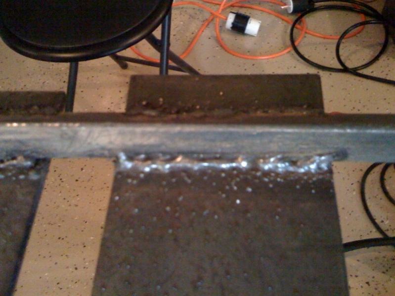

Jay,
No offense, but those welds need some work. What gas and gas rate are you using?
What wire? There is too much spatter. That could be from too long of a stick out or too high of voltage. The arc should be stable and try the arc force about 3/4 of the way to the right. The sound should not be unlike a bumble bee or a mosquito like whine. Move your gun to about 1/2 inch off the metal to weld right now. A good point to start is probably about 18.5 volts with a wire speed a little over 200.
The wire speed feed is a relative number like 0 -10. Actually to convert to a close wire feed in inches per minute, multiply by 1.92 and will be close to ipm.
