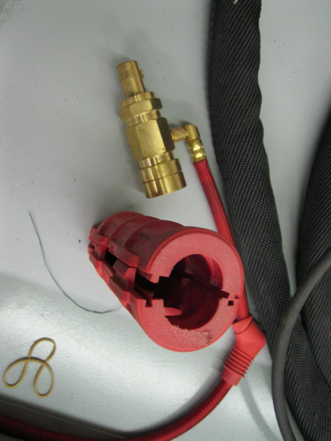

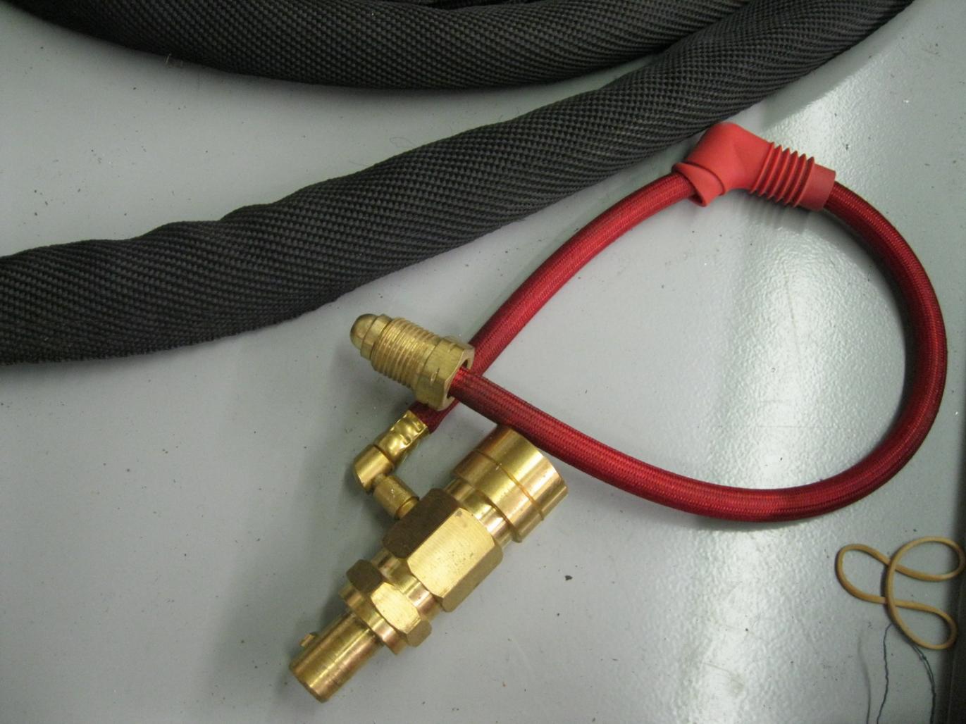

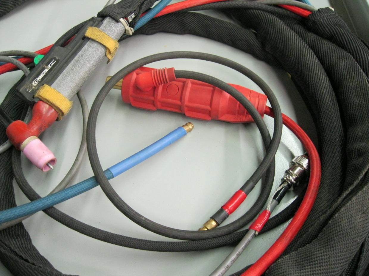

    I put my old CS310 to my 325EXT.

Name:	cut off clamp cover.jpg

Name:	cut off water and gas fittings and put on QD from Everlast.jpg
    used Everlast QT fittings for gas and water
Name:	grind down cover to fit.jpg
    grind down plastic to fit on plastic on machine sticks out to much.
Name:	Longer line for cooler.jpg
    Made water line longer after cutting old fitting off it was to short

    I also put color heat shrink on the ends and color tape also to match each fitting gas on the 325EXT I used yellow.
Name:	325EXT color coded.jpg

    I should probably start a new thread for this but does anyone know why coolant would be shooting out of the tig torch? I got the cooler today and hooked up the water cooled torch to make sure everything works, and coolant is just streaming out of the end of the torch. I have it connected like it says in the manual. Blue hose to blue fitting, hose coming out of the Dinse connector to the red fitting and the remaining hose is connected to the gas on the 325EXT. When I turn on the cooler, it shoots water out of the tig torch. Any ideas?
    Quote Originally Posted by kumaichi View Post
    Sounds like you have mixed up the gas and water lines. Be sure to flush everything out with clean water then run plenty of dry air through to dry your hoses or you will have no end of contamination problems.

    I don't think that you read the manually fully about the connections. It shows the correct diagram and refers to the cooler connector colors and where to put the lines. and mentions how to double check your connections. The arrows were meant to show which onces they go to. Some of the earlier coolers had different front end connections so that's the reason the fittings aren't shown. And it also mentions that "some" torches are color coded this way, and mentions BOTH colors being there... ie...CK. That is why it gives several descriptions and how to double check. Was there no paper sticker on the gas line?
    No paper sticker on the gas line, I got one blue hose and two black hoses. One black hose comes out of Dinse connector, which I connected to the "red" connector on the cooler. The blue hose I connected to the "blue" connector on the cooler, that one seemed straight forward. This is the torch that came with the machine.
    I'll try the compressed air and see what I come up with.

    I bet the particular torch you have used black for the water and blue for the argon, instead of the paper sticker. It's always best to double check the lines. That is one nice thing about threaded connectors, water is left hand thread while gas is right hand.
    My thinking exactly, a right hand thread can't go into a left hand nut.
  18. Default
    Rambozo, you sir are correct! I slid the handle down on the torch and sure enough, blue line is the argon. Thanks for all the help!
    Depending on if you can swap them at the torch, you might want to do that, since your blue hose has been contaminated. Then you won't have to worry about getting the hose spotless. Just make sure you clean out the gas passages in the torch, while you have the hoses off. Plus then you will have a color match that makes more sense to you.
