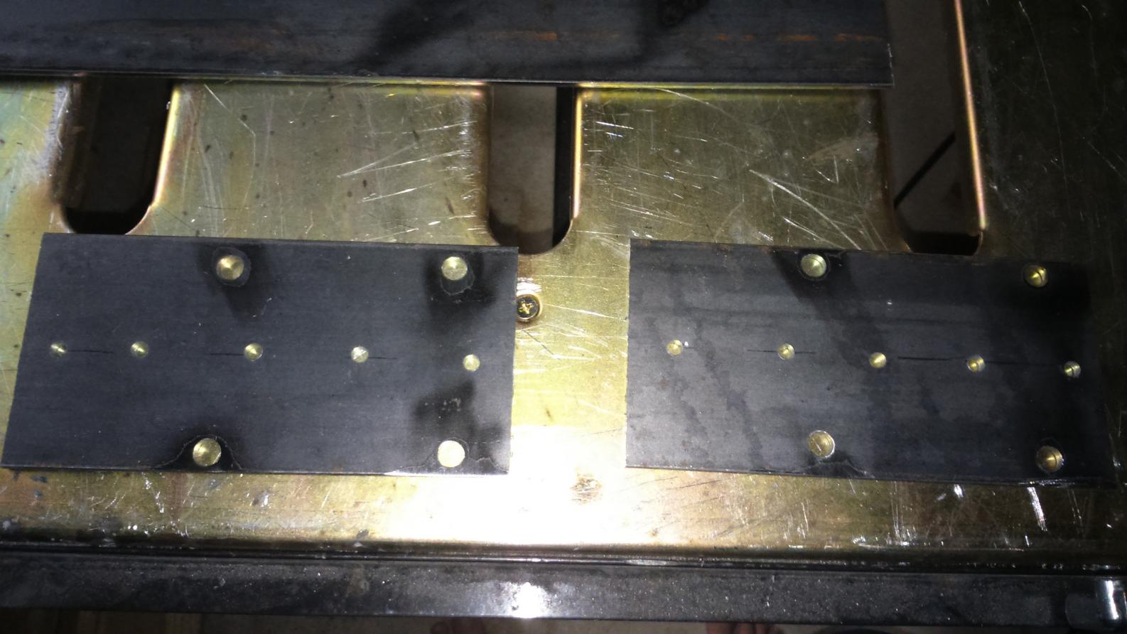

    The 2 small plates are for the front swivel casters. Predrilled.
