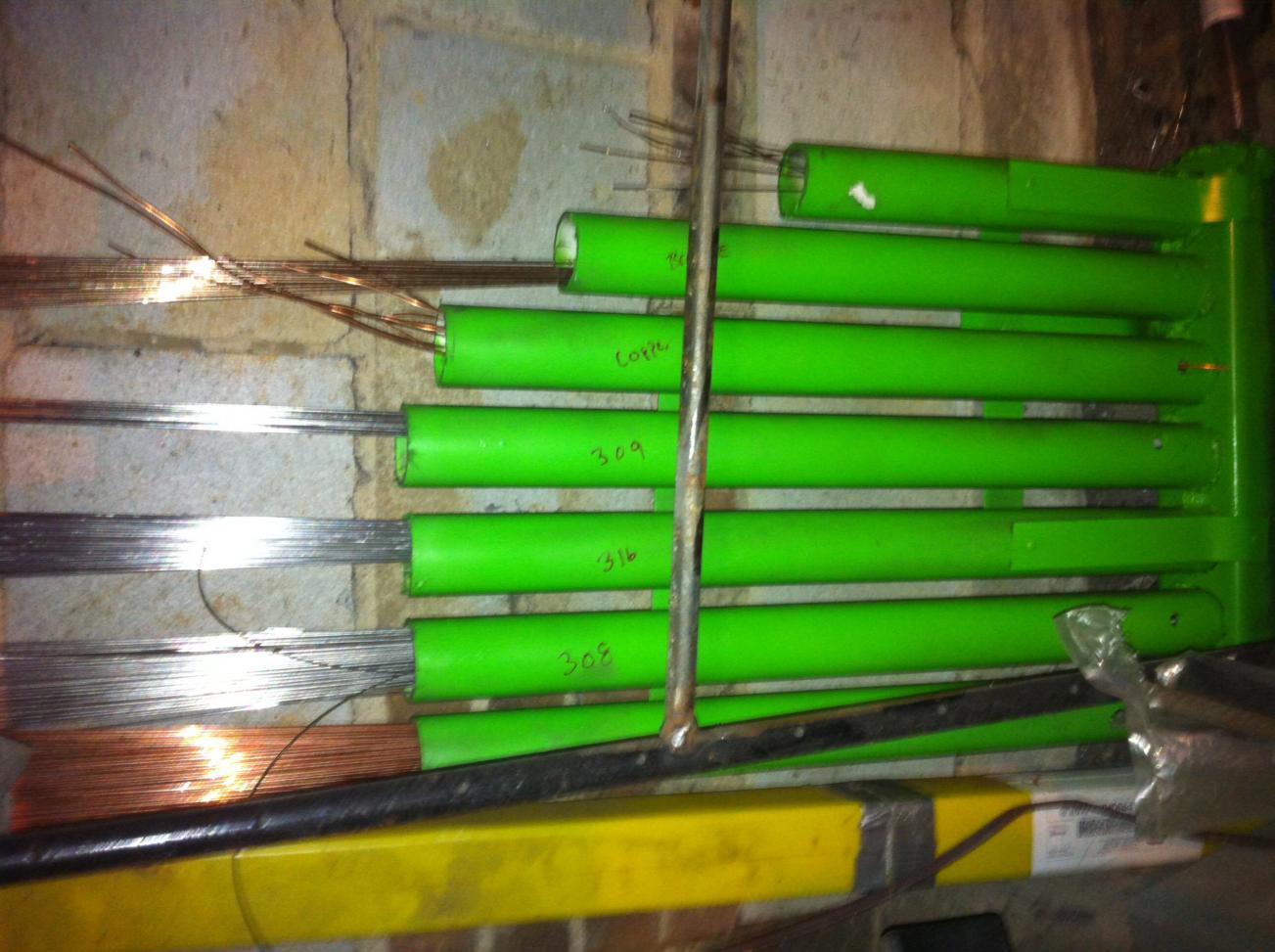

    Since I haven't been able to do much in the way of melting metals. I figured I'd straighten my area a bit. Built a much needed filler metal holder from some 1.5" PVC and some scrap metals. Then painted her up. Pretty close match
