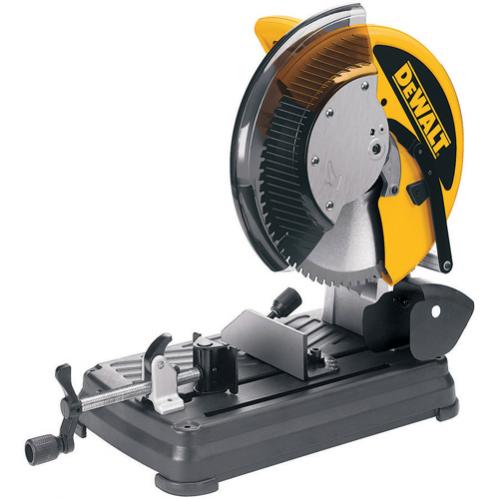

    I am starting to use it to make my cart. Currently working on the Lower Frame. Seems OK. Dewalt gave me a used blade. Didn't have the print on the side. Throwing Sparks and Metal. I would recommend an Apron/Work coat, Hearing protection. Face Shield. Loud. About as loud as a Chop Saw for wood. Maybe a little louder. Have to use a Square to get my angles correct. The supplied gauge has some play in it.
  4. #44
    Sounds like you might have gotten a dull blade. The carbide tips are wider than the blade disc, so if used properly, there should be little to no rubbing on the sides of the blade. Mine has a few hundred cuts and pretty much has all the blade printing intact. Also very few sparks, almost none when it was new, but a few now that the blade is slightly worn. For sure it does throw hot metal chips. Here is a comparison between a dry cut and an abrasive saw on 1" x .120" wall square tube.

    I forgot to Warn. It will "Kick back" small pieces. Had to chase down a few that was thrown behind the machine. Fortunately I had open space behind where I was cutting.
  8. #48
    Mine has an adjustable brace to hold small off cuts, while I don't use it often, it can be useful. Maybe see if you are missing any pieces.
  9. #49
    Aug 2014
    263
    Mine has a deflector that swivels up and down slightly. Sits mostly behind the blade. Easy fix.
