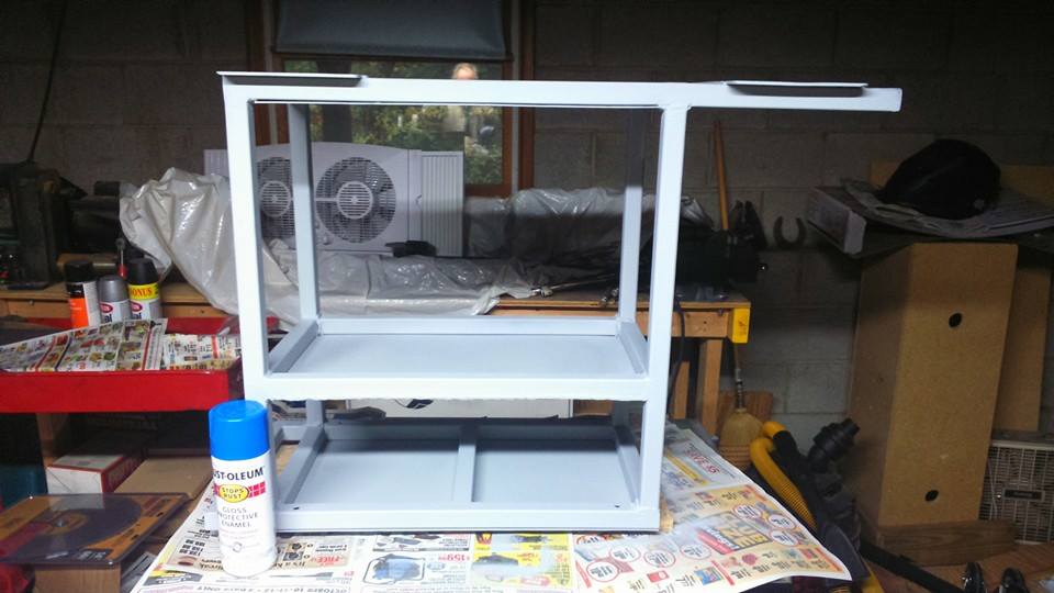

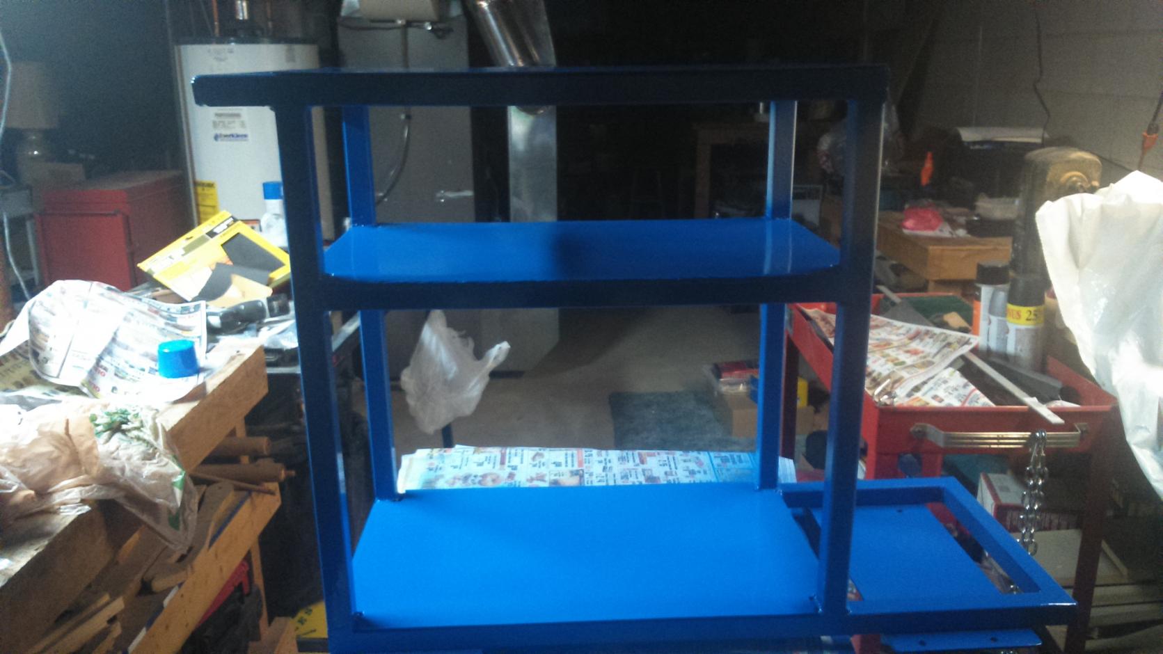

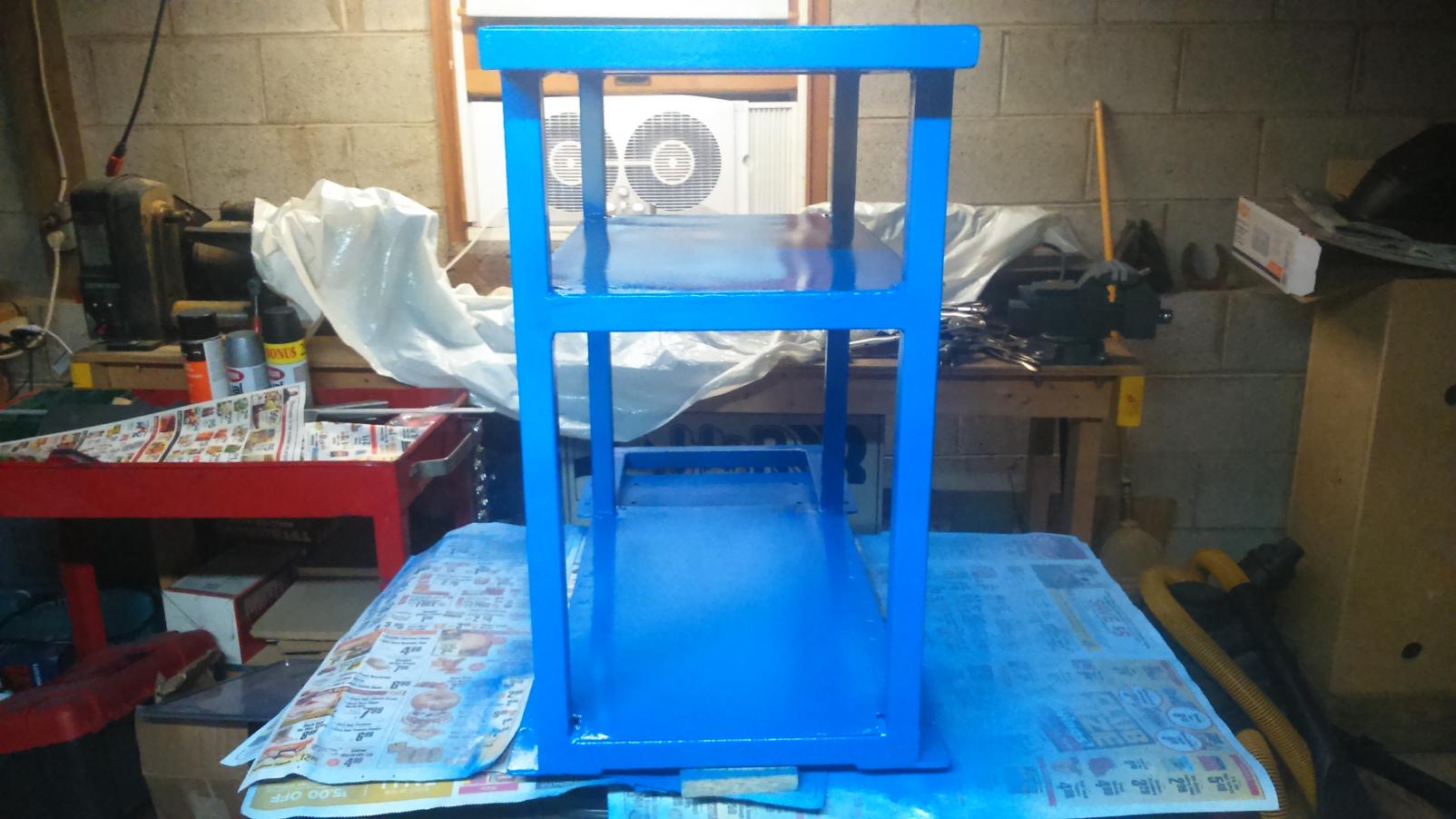

    Primed. Waiting for it to dry. Its upside down at the moment. I did get two cans of RustOleum Sail Blue. I could have gotten Magic (I think the name was) brand JD/ Sfety Green. But figured that would be too much Green on Green. Just need to drill the holes for the Safety Chain.

    My carts are black, not flat. And my welders are green. Works great me me. A dark blue would look good too. But I agree on too much green.

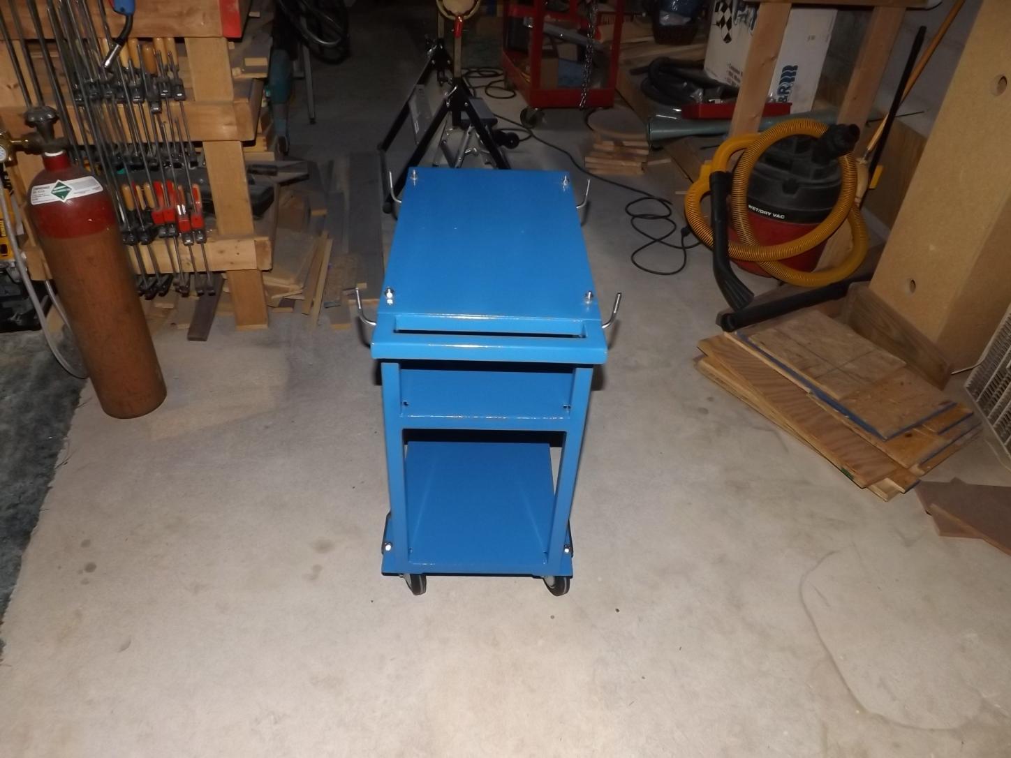

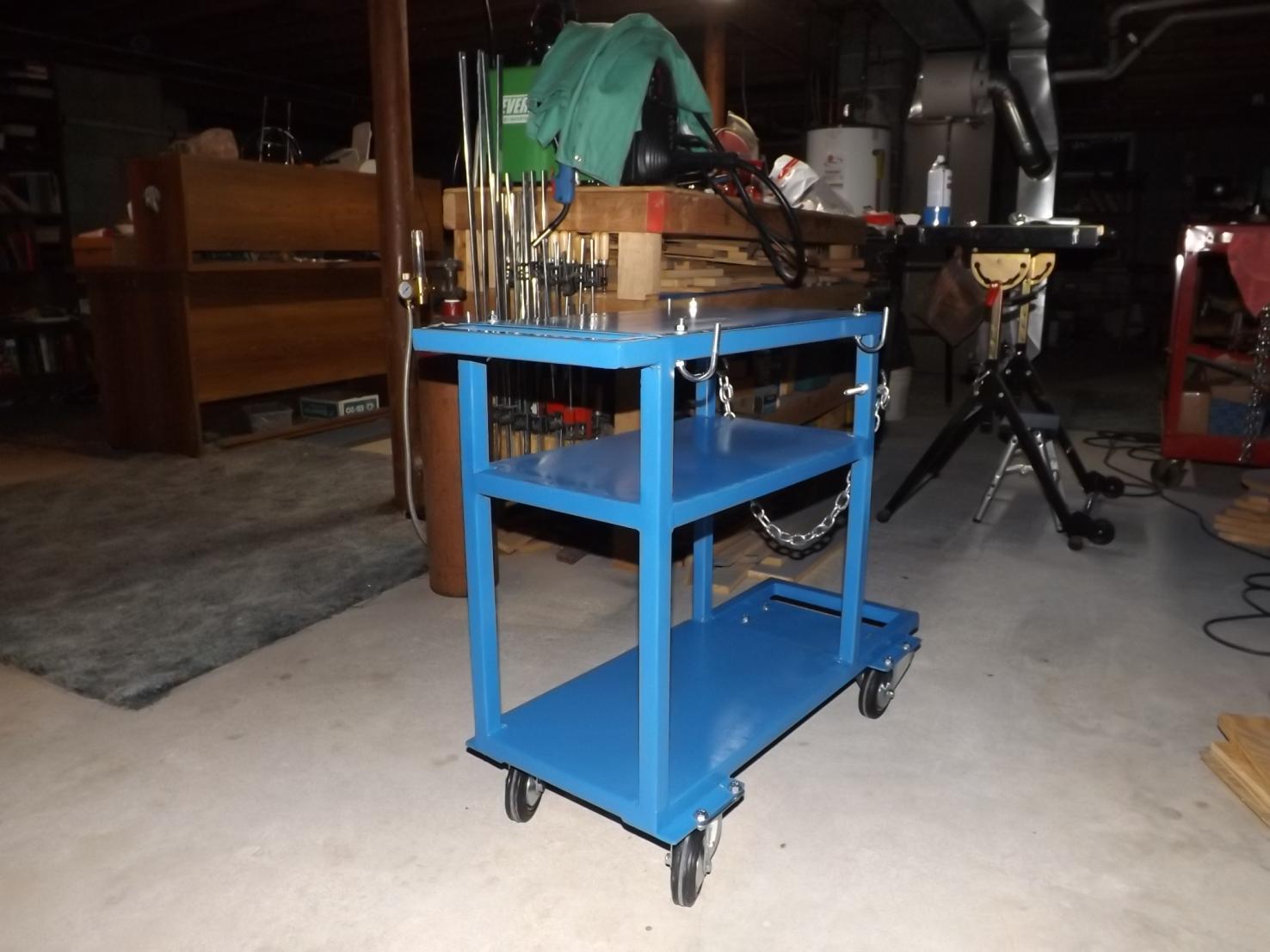

    All Finished. Just drying. now. I can still smell the paint. Click image for larger version.
ID:	12470Click image for larger version.
ID:	12471Click image for larger version.

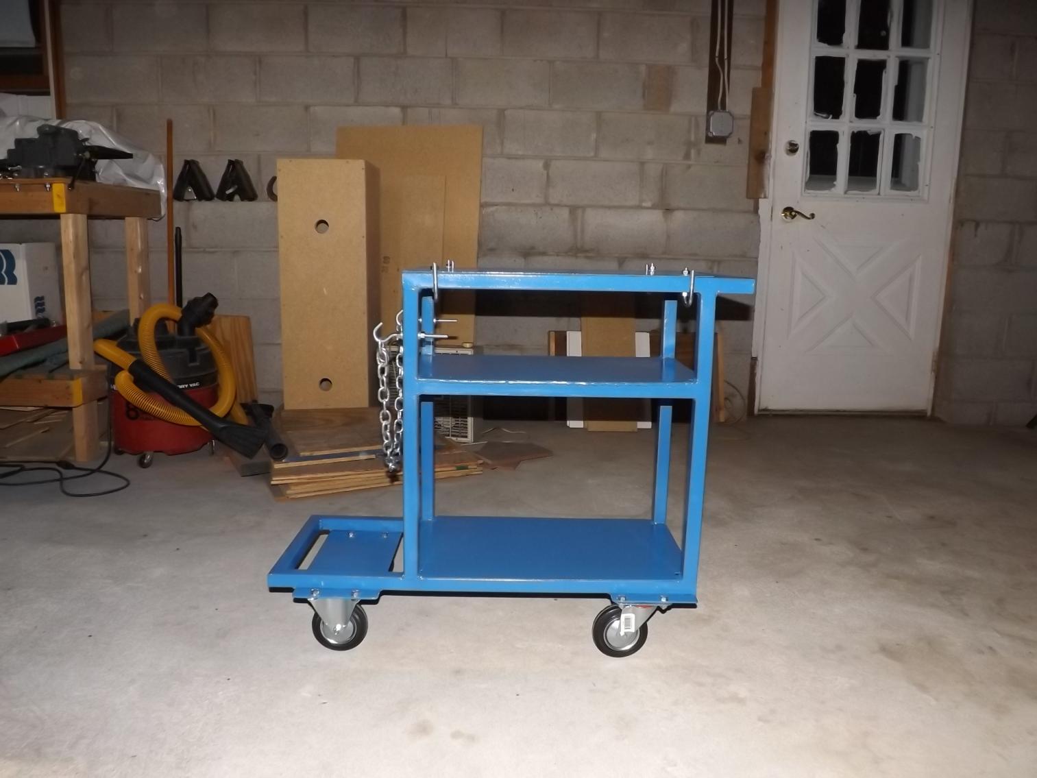

    Looks good. Looks a lot like mine, other than I have more space in the middle (for a Plasma and two TIGs on it). Also I have a lift up and down handle. And mine is Henry Ford favorite color.
  16. #56
    Aug 2014
    263
    Thanks. I only really needed a more basic unit. Its only for a Mig.
    I used 5/6" U-Bolts. Threads weren't long enough. Had to use a Die to cut a few more. This way I was able to use a nut on the bottom. To help lock them in place. The Swivel Casters were mounted in a little bit. This way the front wheels don't extend past the frame. The rear casters(Fixed) are underneath the 1/8" plate to handle the weight of the tank and cart. The 1/8" Thick Sq. Tubing was used on the rear legs for extra strength. Height is 27", Depth is 30", Width is 12" (14" on the rear plate)
    I would've liked to have had a Drawer to store small items in.

    Its actually pretty easy to roll. Even with all the weight on it. Maybe I should've made it a little taller.
  18. #58

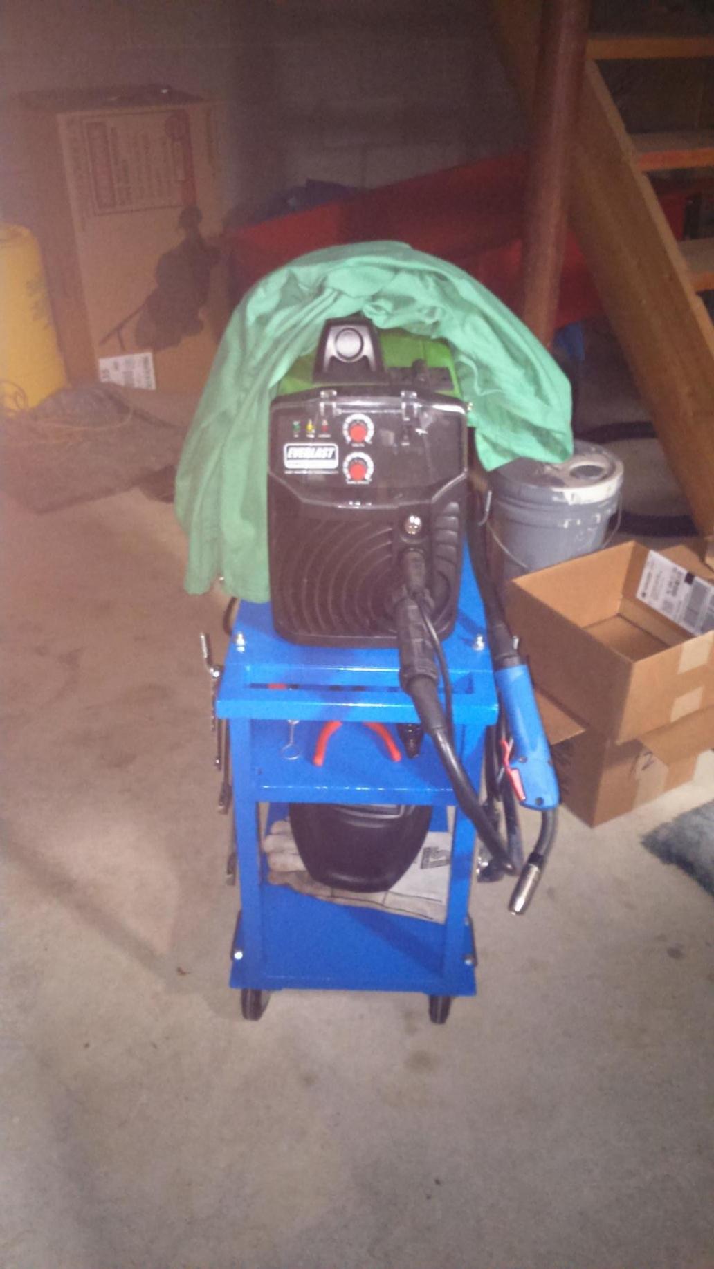

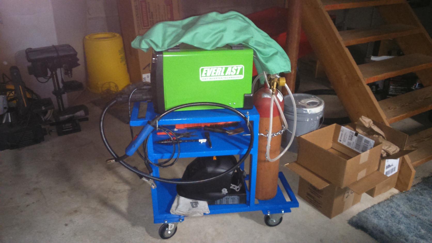

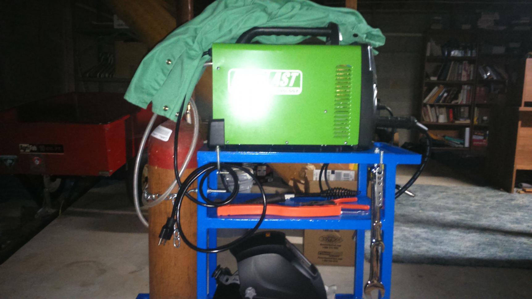

    Looks nice. How about a picture of it all loaded up? One minor point, it's not a great idea to hang cables over small hooks like your U bolts. It can damage them over time, because they will exceed their minimum bend radius. This is true of all cables, but particularly with MIG guns, as they have moving parts inside.
    You can always add a drawer at a later date. There are all kinds of add on drawers for things that you can adapt.
  19. #59
    Aug 2014
    263
ID:	12517[/attach]Click image for larger version.
ID:	12515Click image for larger version.
