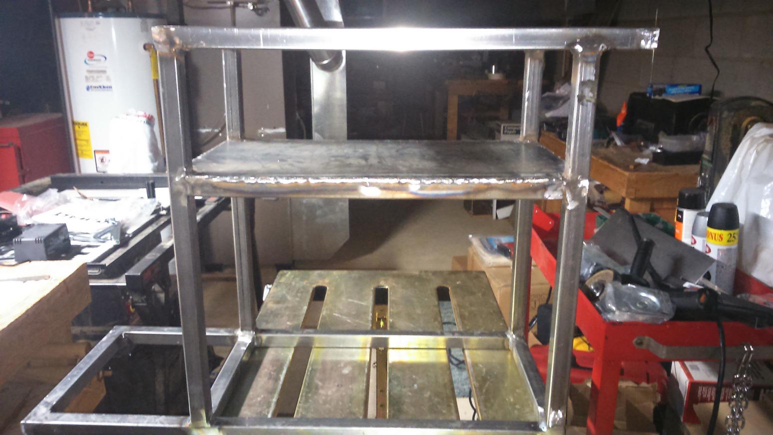

    I started welding on the Middle Shelf. Figured it would be easier to do this now. Tried doing a Spot Weld. I had the Blue spots on the backside of the Shelf. But not in the Tubing underneath. Just doing a Filet on the outside. Maybe on the inside as well when I am done.
  9. #29
    What you wanted was a rosette weld. They end up as an almost invisible weld for sheet metal MIG after a little touch with a flap disc.

    That's what I meant. Problem was it wasn't going through the sheet metal. Even with the Volts all the way up.
  11. #31
    To do a rosette weld, you have to start with a hole in the sheetmetal, drilled, punched, plasma cut, etc. Everlast has a pretty good example in one of their trailer hitch videos as I recall.
    To do a spot weld or resistance weld, you typically use two contact electrodes and a different type of power supply.

    Thanks. At least I get to practice some beads. The Self was slightly larger than the frame. Grinder will fix that.

    It doesn't rattle. Today I added an additional support bar to the top shelf. Once I put the 16 gauge sheet metal on, Should be plenty strong for the weight of the welder. Even with the 8" Roll.
    The Rosette Weld. What size hole should I drill in the sheet metal? 1/8"?

    3/16 to 1/4" would be better. You want the weld to start on the base metal. I always called it a plug weld.

    Thanks Zoama. I "Tested" the welds. Lifted the unit by pressing on the underside of the top shelf. It holds. Ended up with a couple low spots.
    I went into this knowing it wasn't going to be perfect. Its going to end up looking like "Cr*p"

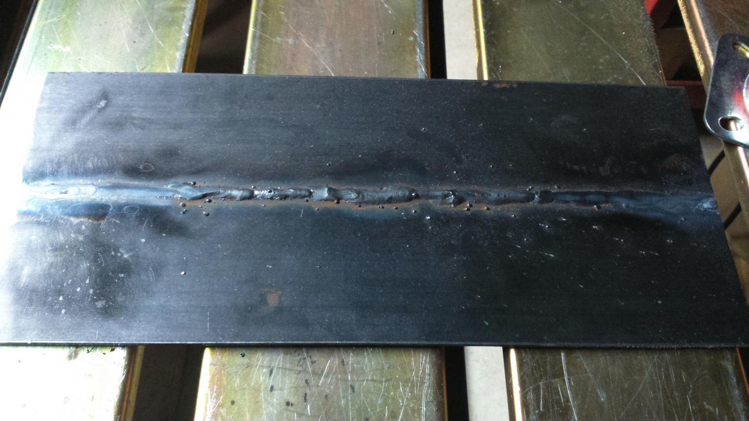

    Just welded together two 3" wide pieces of 1/8" flat steel. Blasted the one side so hot, It warped the table a little. Flipped it over. Welded the other side. Polished the one side down. Today I was curious as to how well the weld is. Laid it across two pieces of plywood. And stood on it. The 1/8" plate bowed under my 140 Lbs. But the welds seem to hold. Click image for larger version.
