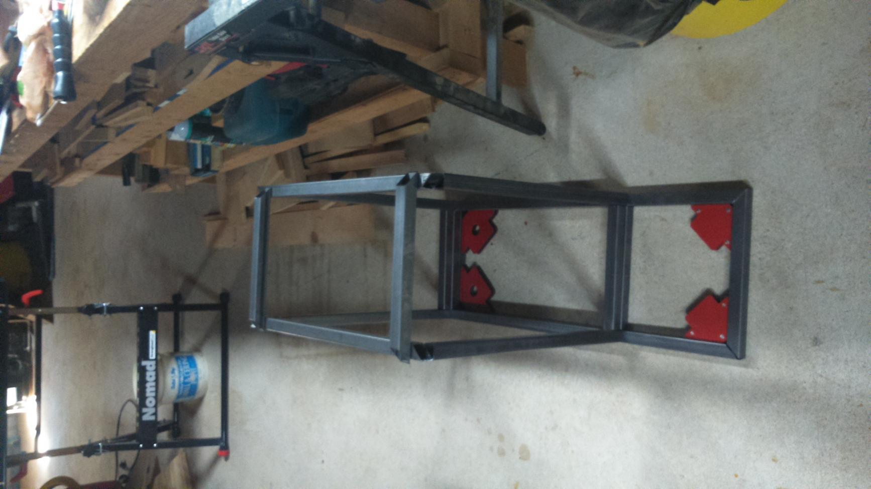

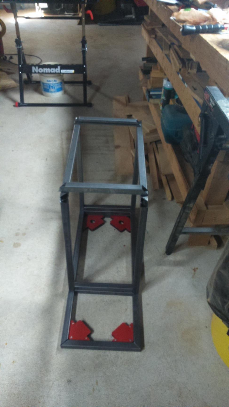

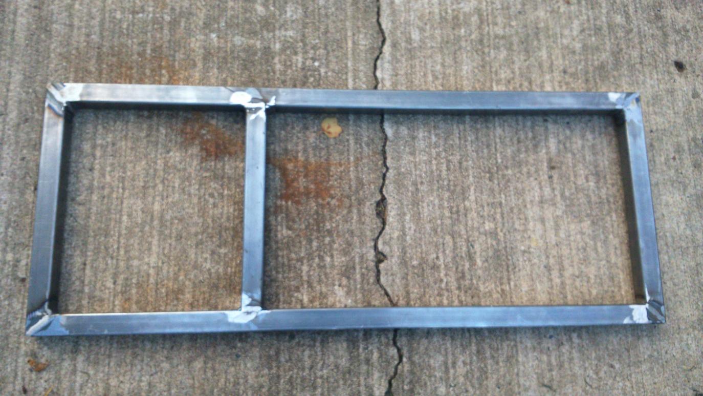

    Here is my idea.
    Cut two 30" long pieces and 3 10" long pieces for the base. The Shelf and Top will be 2 18" Long pieces and 2 10" long pieces each. Using 4, 1" Sq. for the Legs. Welded to the top of the Base. Forming the corners of the Shelves. Maybe 20" High or so. And weld the Sheet metal to the bottom of the frames. So that the Shelves have a lip around them so things don't fall out. Possibly using 16 Gauge. Under the Cylinder, 3/16" Plate. How does this sound?
    Thanks
    Sounds about right, but you can get by with 14ga. plate under your cylinder. Way easier to cut and over that span will hold several hundred pounds. The devil is in the details, especially with tubing. So work out where you will use mitered joints and where you want butt joints, so that any tube openings can do dual duty for something or be capped or covered. Some creative carts have the tube legs open for handy rod storage, but that doesn't really apply for a MIG cart. Be sure to provide a place to store your cables and having consumable storage is a big plus. Expanded metal shelves are nice in that they promote great airflow for cooling and don't catch crud. Of course then you can't put small items like contact tips on them, but depending on your design you might have a small drawer for those things or keep them in a nice divided plastic box.

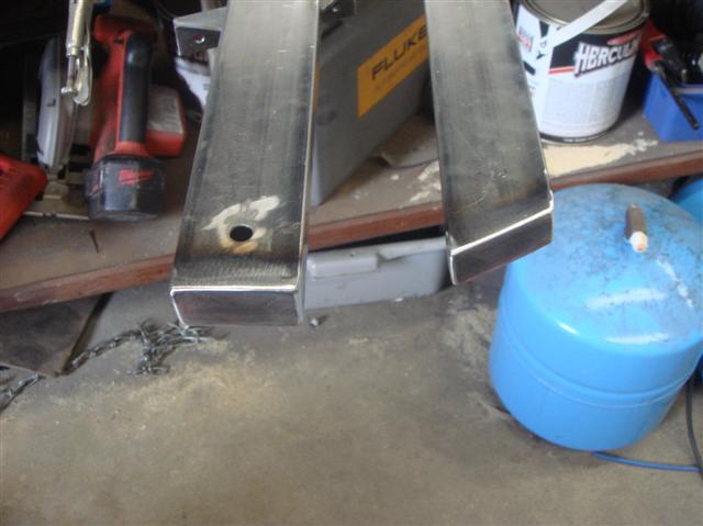

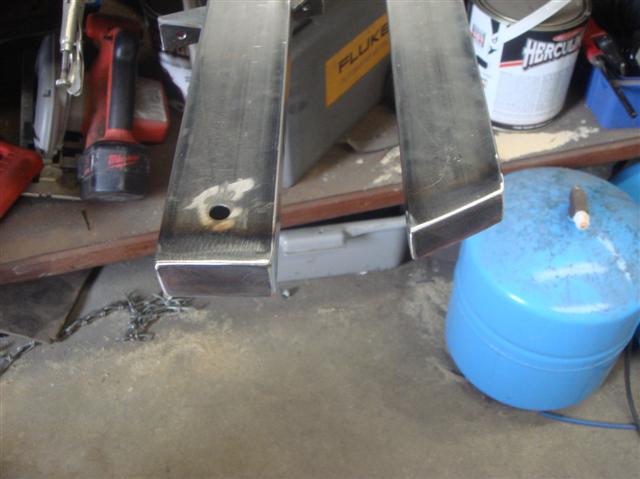

    Went to Trenton Sheet Metal today after work. All I could get was a 43" piece of 1" Sq. 1/8" Thick. Charged me $10 + Tax. Not a bad price compared to HD. So I bought it. Thinking maybe I could use it for the Handle. And where I am anchoring the chain for the Tank.
    One good thing about using 1" Sq. is, I only need to add 1" for each 45 Angle on the piece.

    Now you are in the right ballpark. I wouldn't expect the best selection of tube at a sheet metal shop. 1/8" wall is pretty stout for that, but you will find it a lot easier to weld than the 16ga.
    Depending on shipping there is always onlinemetals.com You are not that far away from a depot so the shipping might not be too bad. You won't have to worry about transport, but you will be limited to 8' pieces. At least it's a great place to look up common sizes and get some ballpark pricing. My local steel yard is usually 20-50% lower depending on the material.
    Not sure how far you are away from THIS PLACE.
    BTW When calculating for miters, you might want to measure square tubing on the centerline. Because the corners are rounded, it doesn't lend itself to making accurate layout lines form the max or min length sides.

    I need to get 2 more lengths. Still need to cut the two pieces for the Shelf. And the 4, 20" Legs. I am considering using the 1/8" tubing for the two rear legs. The ones next to the Tank. For the extra strength. As I need to secure the chain to a pair of hooks.

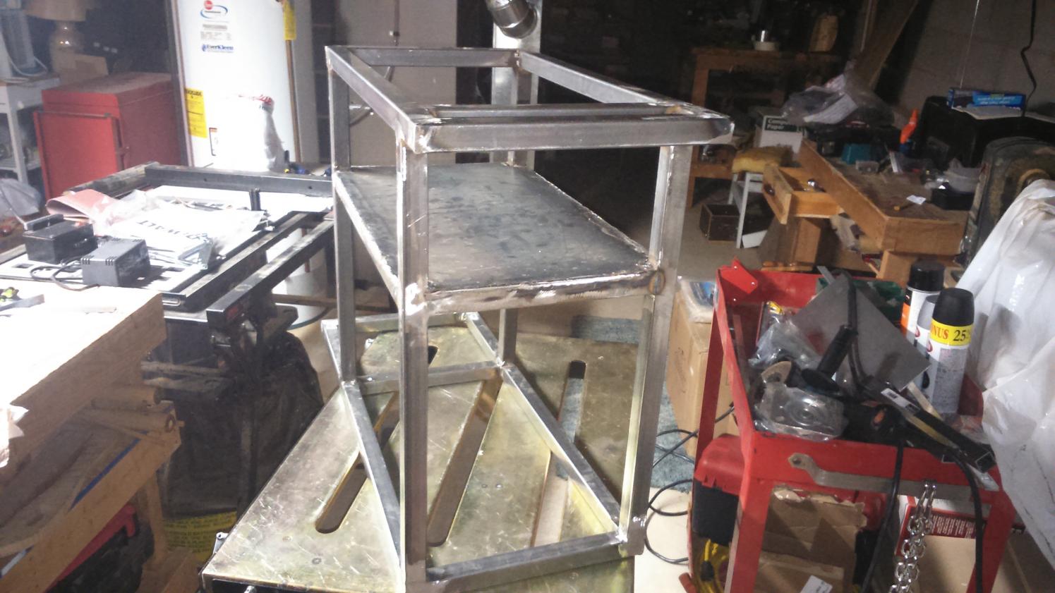

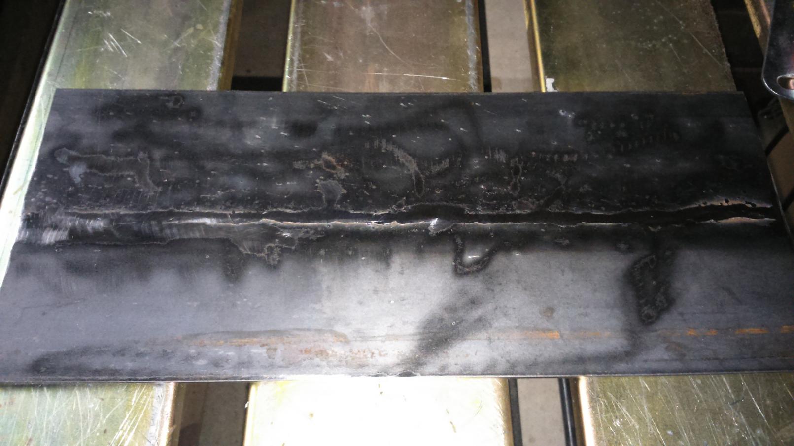

    263

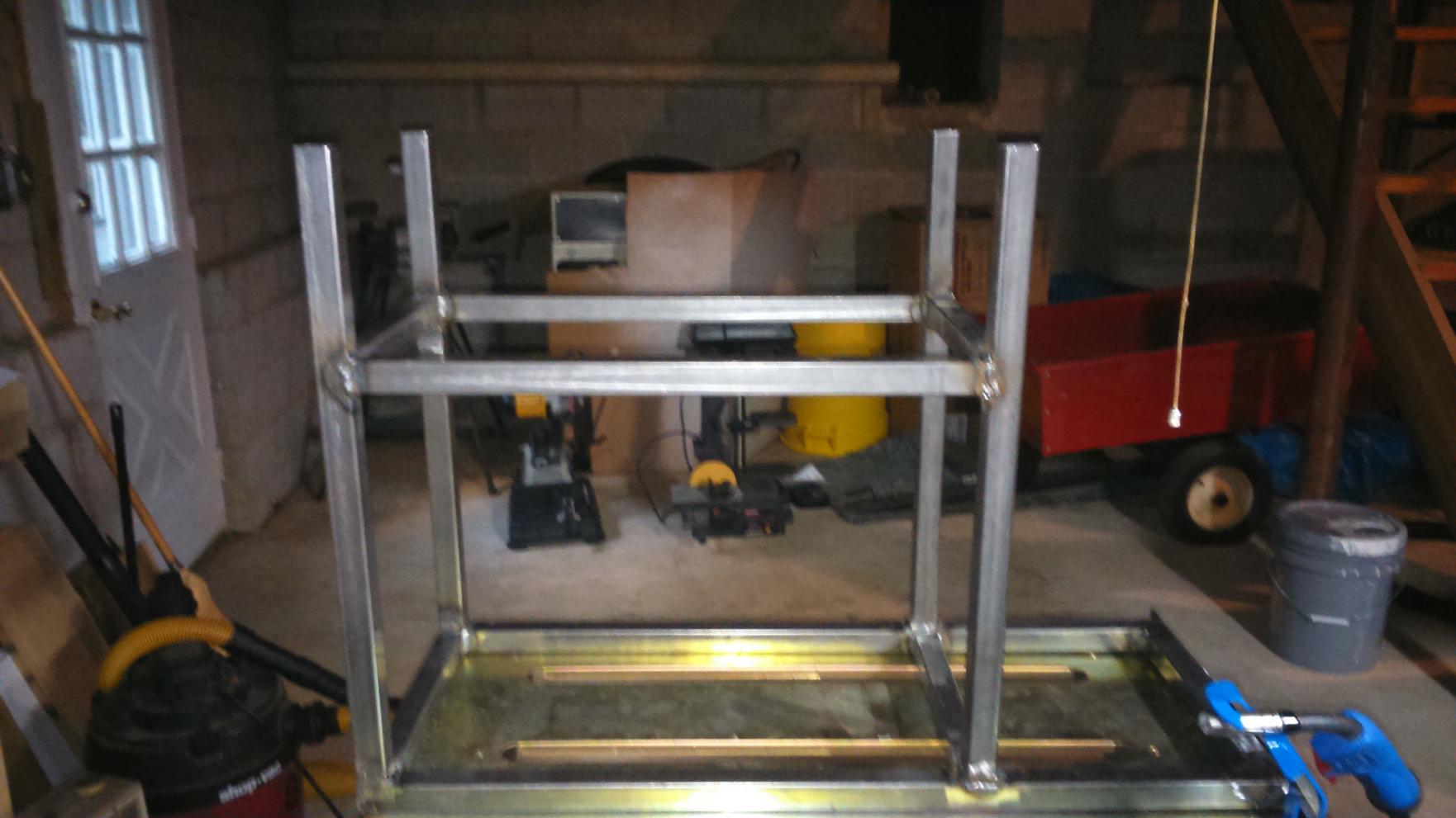

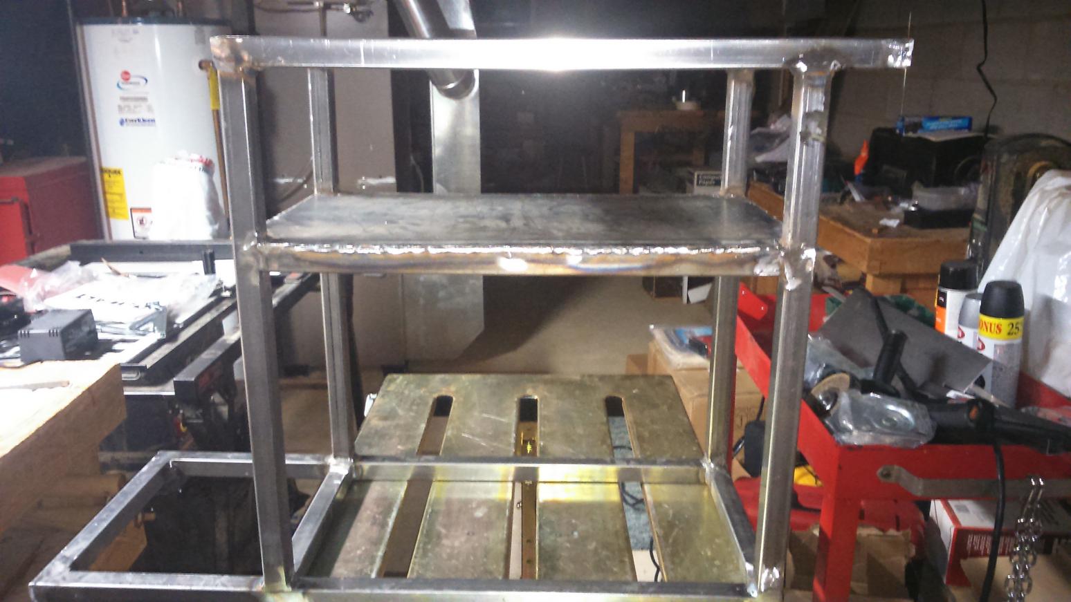

    Got to figure what Gauge to use for the Shelves? The Imig 140 weighs about 30 Lbs. + Plus wire. Tank weighs about 40 Lbs. Steel. 16 Gauge may be a bit of "Overkill" Galvanized or not? Not would be safer to weld. But a real PIA to prime and paint.
    Aug 2014
    263
ID:	12397 Here is where I am.

    The Beave suggested I use an Open grate style shelf. I found a 13 Gauge, 3/4" one at Tractor Supply. And a cheaper one at HD. The one at HD is 1/2" spacing. And it states .125" which tells me 1/8". These are 12" x 24" pieces. Which would work for the two upper shelves. Not sure if I want to Trust that for under the weight of the Tank. I am thinking about the two at HD. Would get me started. The bottom one would be welded on last.
