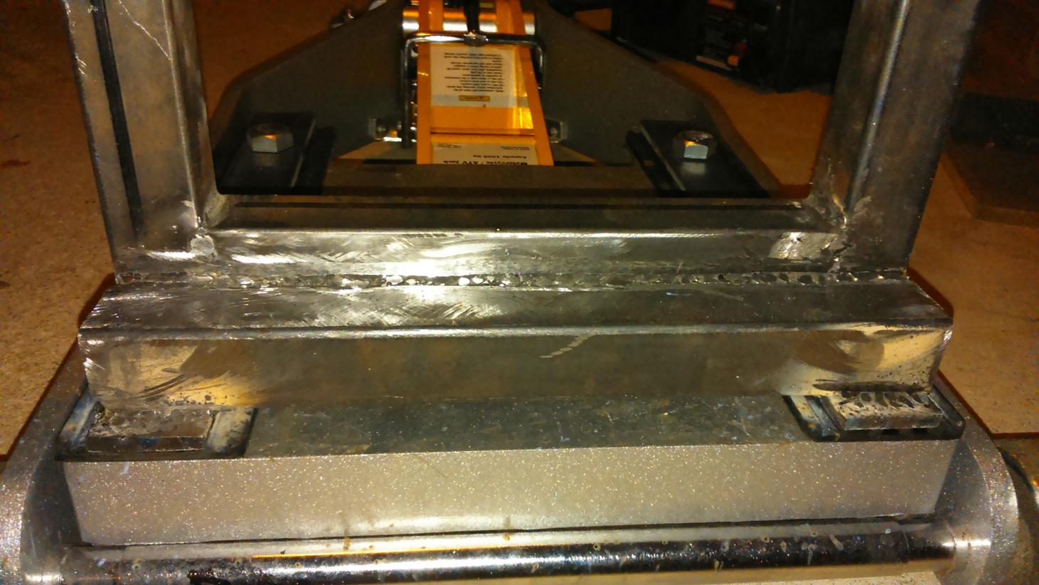

    Pictures always help.
    Aug 2014
    263
ID:	12354Click image for larger version.
    Hobart E71T-11 .030
    This stuff is really Smokey. I grinded it down a bit. If I run the V at #4 sometimes it seems to blow through. Turned it down a bit to fill in.

    Is the wire feeding smoothly into the puddle or does it pop, skip, stub ? How close do you keep the tip to the puddle ? Are you grounding to bare metal ?
    For the kind of stuff you are building, I think you would be a lot happier with solid wire MIG and C25 instead of flux core.

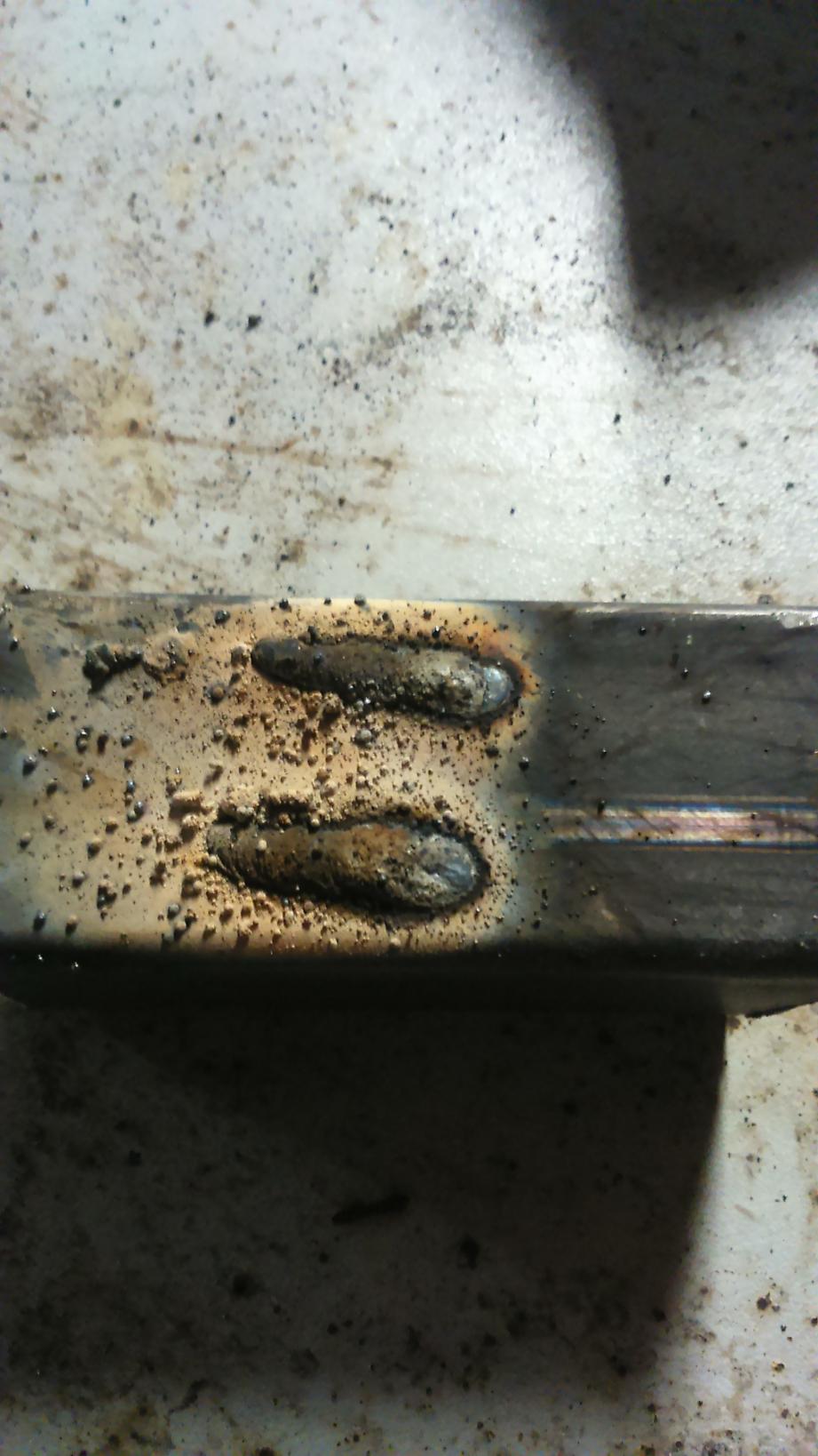

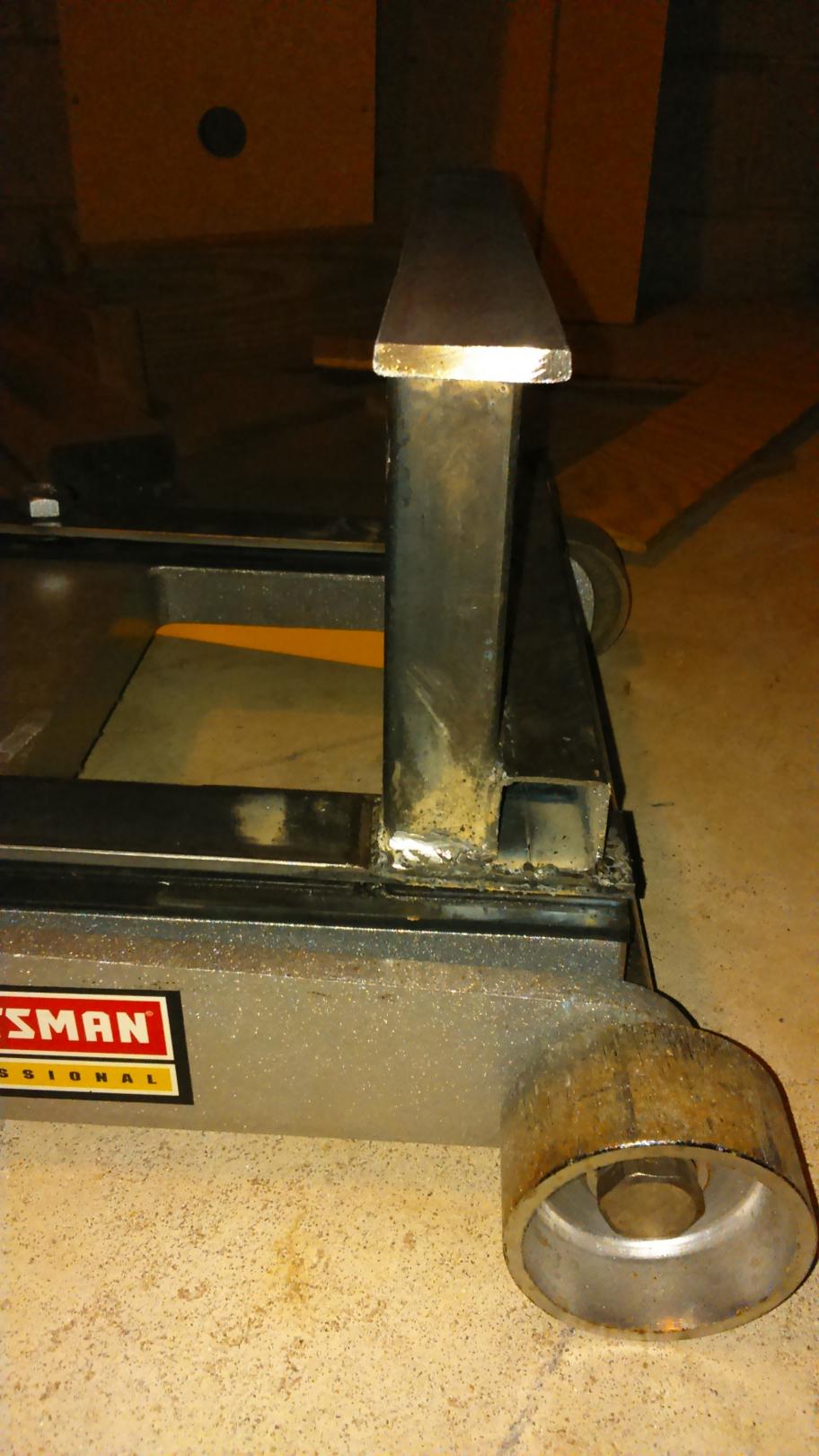

    How does this look?
    As far as the spatter and smoke go, pretty much normal. The bead looks like it needs more voltage and wire speed possibly.
    Flux core really isn't for thin metal. It's not delicate enough and will burn through before MIG. 20cfh is not enough for the average hobbbyists. That's less than an hour worth of use. For me I wouldn't consider anything less than 125.
