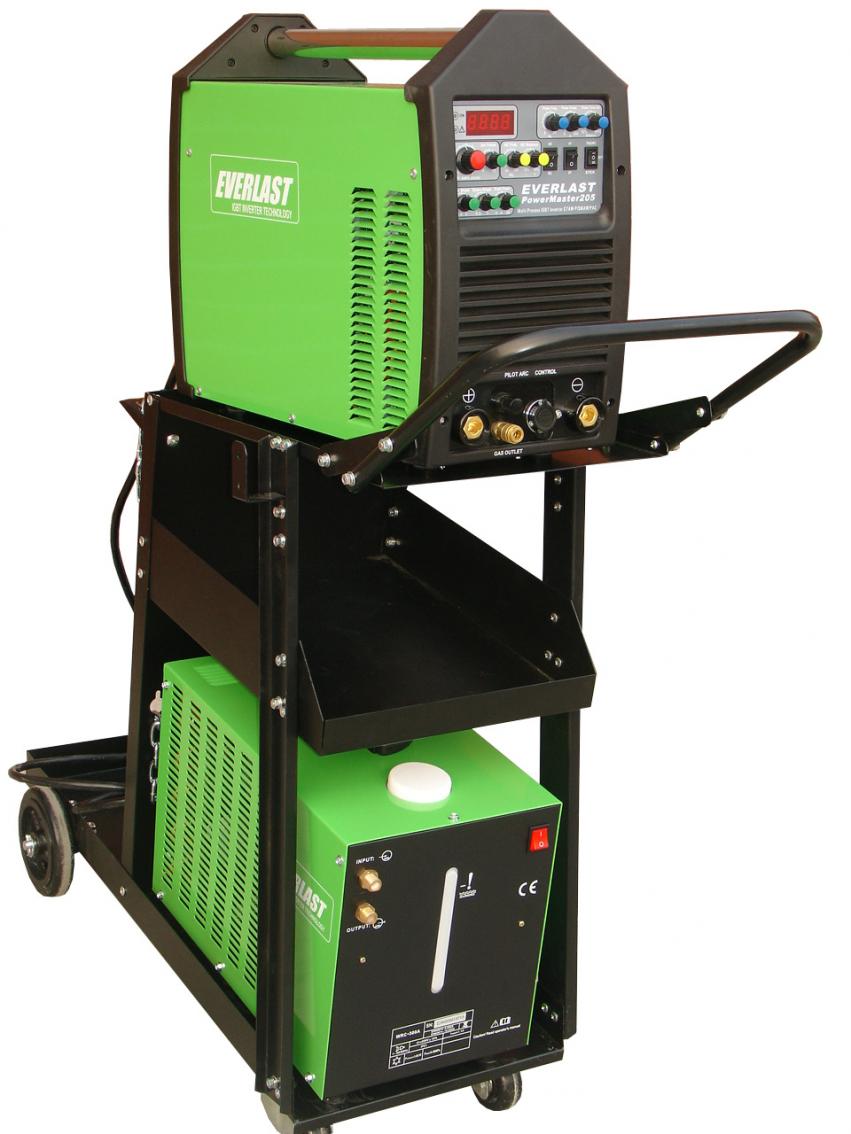

    What's the physical dimensions of the 300 amp water cooler - PowerCool W300? I need to make a cart and ensure it will fit on the lower shelf.

    I second that question. I thought I saw dimensions somewhere on the web site, but I sure can't find them now. I'd like to know if the water cooler would fit on the cart I'm using for my 250EX.

    I was the official "holder" of all the units dimensions until I had a computer crash. It wiped the charts all out. So, I apologize. Right now I don't have a cooler in my possession but maybe one of the guys can respond. I do have a picture of it in relation to the size of the PowerTig/PPro series cabinet, so you can see something from that. Hope this helps.

    Mark,
    It think if you measure the bottom shelf on the cart (LxWxH), that will get him in the ballpark as it looks like a good fit in the picture.
    Is it the same case the IMIG205 is in? Looks a bit smaller.
    300 cooler for 250ex. 10.5"wide x 14.5" tall x 20" deep. The "deep" includes 2" for the fittings. The "tall" includes the fill cap and handle. I have the cooler, waiting for the cart. Hope this helps.

    Thanks everyone, especially dlong. The cooler is taller that I anticipated, I guessed at around 10 inches, good thing I asked, it would not have cleared my cart shelf.
