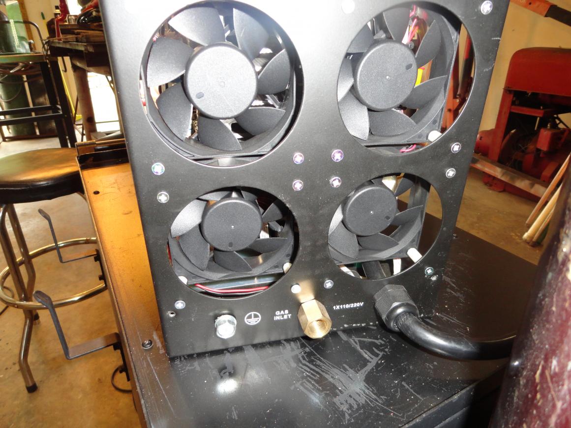

    ONE thing for guys that like a quieter welding experience, the new unit uses 4 fans...that's right 4 fans...Moves a lot more air, and from my sound measurements about 10-12 decibels quieter. I think you'll be able to hear it on some of the videos...or hear the lack of the fan noise.

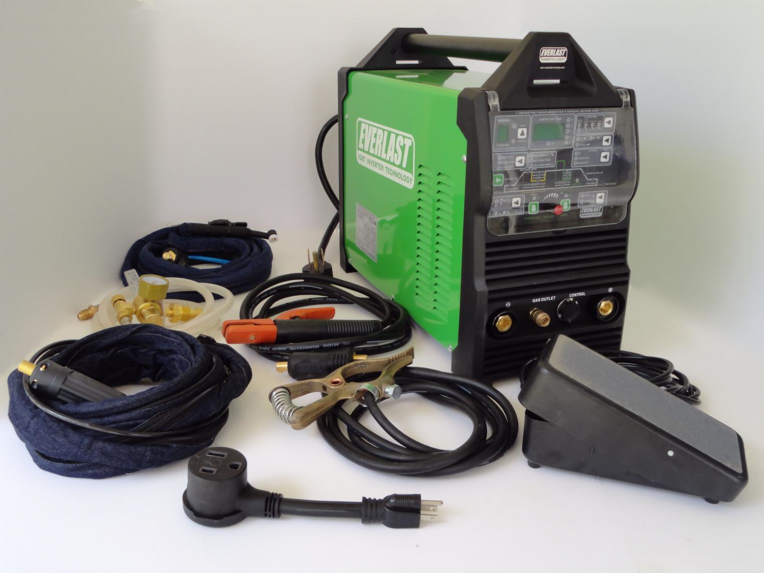

ID:	12398   Click image for larger version.
Name:	255EXT Group.jpg

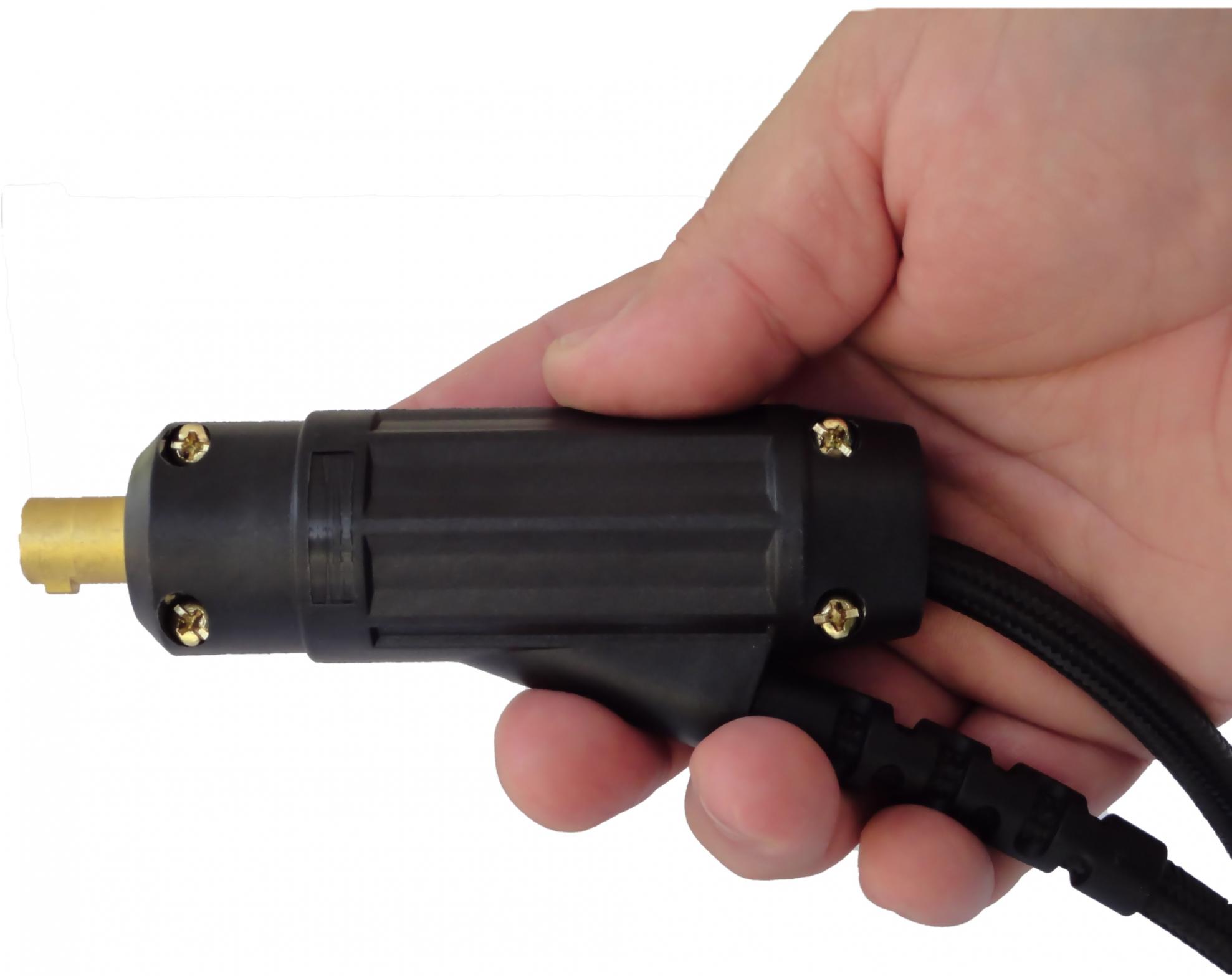

    Has anyone seen the new torch connector we are using along with the available "flex" cables?

    Very nice updates on the 255. New connector looks good. Any idea of how the gas outlet clocks when it's tight? Yeah, the video volume has been a bit all over the place. Always a big surprise when I forget how high I have the volume cranked up, and the next video comes on.
    Wow, Very nice machine, Well done. Nice accessories, too.
    I have one water-cooled 20F torch with that connector. In my 255 EXT, when snugged up, the water outlet ends up under the dinze, nearly vertically, almost a perfect alignment. Holding the connector with the water hose down, the dinze lug is facing up, 180 degrees opposite.
    With the dual voltage, and the new features, and the accessories, this is a formidable contender. I would get one again, they're just getting better.

    Nice work on the new features, guys. A 10-12dB noise reduction is impressive! It's apparent you've been attentively listening to your customers.
