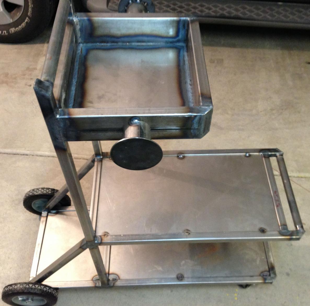

    For my first post I would share some photos of my first project using my new 250EX. So far I am loving this welder. Compared to my old Syncrowave 250 it feels like cheating.
    I have included both pre and post powder coating pics.
    The 110 volt outlet box on the back has a solid state relay inside that is triggered by the 220 volt output of the welder. That way I can have my Coolmate 3 (110 volt) come on when I switch on the welder. I thought this would be cheap insurance against forgetting to turn on the cooler and destroying a torch and cables. If anyone is interested in more details on the relay setup let me know.

    Very nice. Though out and nothing to fail there. And powder coat. Man... What are your plans for the next project or what do you plan to use the 250EX for. Great machine BTW.
    Thanks for the positive comments. I spent quite a while deciding what I needed/wanted and even more time cutting and welding. It was great practice and I am really happy with the way it turned out. I learned a lot about how much everything "moves" when you go from tack welding to finishing the beads. Keeping it all square was a challenge. The powder coating shop I used did a great job. I will be using them again.
    I don't really have the next big project planned yet. I have a background in machining and normally just cut everything out of a billet. I wanted to expand my skills and teach myself how to TIG. So far it is going pretty well. The 250EX is working better than I had expected and the build quality (inside and out) exceeded my expectations.
