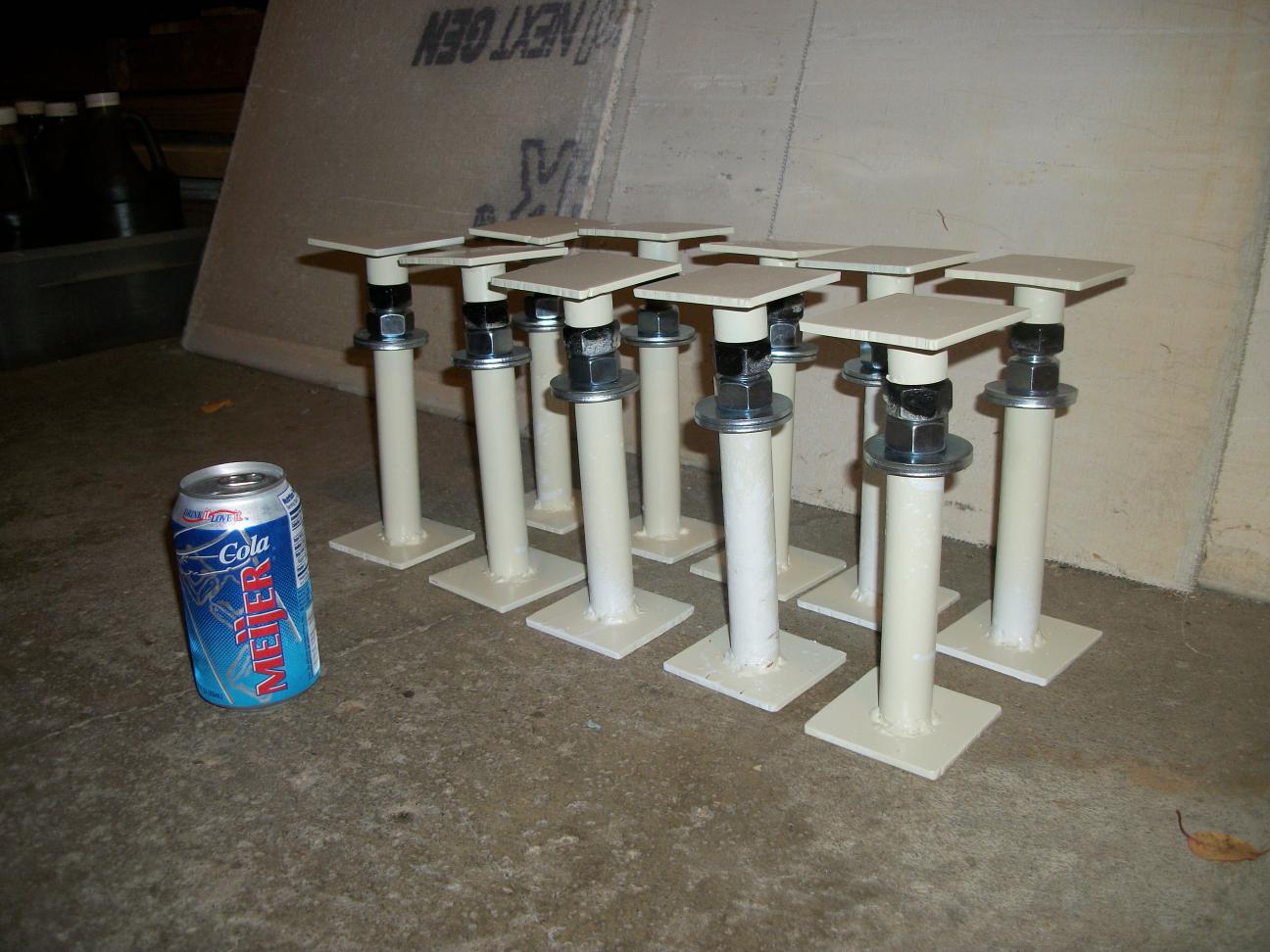

    Mini screw jacks of the same design. However, rather than utilizing 3" schedule 40 steel pipe and 1-1/4" threaded rod, the dimensions are 3/4" threaded rod and 3/4" black iron pipe.
    I have a wall section which has been settling and in need of motivating back into place.
    The jacks will be utilized in an exterior location so painting was necessary.
ID:	13501Click image for larger version.
    Aug 2014
    Westerville, Ohio
    72
    Mini screw jacks deployed.
    Indications of interior settling/sagging have already improved.
