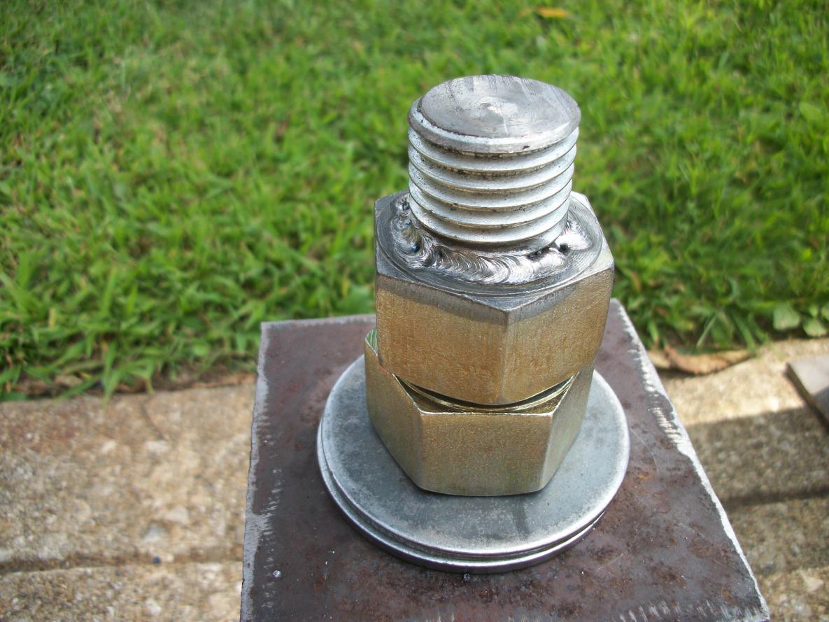

    Welded the top nuts to the threaded rod today. Also, added a wider base plate to the first few under-engineered examples. Nice to have this, "job to do the job" effort completed.
