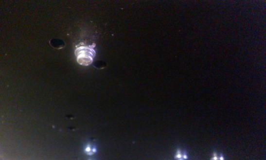

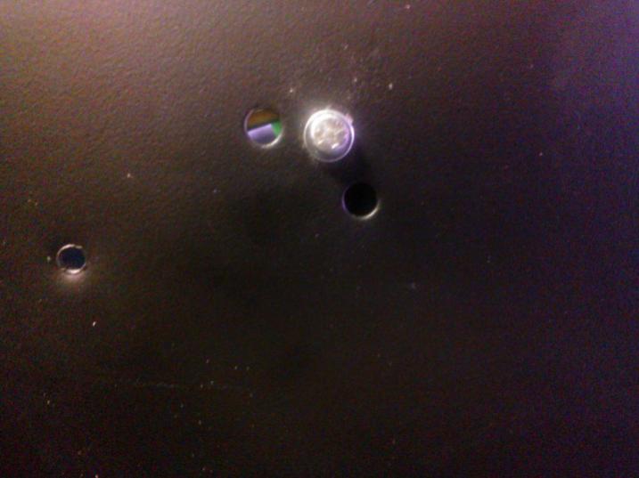

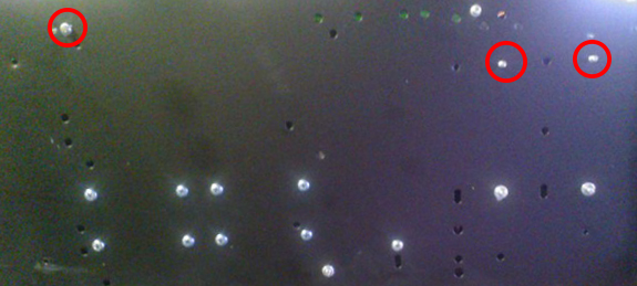

    Thanks Mark, I called when I got home from work and left a message. While I've been waiting, I flipped the machine on its side to see if I could notice anything wrong on the bottom of the machine. I did find something very interesting. There is a screw that is melted, so much so, that the grooves where a phillips screwdriver would fit into are actually melted so that a screw driver wouldn't be able to unscrew it. It's also not pulled tight against the case, there is space between the washers and the case. It also looks like there is some melted metal from the bottom of the case between the washers, almost like spatter. The first image below shows the bottom of the machine, the front of the machine is to the right. The screw circled in red on the top left. The other two red circles are of screws that don't have nuts on them. I noticed that there are two screws under those that do have nuts, not sure if they are all supposed to have nuts or not, just an observation. The second photo is a close up of the melted screw, kind of a sucky picture, sorry about that. And finally, the third photo is a side view of the same melted screw. You can kind of see how it's not screwed all the way in. I don't know what the screw is attached to but it does looks like something arced off of it.

    Can't really tell anything from those pics. If something had arced to a screw, you would usually see a lot of discoloration and the plating would be burned off. Unfortunately cheap Chinese screws often look like they are malformed. You will have to look inside to see what actually happened. With visible sparking, the results will not be subtle. You will most likely see black soot and burn marks. But it could be something simple like a wire that got nicked by a screw and can be re-positioned and re-insulated. Or it could be a damaged circuit board that will need to be replaced. You won't know until the cover is off.
